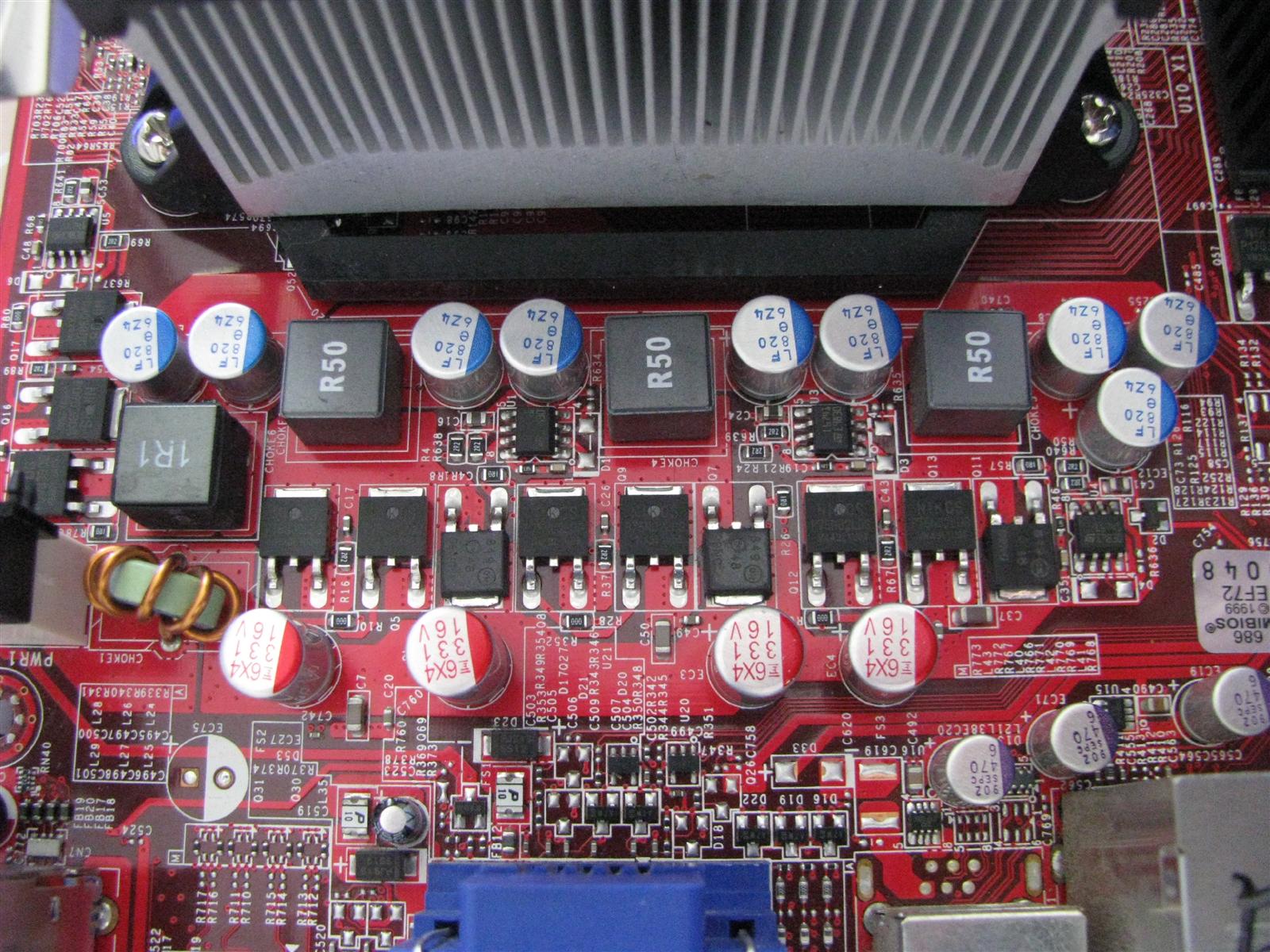

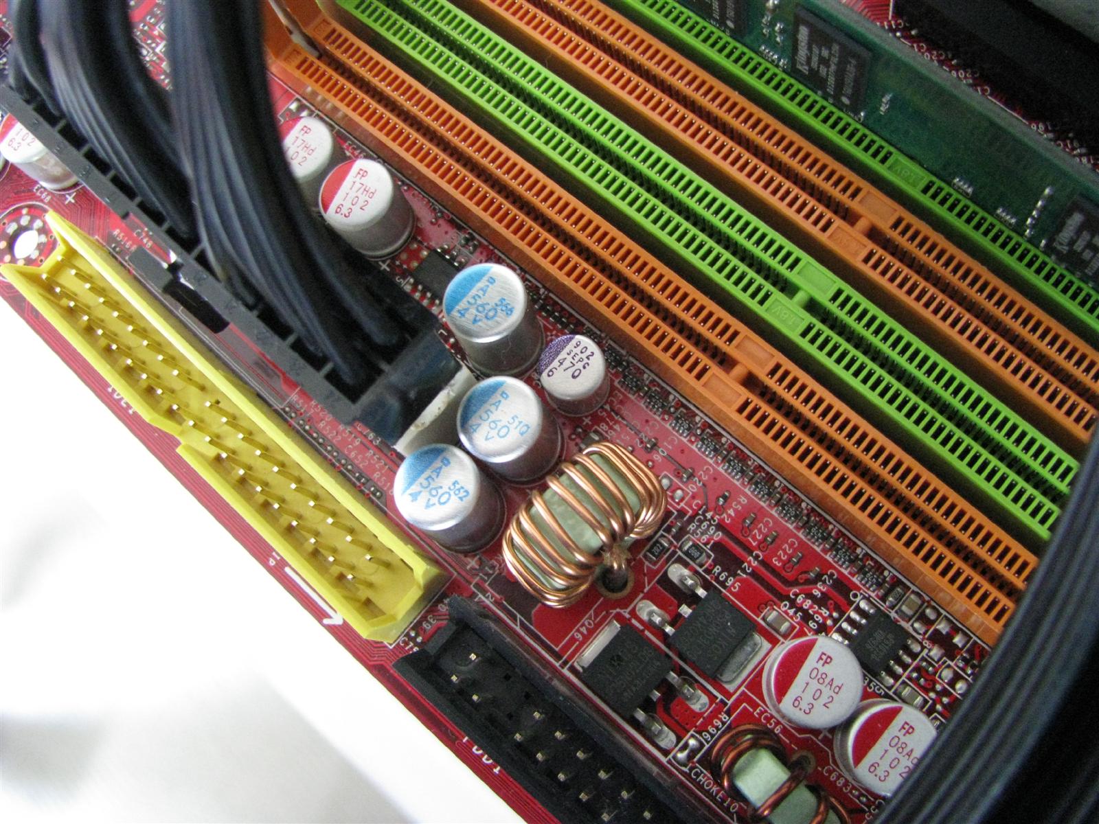

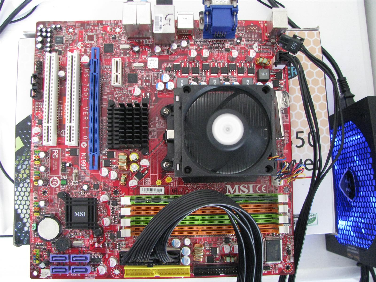

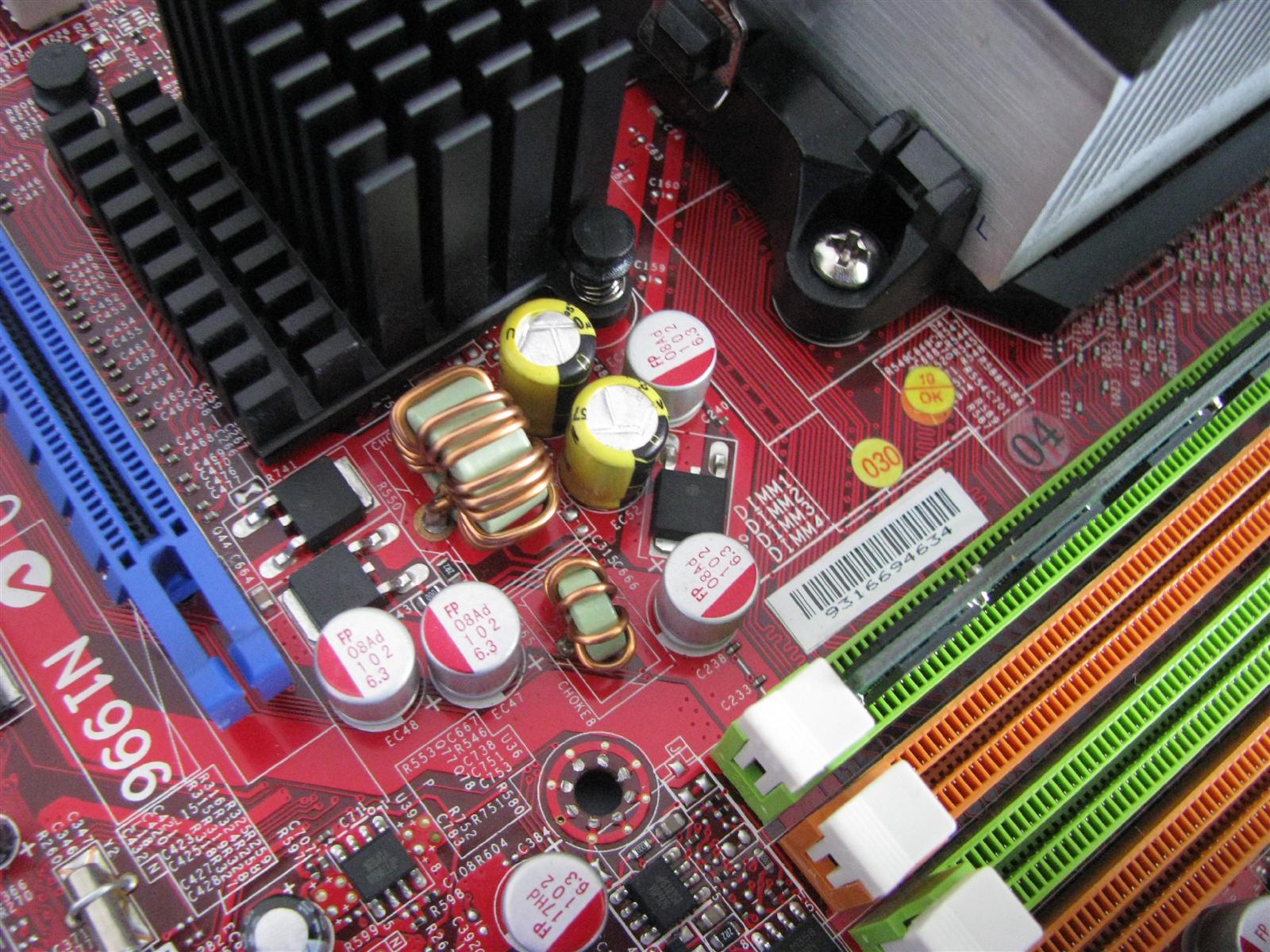

I got my hands on one of these boards. there's a similar one here (http://static.kupindoslike.com/MSI-K..._O_3013614.jpg). My one came with mostly TK Caps (with the exception of panny FLs on the VRM High side). None were bulged, but I thought it would be a fun experiment. Here's what I used
330uF 16V Fujitsu on the VRM High
820uF 2.5V Nich LF on the VRM Low
820uF 2.5V Fujitsu on the Chipset VRM
560uF 4V NCC PSA on the RAM VRM (note that there were only 2 1800uF caps there originally, with a blank spot for a 3rd one. I filled the blank spot up)
470uF 6.3V OS-CON SPEC on some of the USB filtering (others I left with NCC KY Lytics)
1000uF 6.3V Nichicon FPCAP L8 everywhere else
The board has been going in memtest now overnight, with no errors yet.
