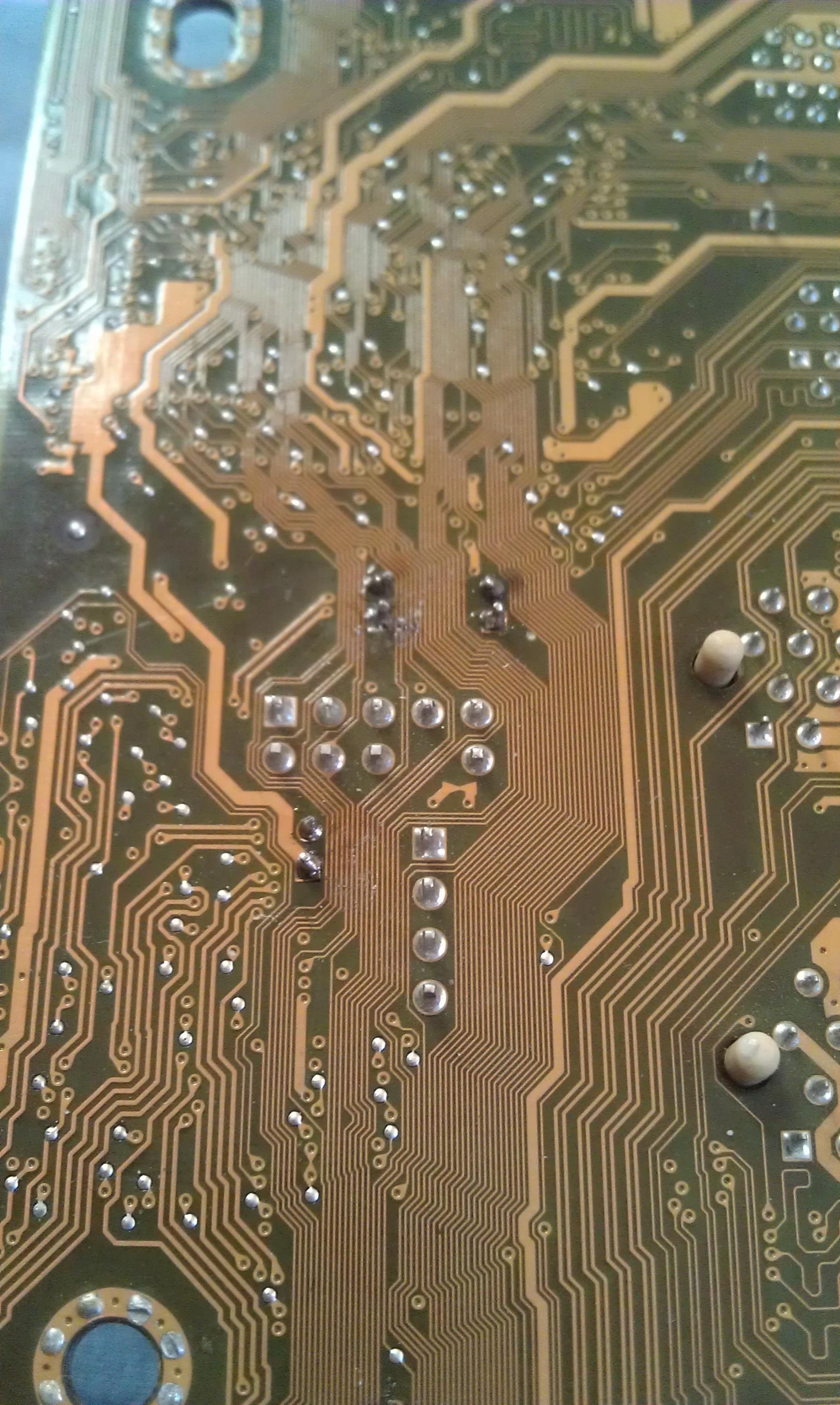

when trying to change out the smaller caps on this motherboard i lifted one of the traces from the board and i was woundering if there is a good way to fix and or if the bottom of the trace is conductive.

I think you will need to be more explicit -clean up the area of flux and splatter and mark which trace is lifted .
It has been recommended once or twice that you tape over the traces in the area you are working. (if you have more to do)
Just do a continuity test from the solder joint to wherever the trace goes.- if its the one I think looks like it goes through the board so you would have to find it on the other side. If you cant find it you can still test - just use a very thin sharp needle that will pierce through to the trace but not wreck it and check to that.Last edited by selldoor; 12-19-2012, 05:40 PM.Please upload pictures using attachment function when ask for help on the repair

you can see it in the first and last picture.My Computer.
