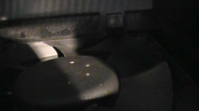

    I thought I would share these mods I have done to my Dell Optiplex GX620 to improve cooling.
    Pic 1: Shows stock 120mm delta fan, very nice and quiet.

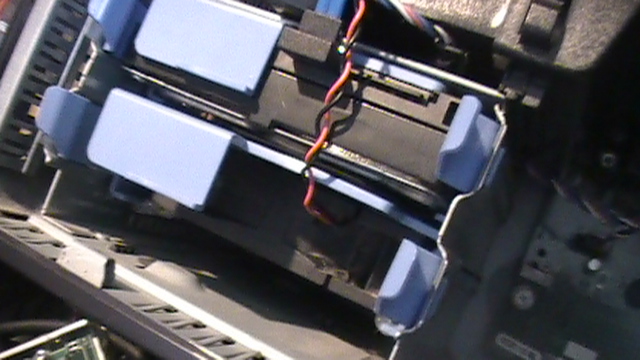

    Pic 2: Shows the Hard Drive Fan Mount (a 92mm da tech fan)

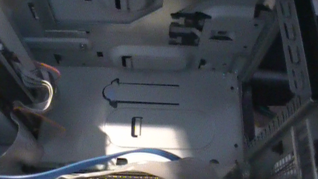

    Pic 3: Shows the Hard Drive Fan Mount installed in the bay below my 500Gb HDD.

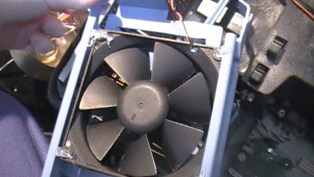

    Pic 4: Shows a fan shroud from a Dell Dimension 2300 redirecting all the hot air to the back of the case.

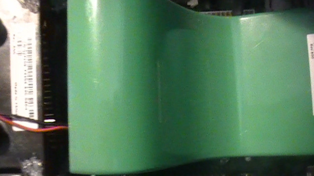

    Pic 5: I am awaiting the arrival of a new upgrade, aka an Hyper Micro $20 Unit AcBel 550Watt
