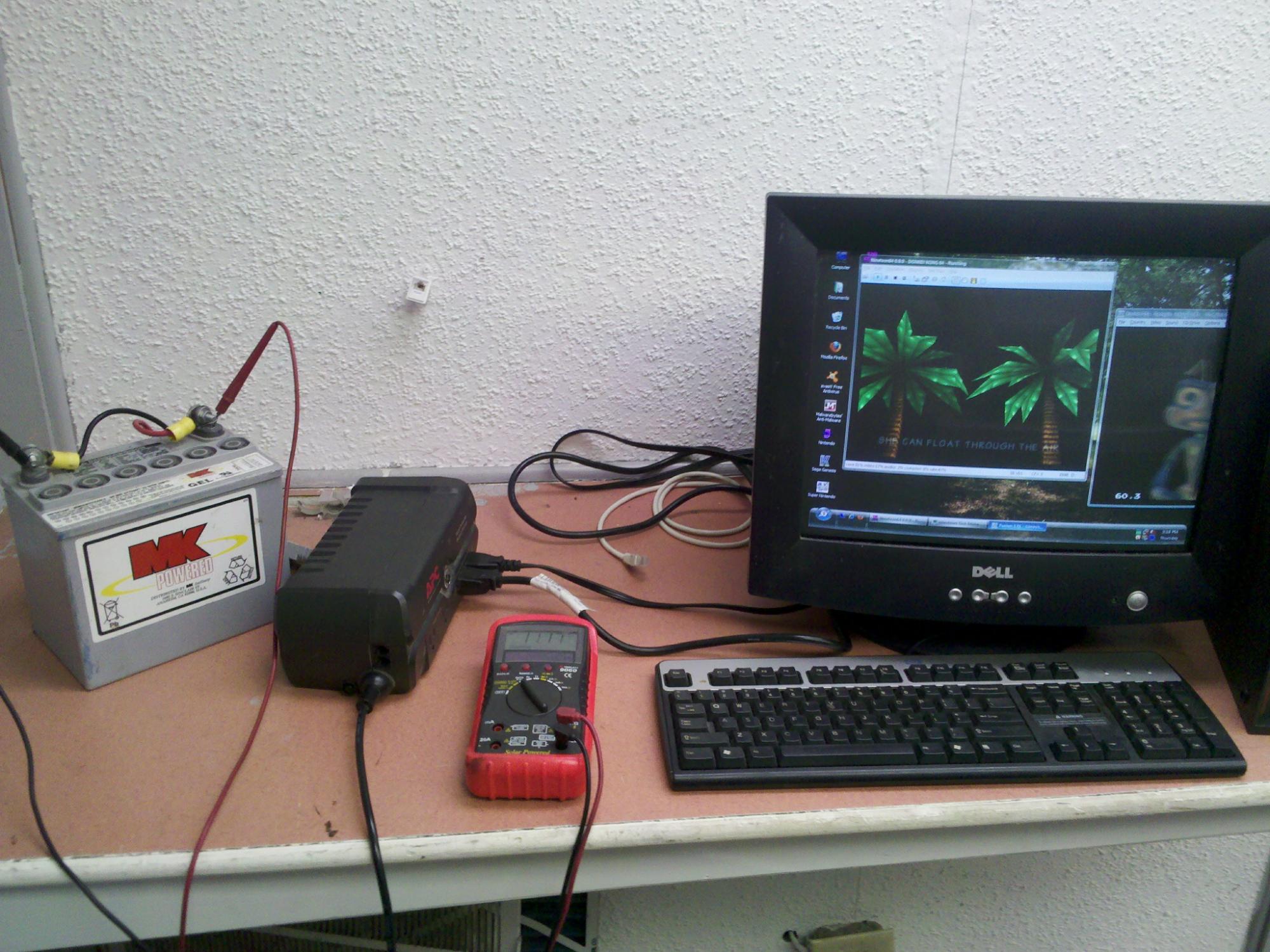

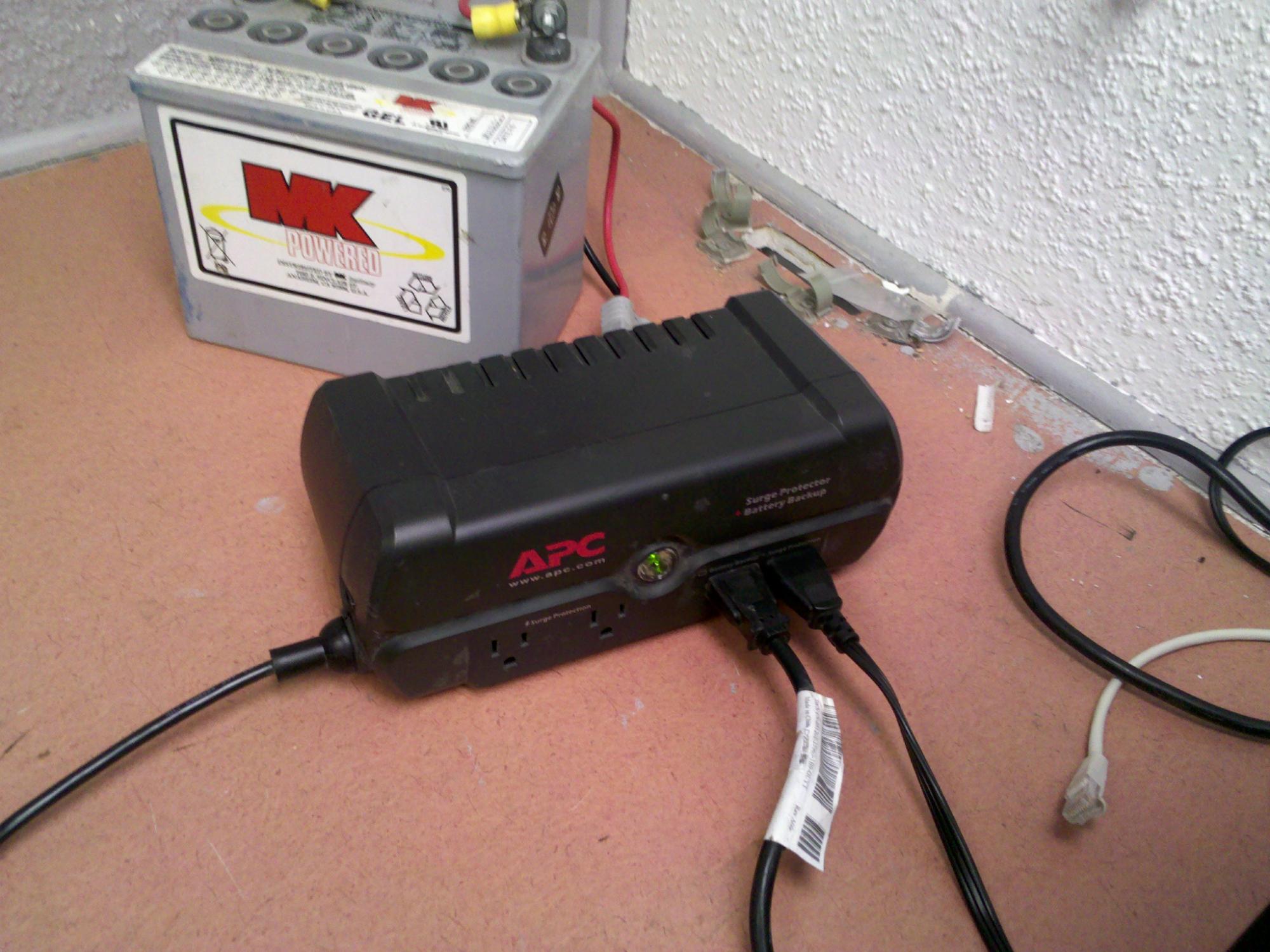

    apc be325.better than expected after external battery test.
    fully expected this thing to overheat or have a firmware timer.most of these newer units are disposable junk compared to the old bulletproof metal units.seems to be oem by cyberpower.
    last cyberpower unit i tried this with overheated in about 30 min at nearly full load.by the time i smelled the hot transformer it went bang and smoked grandly.stunk up the shop real good.

      Are those cell caps I see? Is that a flooded lead acid battery, Gel cell, or AGM?
      You'll probably need an external charging circuit for the larger battery the wimpy charger inside will probably give up if the battery is deeply discharged.
      That tiny unit shipped with a 12V 7-8 ah I take it?

                  update.the cheapie apc blew up under full load once the battery voltage dropped.the heatsinks are non existant and when the duty cycle came up the mosfets blew up.
                  otoh the smart ups 650 i built up for a neighbor ran 3 days non stop on a set of 4 8d truck batteries.storm took out a bank of transformers.my best power 850 ran 3 days too.mostly running the cable modem and router but also a desk fan and laptop.10 4d and 8d in paralell.my ncr 3kva ran the fridge every few hours and the main pc with its 37"plasma.5 4d in series.on the best power and apc i added a fan switched from the logic so it only runs when on battery.nice not to need a noisy generator!
