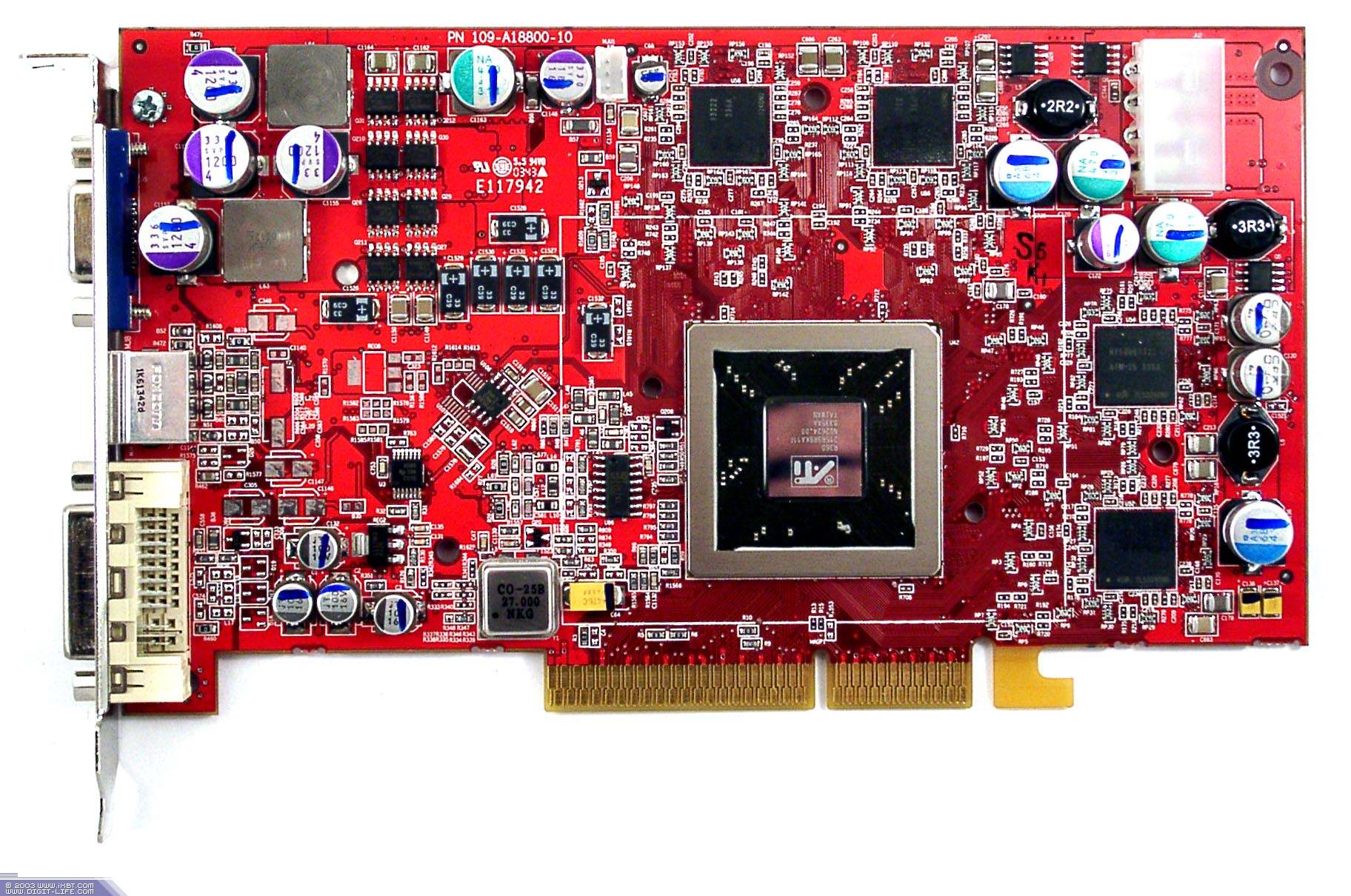

    Well, I used to buy broken mobos (no more than u$8) to fix and use myself. I wonder wot about VGA cards. For example there are lotta Gf4 Ti with bad caps, but I'm seeing a lotta of modern "middle-high end" agp cards broken. Most of them overclocked but I saw like 20 Radeon 9800pro giving artifacts all the time at stock speed, even underclocked. It is just an example.
    As u know, caps are of polymer on those boards, and they are not the problem. But , can they be fixed anyway ?
    Example : http://www.ixbt.com/video2/images/r9...scan-front.jpg
    The 2 mean mosfets are no-standart (above left corner), if they are shorted can be desoldering and solder 2 standart mosfets? like in this r9800p http://www.ixbt.com/video2/images/r9...scan-front.jpg
    I hear any kinda oppinion.

    Get datasheets for the original mosfets and look for suitable replacements on dead boards.
    A very common failure on VGA cards are bad solder joints, especially under BGA memory chips.

                  BGA = chip has solder balls on the bottom side. When put on the PCB and heated up, the balls melt and solder it to the PCB. The problem is that it sometimes does not solder properly - it works but when the PCB is bent, some solder joints under the chip break. If you get artifacts/completely broken image and pressing on the memory chips helps, then you know that this is the problem. I've seen this problem on mainboards too - it does not work at all but when I push the chipset hard enough, it works fine. But I don't have any tools to repair this. The BGA rework stations are very expensive. Heat gun might work (heat up the chip but be very careful not to move it) - but I haven't tried it as I don't have any.
