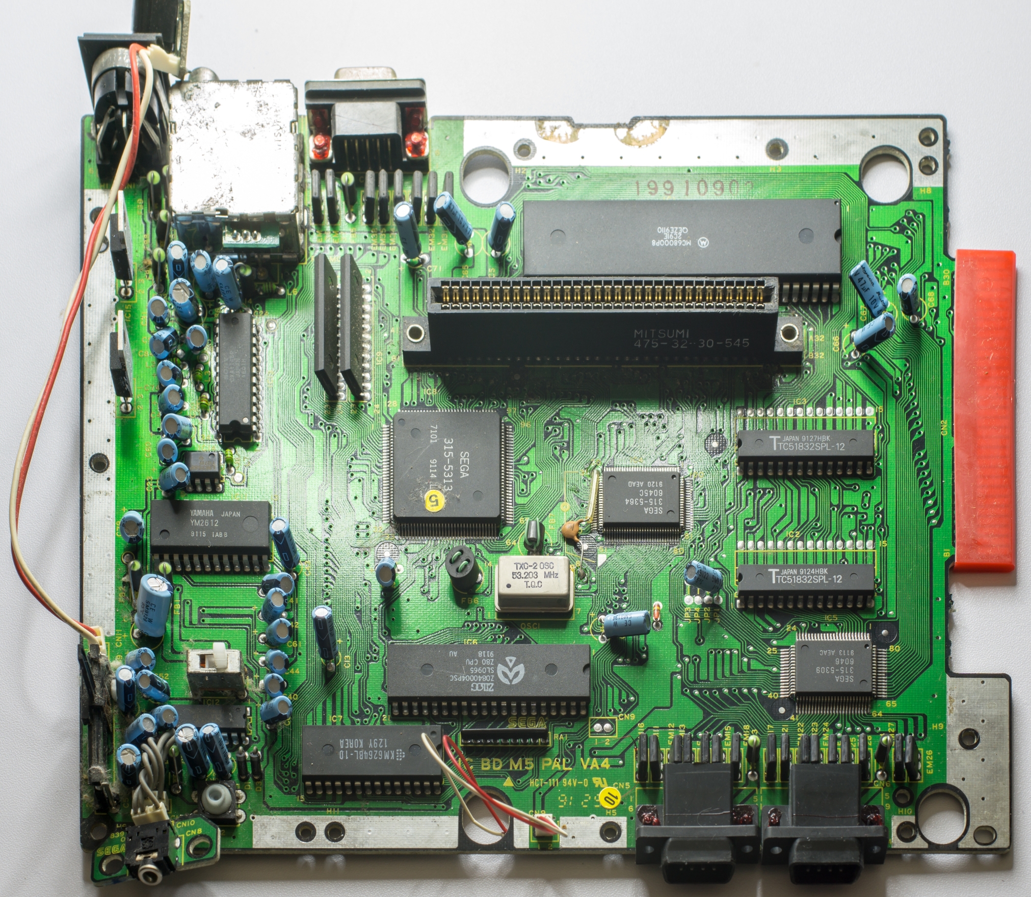

Old capacitor series with "CE" markings
  • Xan03
    • Jan 2021
    • 52
    • Europe
    Old capacitor series with "CE" markings
    Most that have opened some old consoles or other Japanese devices from the early 90s have probably seen these light blue Rubycon GP caps marked "CE W", like in this Mega Drive example:
    (image source: https://www.flickr.com/photos/130561288@N04/41362772945)
    Now from what I gathered the actual series name for these is TWSS, since I've not seen the spec sheet on this forum I've attached it for posterity sake, even though it's probably not hugely interesting. Amusingly there's still a ton of Aliexpress listings floating around for Rubyon CE W/TWSS, some of them have fairly sane looking date codes while others have seemingly total nonsense written on them. There's also some orange caps with that designation, for however real or not those may be.
    Anyway, did anyone that recapped those measured them to see how well they hold up? In the MD1 specifically a whole bunch of them are right next to two 7805s, at the video output circuitry, so I suppose a recap there might be in order sometime, especially as they are just 85°C rated units. I've noticed some very faint vertical dark lines towards the left side of the screen in my MD1 output, though not sure how much that could be capacitor related.
    In my N64 PSU, next to some 1997 Panasonic FCs, the bulk cap is a Panasonic "CE Y":
    Could that be just a different marking for NHG, going by the color? I wasn't able to find any reference to a Y-series in Panasonic's discontinued series list or elsewhere.
    What was the reason for manufacturers not putting proper series names on their caps in some cases?
  • PeteS in CA
    • Aug 2005
    • 3579
    • USA, Unsure of Planet
    Re: Old capacitor series with "CE" markings
    At 25-30 years old, those caps have probably been out of production for quite a while. But the 85C parts are just general purpose types, so just find a 105C general purpose series from a good company (Chemicon, Nichicon, Panasonic or Rubycon). Similarly, find a 105C 400V part from a good company that is similar in size (a modern part might be a bit smaller) and the proper lead spacing.
    PeteS in CA
    • DrewPhillips
      Capacitor Diarrhea - Nichicon PL Series
      by DrewPhillips
      Hello All, I have on the bench a couple of PSU's which have some failed Nichicon PL series caps. They didn't "puke" their guts through the top, but instead "diarrhea'ed" corrosive brown electrolyte through the bottom, down the legs and onto the board. On one cap, the electrolyte rotted the cap right off the board leaving 2 little stubs, and also corroded a trace on the foil side.
      The PSU's are Power-One MAP series and are ringing-choke topology. The semiconductors have date codes in 1993. The PSU's were used in a commercial application, fan-cooled. They had failed...
      03-02-2025, 10:18 PM
      ASUS Pro Series D310MT-0G32500650 Pro Series G3250 Specification for Upgrade or Repair
      This specification for the ASUS Pro Series D310MT-0G32500650 can be useful for upgrading or repairing a desktop PC that is not working. As a community we are working through our specifications to add valuable data like the Pro Series D310MT-0G32500650 boardview and Pro Series D310MT-0G32500650 schematic. Our users have donated over 1 million documents which are being added to the site. This page will be updated soon with additional information. Alternatively you can request additional help from our users directly on the relevant badcaps forum. Please note that we offer no warranties that any specification,...
      09-12-2024, 03:28 PM
      ASUS Pro Series D320SF-I564000134 Pro Series i5-6400 Specification for Upgrade or Repair
      This specification for the ASUS Pro Series D320SF-I564000134 can be useful for upgrading or repairing a desktop PC that is not working. As a community we are working through our specifications to add valuable data like the Pro Series D320SF-I564000134 boardview and Pro Series D320SF-I564000134 schematic. Our users have donated over 1 million documents which are being added to the site. This page will be updated soon with additional information. Alternatively you can request additional help from our users directly on the relevant badcaps forum. Please note that we offer no warranties that any specification,...
      09-12-2024, 03:28 PM
      ASUS Pro Series D320MT-I564000234 Pro Series i5-6400 Specification for Upgrade or Repair
      This specification for the ASUS Pro Series D320MT-I564000234 can be useful for upgrading or repairing a desktop PC that is not working. As a community we are working through our specifications to add valuable data like the Pro Series D320MT-I564000234 boardview and Pro Series D320MT-I564000234 schematic. Our users have donated over 1 million documents which are being added to the site. This page will be updated soon with additional information. Alternatively you can request additional help from our users directly on the relevant badcaps forum. Please note that we offer no warranties that any specification,...
      09-12-2024, 03:28 PM
      ASUS Pro Series D320MT-I564001774 Pro Series i5-6400 Specification for Upgrade or Repair
      This specification for the ASUS Pro Series D320MT-I564001774 can be useful for upgrading or repairing a desktop PC that is not working. As a community we are working through our specifications to add valuable data like the Pro Series D320MT-I564001774 boardview and Pro Series D320MT-I564001774 schematic. Our users have donated over 1 million documents which are being added to the site. This page will be updated soon with additional information. Alternatively you can request additional help from our users directly on the relevant badcaps forum. Please note that we offer no warranties that any specification,...
      09-12-2024, 03:28 PM
