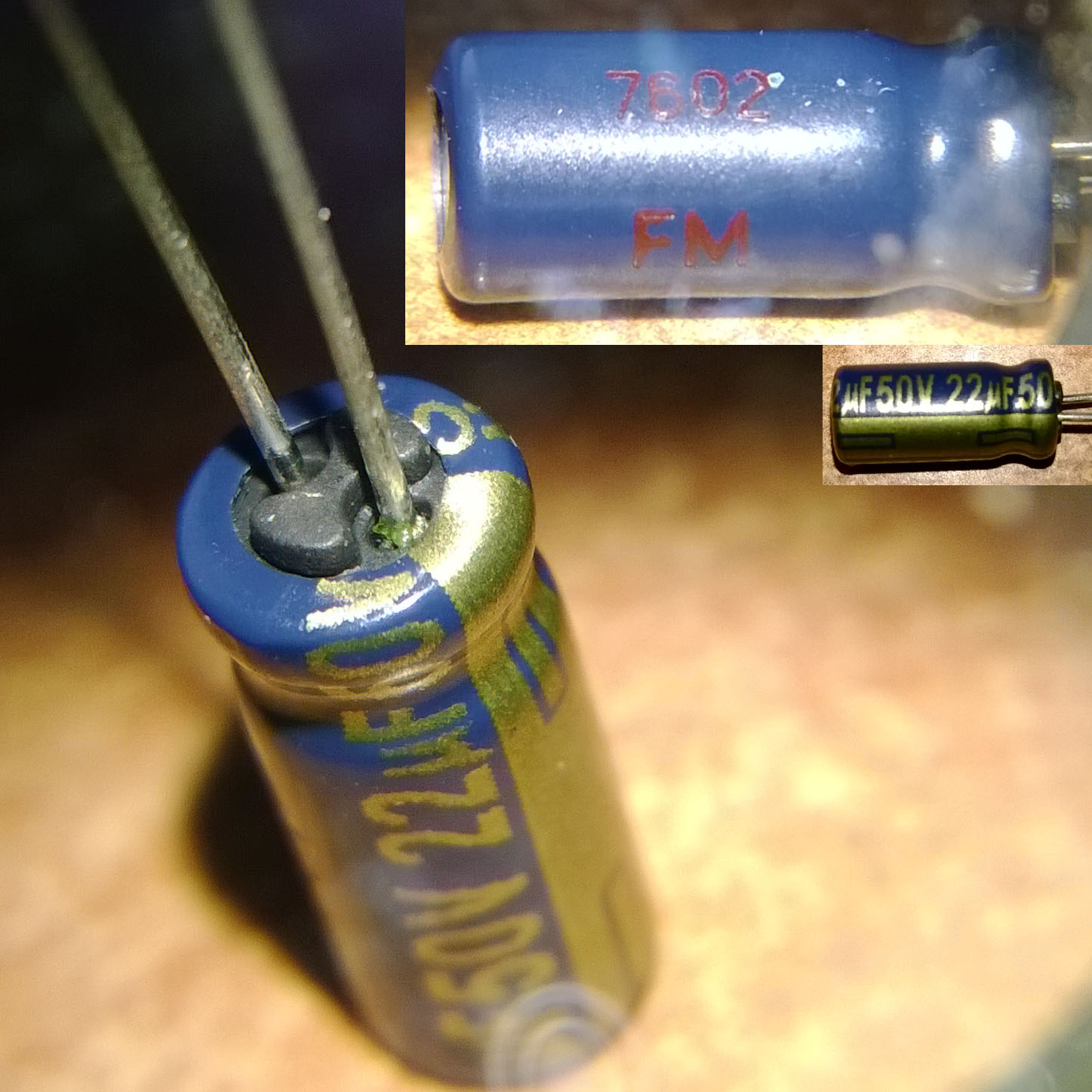

    Bought in 2020 and 2022. I have many and most of them are like this.

      Re: Panasonic FC series - leaking? quality gone?
      And if you put them apart, clean the residue away with IPA and a brush and put them away for a long time. Does the corrosion/residue return?
      I've cleaned some Panny FC and 1 batch of small Nichicon FG (fine gold audio caps) with the same residue a long time ago, the residue or corrosion has not returned. It maybe a fabrication defect of some spilled electrolyte when they were made? The rest of my stack of caps is still clean.
        Responding to the OP directly,
        Strangely I have had bad luck with Panasonic parts bought from Digikey.
        I don't know why this is.
        I've never had a problem with a Panasonic part bought elsewhere.
        I still use Panasonic caps from Mouser fairly often, and I never had a problem.
        I would think if it was a Panasonic problem, it would affect other distributors too, because I bought a lot of different parts made in different times and places.
          Mine, Panny FC's & Nichicon FG came also from Digikey (ordered only once from them), normally I get parts from Mouser and official EU suppliers.
