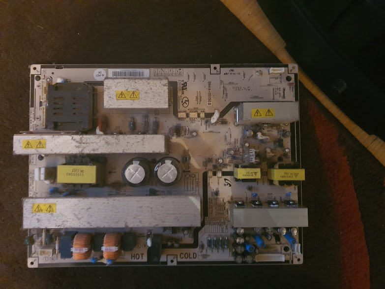

    Hi.

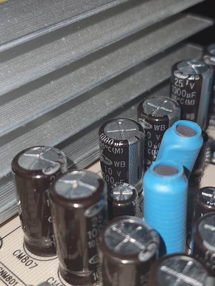

    Have the dreaded clicking TV on power on, but it will EVENTUALLY turn on and otherwise works ok.

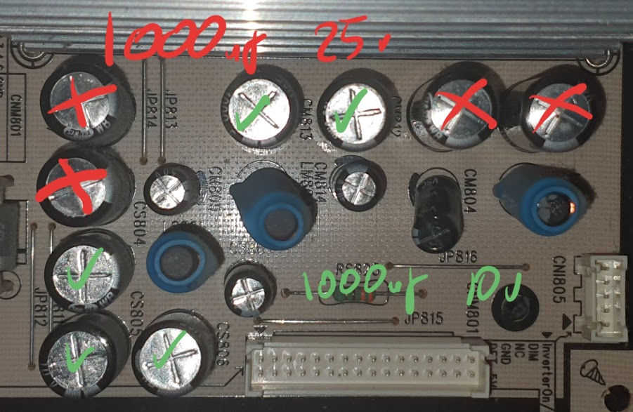

    I've already taken it all apart once, and the 4 1000uf 25v caps were obviously blown.
    We've already replaced these with 1000uf, 25v, 105°C - unknown brand, it's what my Brother-In-Law had in his kit.
    Having looked online it seems that the repair kits for this revision contain 9 caps, the 4x 25v that I've already replaced, plus 5x 10v that "looked" ok.
    I'm planning on getting decent Japanese caps and replacing the lot, but I do have 1 question...
    Should I up the v rating?
    Should I put 16v or 25v in place of the 10v? And 35v or 50v in place of the 25v?

      If the tv turns on and works, the eeprom is ok. if the eeprom was bad or the data corrupt the tv would usually not turn on at all.
      I would use 16v to replace the 10v as long as the diameter will fit. and you could also go with 35v to replace the 25v caps, likely once replaced they will out last the life of the tv.

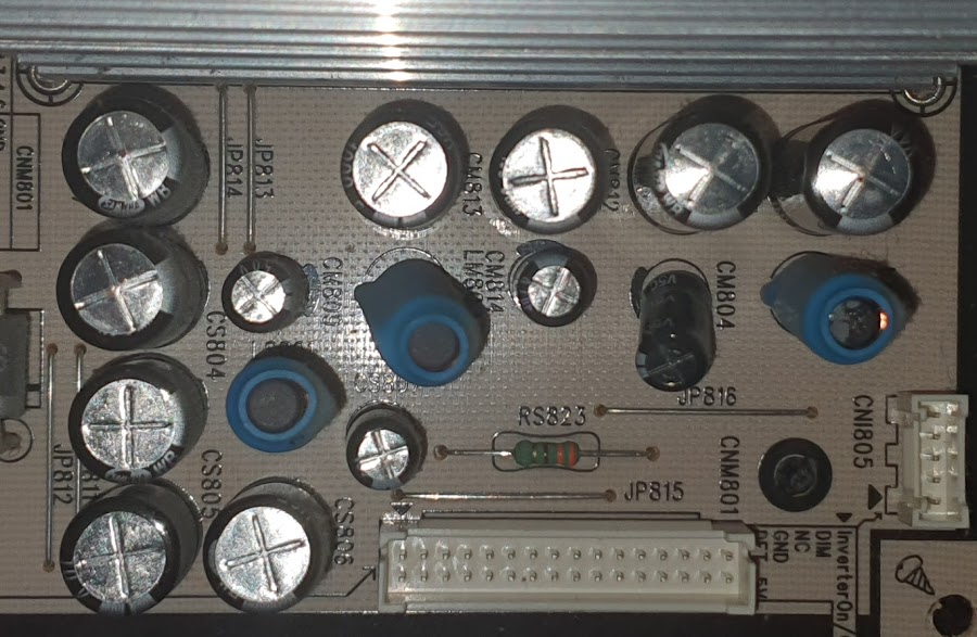

          HELP!
          Right, so when I turned up, I was told that the screen had now give black, but there was still audio.
          I proceeded anyway.
          I've replaced all 9 caps with the above Panasonic's.
          Got it all back together and it's still clicking - took 15 minutes to turn on in total.
          BUT - They have at least got the picture back!
          Could it just be a poor joint?
          Or could it be something else?
          • Hitto
            • Apr 2019
            • 95
            • Italy
            Re: Samsung LE52M86BD 52" faulty BN44-00150B PSU
            Have you replaced the small capacitors? They are as important as the 1000uF ones.
