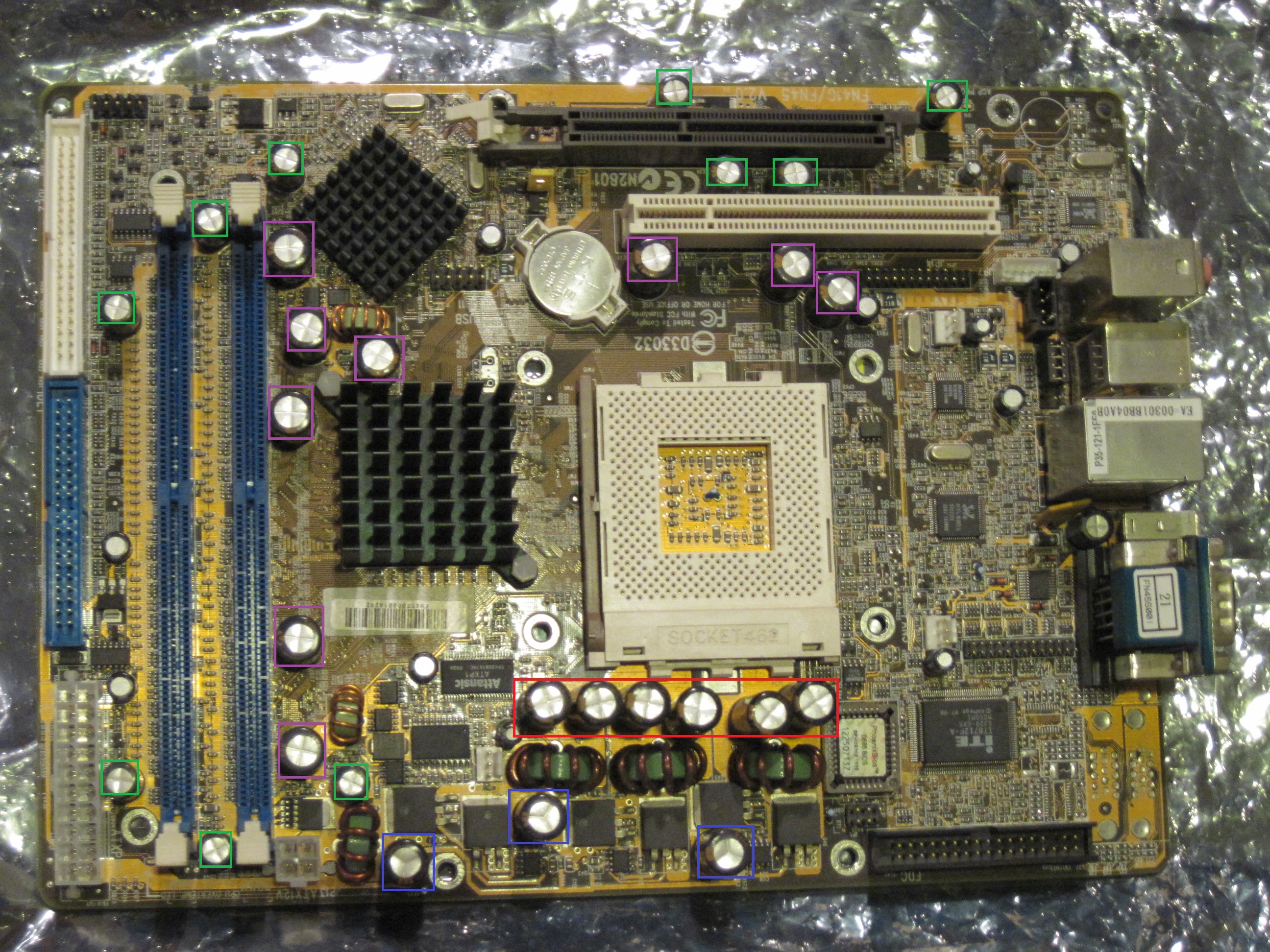

Poly modding an old Shuttle, question about non-VRM caps.
  • Rawrl
    • Mar 2018
    • 6
    I've recently acquired a Shuttle XPC SN45G. Being an old Shuttle, it's littered with several types of OST capacitors, which would be 15 years old now and due for replacement even if they weren't complete garbage. Fortunately, it still POSTS, so hopefully I got to it in time.
    I've seen these rightly referred to as cap bakers, so I figure why put electrolytics into such a harsh environment? May as well poly mod it.
    I've mostly gotten the CPU VRM figured out, thanks to here and here, although suggestions are welcome. What I'm stuck on are the other capacitors. Most of the polymer caps that I'm finding have ESR values one or several orders of magnitude lower than the originals, especially for the RLPs. How safe is it to decrease the ESR for these, and how far can you go? The guy in this thread is replacing 1000uf 6.3v RLPs with Nichicon RL8s. Is that OK for my application ESR-wise?
    Also, on a related note, I'm going to order a Shuttle SilentX PC40 250w power supply to replace the weedy 200-watter the system came with, and I'll need to recap it (with electrolytics, naturally!). Has anyone done one of these, and do you still have your notes? It would be nice to order everything for the board and the PSU at the same time, not to mention not having to chase down replacements for whatever junk caps are in it. (Heck, if someone has a 300w PC50 lying around, I'd gladly take it off your hands!)
    Thanks!
    Red - 6 x OST RLS 3300uf 10v 10x25mm - Nichicon RR5 1500uf 2.5v
    Blue - 3 x OST RLX 1500uf 16v 10x20mm - Nichicon PLF 470uf 16v
    Purple - 9 x OST RLX 1500uf 10v 10x16mm
    Green - 10x OST RLP 1000uf 10v 8x13mm

      Re: Poly modding an old Shuttle, question about non-VRM caps.
      careful! this board may not take kindly to polymodding due to the coils in the cpu vrm. the vrm coils look like they have 6 or more turns which means the vrm uses a low switching frequency and this sort of vrm design prefers high capacitance over low esr.
      i recommend u recap using 10k hour electrolytic caps but if u insist on polymodding, u assume all responsibility and bear the cost of paying for the costly poly caps that unfortunately failed to work...
      if polymodding:
      OST RLS 3300uf 10v 10x25mm -> use chemicon npcap psg series (15k-20k hour cap series) 2200uF 16v 10x20mm like stj suggested. the nichicon rr5 series u linked is only a 2000 hour cap series.
      if that is not available, u can try panasonic oscon sepc 2700uF 2.5v 10x13mm; nichicon fpcap nu series 2700uF 2.5v 10x12.5mm; chemicon psc series 2700uF 2.5v 10x11.5mm. u have to keep the capacitance as close to the originals as possible and do not downrate due to the low switching frequency of the vrm.
      its okay to go lower on the voltage of the caps because this is for the cpu vrm output. the cpu core voltage for athlon xp cpus is typically 1.75v at most so 2.5v caps will have no issues there even if u overclock and overvolt the cpu to 2v or more.
      OST RLX 1500uf 16v 10x20mm -> this is for the cpu vrm input which takes 12v. use chemicon npcap psg series 1500uF 16v 10x16mm like stj suggested.
      if that is not available, u can try panasonic oscon sepf 1000uF 16v 10x13mm or nichicon fpcap ne series 1000uF 16v 10x12.5mm. u have to keep the capacitance as close to the originals as possible and do not downrate due to the low switching frequency of the vrm.
      OST RLX 1500uf 10v 10x16mm -> these are for general filtering of the minor rails and wont see more than 5v. use chemicon npcap psg series 1500uF 16v 10x16mm like stj suggested.
      if that is not available, u can try panasonic oscon sepc 1500uF 6.3v 10x13mm; nichicon fpcap nu series 1500uF 6.3v 10x12.5mm; chemicon psc series 1500uF 6.3v 10x11.5mm.
      its okay to go lower on the voltage as these caps wont see more than 5v. the stock caps are overrated to 10v because its a trick that manufacturers use to get junk caps to last longer i.e. higher voltage junk caps tend to last longer than lower voltage rated junk caps.
      OST RLP 1000uf 10v 8x13mm -> these are for general filtering of the minor rails again and wont see more than 5v. this one is tricky, due to height restrictions, u have to downrate and use chemicon npcap psg series 560uF 16v 8x11.5mm. any caps taller than 13mm may not fit and may cause an obstruction when u try to insert an agp or pci card. so for the four caps that are around the agp slot, use the above ones i mentioned. for the other 6 caps around the dimm slots, u can use chemicon npcap psg series 1000uF 16v 8x20mm.
      however, there is a cap that is next to the southbridge heatsink almost in line with the agp slot. if an agp card is inserted, that cap may collide with the video card. so kindly check the exact position of that cap if it may collide with a long agp card. if so, u have to use the shorter 560uF 16v 8x11.5mm cap there.
      if that is not available, u can try panasonic oscon sepc 1000uF 6.3v 8x7mm or nichicon fpcap nu series 1000uF 6.3v 8x11.5mm.
      if sticking to electrolytic caps:
      OST RLS 3300uf 10v 10x25mm -> use panasonic fr, rubycon zlh or chemicon kzm (these are 6k to 10k hour electrolytic cap series) 2700/3300uF 6.3v 10x20/25mm caps.
      OST RLX 1500uf 16v 10x20mm -> use panasonic fr, rubycon zlh or chemicon kzm 1500uF 16v 10x20mm caps.
      OST RLX 1500uf 10v 10x16mm -> use panasonic fr, rubycon zlh or chemicon kzm 1500uF 10v 10x16mm caps.
      OST RLP 1000uf 10v 8x13mm -> use panasonic fr, rubycon zlh or chemicon kzm 820/1000uF 6.3v 8x11.5mm caps.
        Thanks for the replies.
        I'm not married to the idea of poly modding it, I just figured they'd last longer. This is an Athlon XP, Nvidia chipset, and high-end video card (probably gonna go with a Radeon 9800 or X800) all crammed into a tiny box and cooled by a single 80mm fan. Polies are supposedly more heat tolerant, and I certainly don't want to have to do the same work twice.
        From what I was reading, 8-10 turns was the indicator for a low frequency VRM. If 6 is a better rule of thumb, I'll keep that in mind for the future.
        For the other caps on the board, I'm aware of the voltage substitutions some manufacturers do and why, I was more concerned with the impact of drastic changes in ESR. I know that failed (and thus presumably severely mismatched) caps in the minor VRMs can kill the northbridge and RAM on these, which was mainly why I hesitated. Similarly, most of the RLPs look like filters, as you say, but there are a couple in close proximity to regulators near the AGP slot (1.5v supply?), so the same concerns apply.
        It certainly would be easier to just throw a bag of Panny FRs at it...
          yes i understand your plight. it really is a crapshoot if it should be polymodded or not. but from the pics u posted, nearly all of the caps are in potential hotspots around the board. u have caps near the nb and sb heatsink, caps near the cpu socket and caps around the agp slot since u intend to use a hot high-end agp card in there. the radeon 9800 series of cards has a tdp of around 50w, almost as hot as a cpu and the x800 around 50-65w depending if its the pro or xt. there have been cases on here of bloated caps around the agp slot due to usage of a hot high-end agp card.
          there are only 4 caps on the left side of the picture around the dimm slots that arent considered in hotspots around the board. if that was the case, prolly just better to polymod the whole damn thing if most of the caps are in hotspots!
          well lately it has become a concern because of this thread where someone polymodded an Abit NF7-S 2.0 which is also an athlon xp board. the cpu vrm has around 5-6 turns on this board similar to yours and someone polymodded it and reported a loss of overclocking, about 100 mhz loss of stable overclocking. so it seems the decrease in capacitance or maybe the heavy decrease in esr contributed to some stability issues in the cpu vrm albeit it is a very tiny minor issue: 100 mhz loss of overclocking. however, no major problems like the board catastrophically failing, explosions, burning or "popping" were observed which is what u were worried about.
          so if u arent overclocking, just go for the polymod. personally, trying to overclock such a hot running system already would be suicidal, hardware wise...
                There isn't really any rule of thumb.
                Generally, the only low-frequency VRM switching motherboards to be aware of are those with TL494/DBL494/KA7500 chips driving the VRM - some of which existed up to the late s478/s462 era (and those were mainly "lower-tier" mobos like ECS and PCChips). But just about everything else wouldn't really care too much about a slight decrease in capacitance (up to 30% loss probably won't make a difference at all.)
                Yes, that would be the AGP power supply rail. That rail is almost always linear type, so it's a good idea to keep the capacitance closer to the original. Too low of an ESR generally shouldn't be an issue for it either... but in a marginal design, it could be (though, I've personally never seen any linear regs on mobos oscillate due to using polymers.)
                That should be fine, as Panasonic FR are quite tough. Will likely easily last at least 10 years in there without issue, if not 15. So I wouldn't sweat it about doing a complete poly recap. If heat really is an issue inside this case, it would probably be a better idea to invest time into adding more ventilation/holes in the case rather than messing with polymers. After all, those hot temperatures will probably impact the lifespan of the chipset too. Speaking of which, consider adding a small fan on the NB heatsink.
                It's likely the decrease in capacitance that caused it, because the lower the VRM switching frequency is, the bigger effect capacitance will have on ripple and noise suppression. This is why in linear circuits (like those simple oldschool iron-core line transformer "wall-warts" / adapters) you always need fairly big caps even for very small currents.
                Think of this as battery for your cell phone: you can either have a small battery (smaller capacity) power your cell phone or a large one (large capacity). The difference will be that with the small battery, you will have to charge it more frequently if you don't want your phone to lose power. With the smaller battery, the time it takes to charge the battery will also likely be shorter. Whereas with the bigger batt. you can charge it less frequently, but when you do, it will take longer too (given the same charger anyways). Now, as to where ESR comes into play... that's not something that can be illustrated easily in the above particular example.
                Anyways.
                A 100 MHz decrease in overclocking should NOT be a concern at all.
                    Thanks for the additional information, momaka.
                    I've been meaning to update this thread with my results. I finished the recap at the beginning of last week, but still wanted to finalize the build, and then I spent the weekend stress-testing it.
                    For the motherboard, I wanted to go full poly on it, but luckily common sense reasserted itself when I started pricing everything out, and I wound up doing polies on the VRM and FRs everywhere else.
                    Code:
                    OST RLS 3300uf 10v 10x25mm -> Chemicon PSG 2200uf 16v
                    OST RLX 1500uf 16v 10x20mm -> Chemicon PSG 1500uf 16v
                    OST RLX 1500uf 10v 10x16mm -> Panasonic FR 1500uf 10v
                    OST RLP 1000uf 10v 8x13mm -> Panasonic FR 1000uf 6.3v*
                    For the PSU, I mostly went with Panasonics, except for the 25v 100uf caps, where I used Nichicon UHE. I ordered replacements for all three 100ufs, but the startup cap is trapped under a heatsink and boxed in by the daughterboard, so it's staying put unless it becomes a problem. Likewise I skipped the 10ufs, my understanding being that caps that small are seldom an issue.
                            Indeed.
                            While small caps like that do fail quite often (especially from Ltec), the circuits they are used in aren't usually very sensitive. Of course if those 10 uF caps were used on something important, like the startup cap or BJT bias/drive in H-bridge PSUs, you could be in for some trouble.
                            In your case here, though, I think those 10 uF caps are just general filters for the ICs on the daughterboard, so not that important really.
                            This is my first major recap, not counting a S370 board I did years ago, and I've gained a lot of confidence to do some of the other stuff I've been sitting on to "someday, eventually" recap.
                            Thank you all so much for your help with this.
                            Yup, once you get started, it's much easier to continue.
                            You're welcome!

                              Originally posted by momaka
                              perhaps take the bag with the 100 uF cap and tape it to the side of the PSU with a note inside. That way, you will have the part right then and there instead of wondering where you might have placed it or what could be wrong with the PSU.
                              lol thats like a psu spare part time capsule idea. i think that idea's excellent lol!
                                master hoarder
                                • May 2008
                                • 12175
                                • Bulgaria
                                ^ It was actually quite a common practice on some old appliances. For example, last year I decided to "deep clean" our gas stove/oven and removed a panel on the bottom to clean under it. Then I saw this metal tab with four nozzle-like things and a label hanging by them. Checked the label and it said these were indeed gas nozzles - just spare ones in case the original ones wear out / clog.... which is funny, because this oven/stove is about 25 years old and has never been serviced or needed servicing. I suppose if they were to clog today, I can change them and expect another 25 years of life out of it? I guess they don't make them like that anymore.
