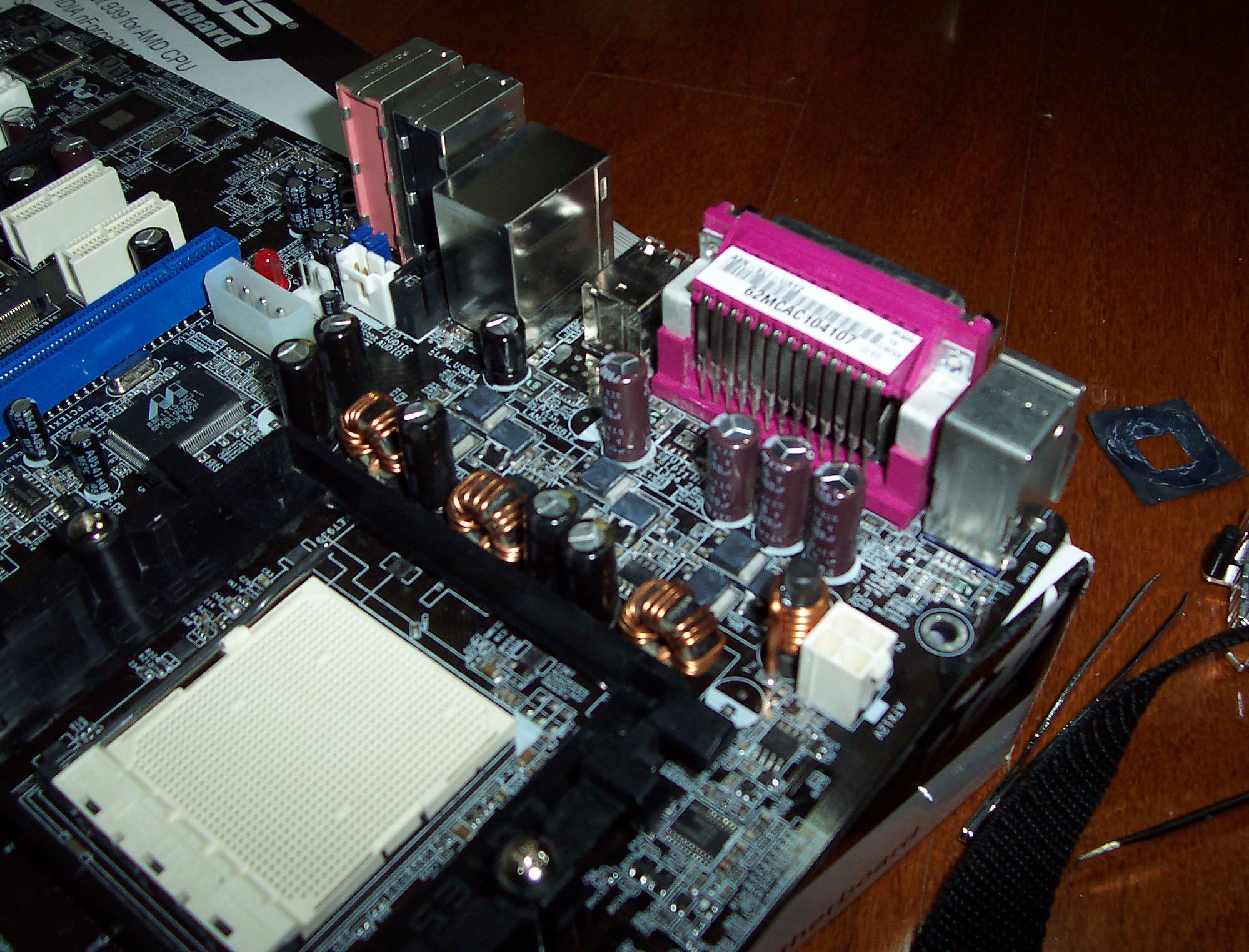

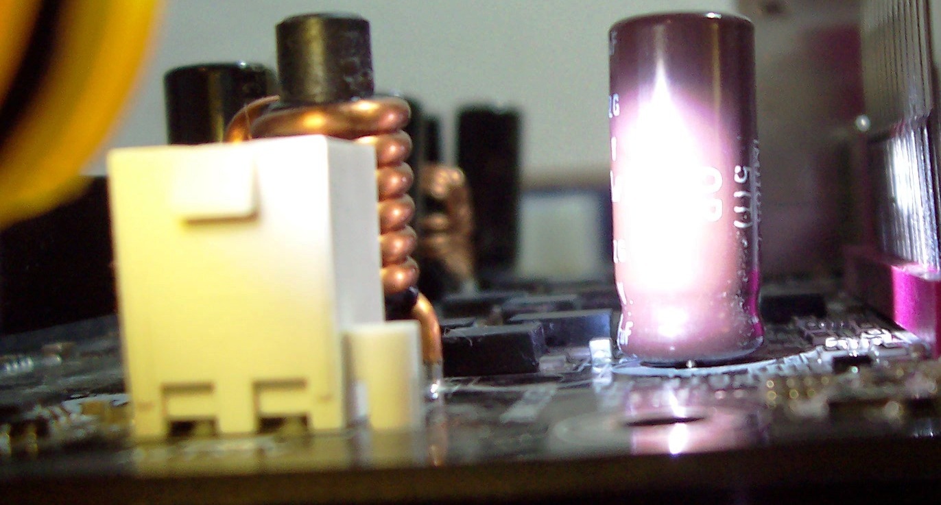

    OK, you guys called me out. I can get a decent pic, but it took around 50 shots....very tough.
    Anyways, the caps in question (4x):
    KZG 16v 1000uF
    This is from an ASUS A8N SLI mobo, although on my current recapped MSI K8N Neo4 MOBO (see my first recap click here ), I have nearly the same issue (caps r 4x of KZG 16v 1500uF). Perhaps in my last post, the bung has dropped maybe 0.5mm, not 1.5mm as i previously stated.
    1,2) Is this a characteristic of the KZG series? Maybe they are meant to do this?

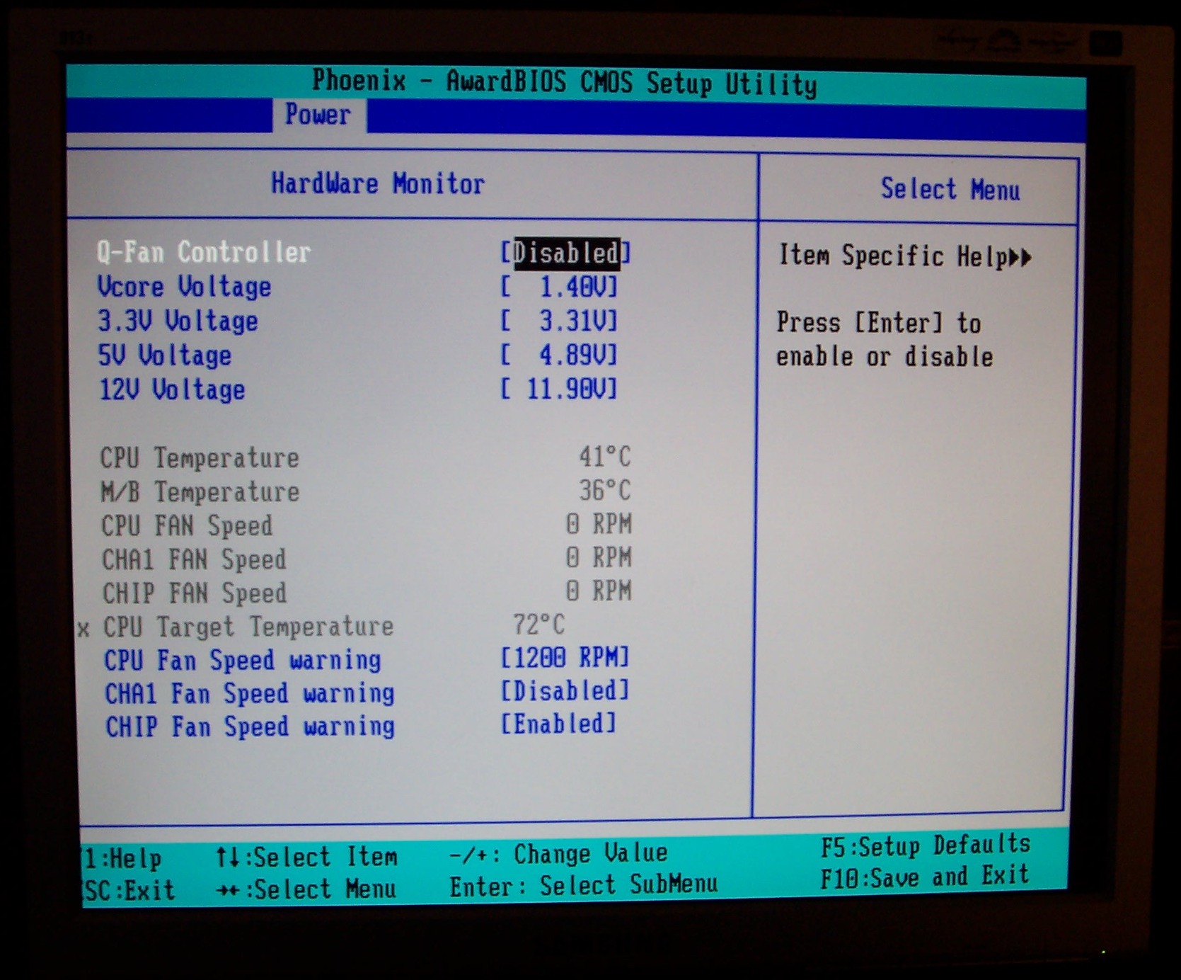

    On my current board the post voltages are a-ok too, and i measured the capacitors at 6100 uf (4x in circuit) using calibrated cap meter.
    3) Are u sure these need to be replaced?

    Last Qs:
    From the post voltages displayed, what can you tell about this board in terms of predicting its longevity/health? Only the reported CPU voltage fluctuated from 1.40 to 1.42, no others varied over time. Is this typical and nothing to worry about?

      I posted a "continued here" note in that thread. You would've been better staying in that thread. It's confusing to have multiple threads on the same question.
      That bung is correct and normal. The cap is sitting on its "feet".

      Originally posted by PCBONEZ
      If the cans are pushing off you should replace them AND check the power supply.
      If these are KZG or KZJ and suspect then just replace them.
      Those Chemicon series -sometimes- have problems. [Usually heat issues.]

                Can pushing off, bung pushing out,,,,, same-same.
                https://www.badcaps.net/forum/attach...tachmentid=405
                http://bambooz.pytalhost.net/badcaps...TUR_busted.jpg
                They don't always bloat but:
                https://www.badcaps.net/forum/attach...achmentid=5113
                I replace KZG on any board I'll be responsible to fix if it breaks.
