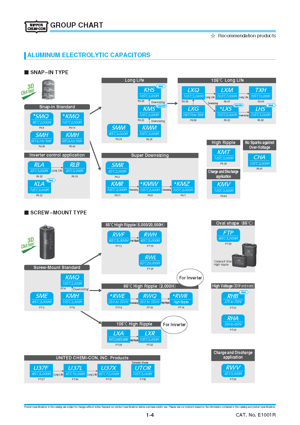

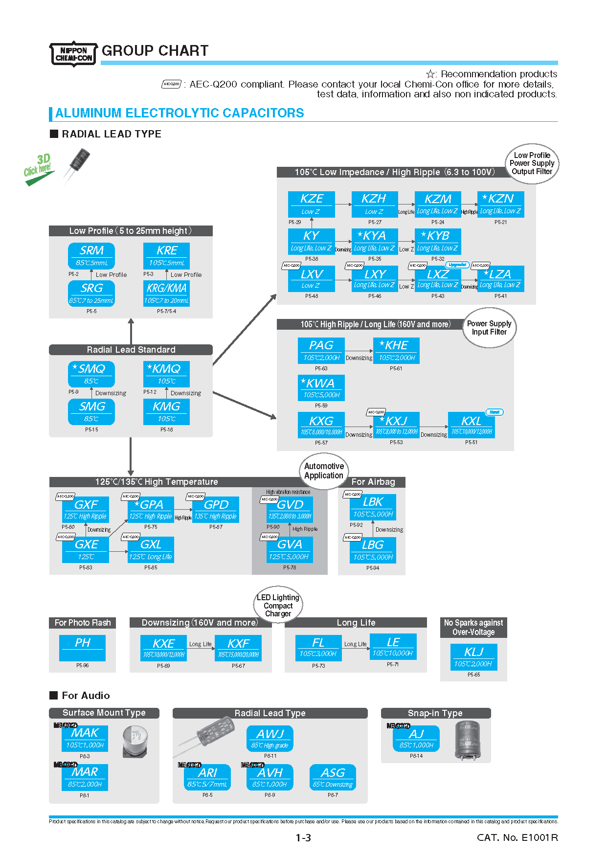

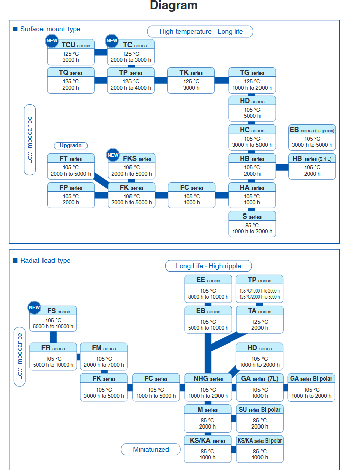

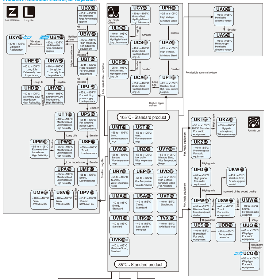

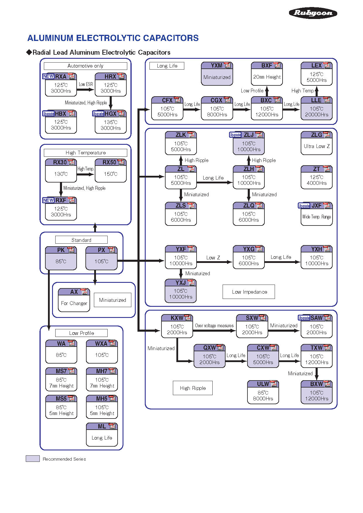

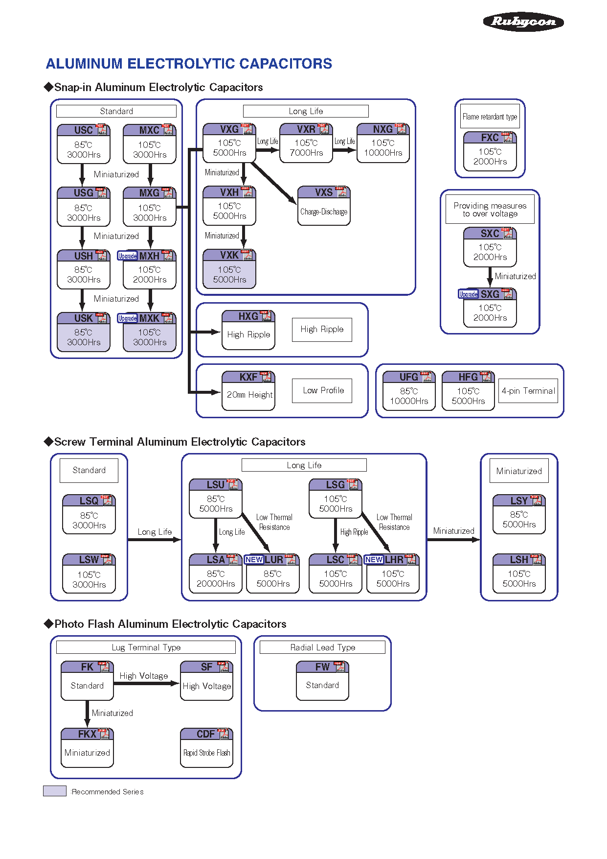

                  Lower impedance is pretty much Lower ESR
                  Search for "[manufacturer] capacitor chart" in Google
                  Ex
                  Panasonic :
                  Rubycon :
                  Nichicon : http://nichicon-us.com/english/produ...ini/index.html (hit diagram search)
                  united chemi con :
