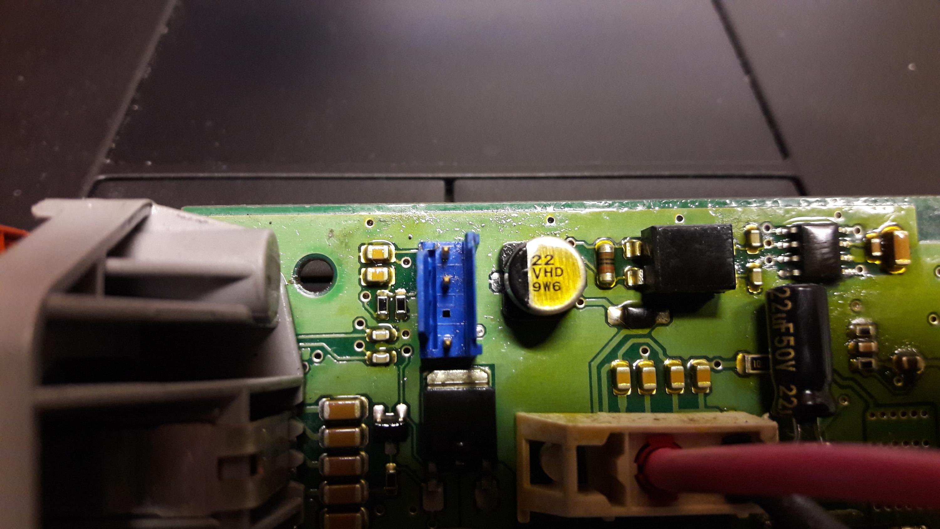

    Hi all, just need some help in confirming the value of this surface mount cap. It is fitted on a control board for BMW X5 Brake actuator.
    At the top of the picture next to the blue connector there is a surface mount cap just marked 22 VHD 9w6 i am taking it that it is a 22uf cap ? Can someone confirm ?
    There were 2 caps with that marking on the board and 1 just fell off the board when the unit was opened, i have replaced it with a panasonic 22uf/50v cap which you can also see in the pic to the right of the surface mount one.
    Thanks in advance
    Nogger

    Re: Surface Mount Capacitor Value
    22uf (V) = 35 volts (HD) = Series, High temperature, Long Life (105deg 5000hr) 9W6 = Lot Number
    • nogger
      • Aug 2010
      • 190
      Many thanks for the response R_J, so my 22uf/50v Panasonc 105 Degree radial cap as installed will do the job perfectly.
      Again many thanks
      Graham
