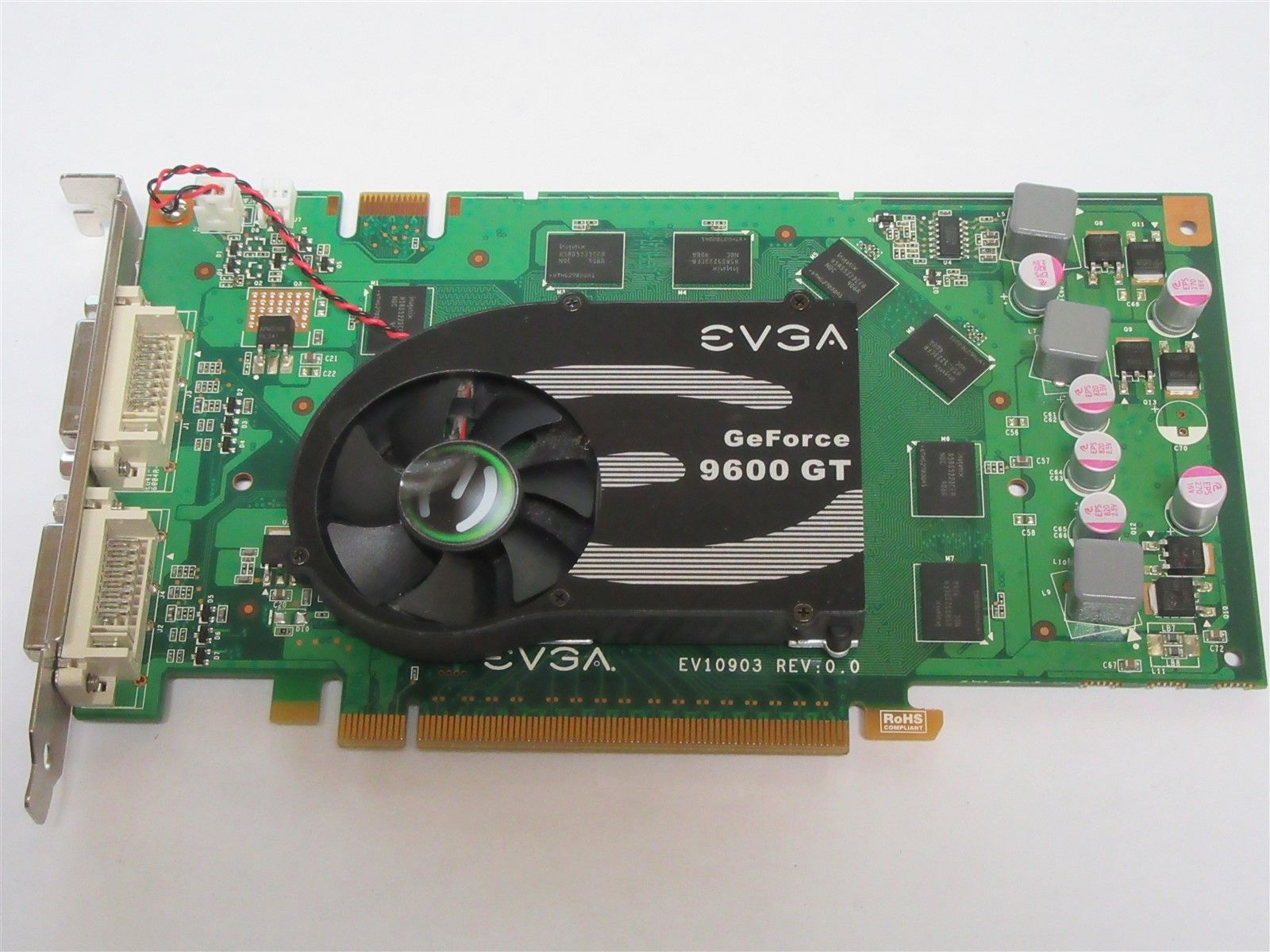

need help identifying caps on video card evga 9600gt low power
  • ChaosLegionnaire
    HC Overclocker
    • Jul 2012
    • 3266
    • Singapore
    i attached a pic of the item in question. i managed to partly identify the caps as possibly being samcon eps series poly caps but i am unable to find a picture of those caps to confirm it.
    if those are indeed samcon poly caps, are they reliable good caps? i hear lots of stories of bad samcon caps in tvs and psus... tho those could be just the electrolytic ones.
  • Wester547
    • Nov 2011
    • 1268
    • USA.
    Re: need help identifying caps on video card evga 9600gt low power
    http://capacitor.web.fc2.com/solidcapacitor.html#elcon
    They're Elcon. Don't know if their polymers are reliable or not, but their electrolytics suck.
    • coreAngel
      • Oct 2014
      • 124
      polymers tend to be reliable depending on the brand, if it was teapo poly i would be ok with that than this brand. Though if it was me i would replace them all with ucchemicon poly's
      Yes i love Nichicon MUSE Audio Capacitors...they would look awesome all over any motherboard
