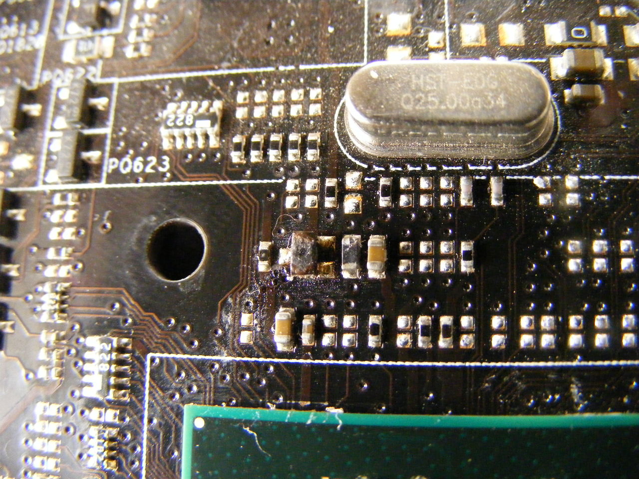

    this is my first thread aasking for help.
    Any of kind of advice is appreciate.
    I stumbled across a Maximus IV Extreme-Z, apparently dead.
    The LED activity is on if I conncet cables, but ON button won't work.
    The chipset area is really hot so I think that the problem could be here, so I removed the heatsink and I see two bad little things.
    Someone says that they are damaged mosfets that can be replaced but I really don' t know much about it.
    On this photo you can see them, the one on the bottom appears to be marked as "43t", judging by Others similar across the board.
    The other one on the left of the photo appears to be burned,or so I think, and I am unable to identify it.
    Here is a better photo:
    I would gladly attempt a replacement but I need to know what to search for...
    Thank you.

    Some news.
    With some precious help, now I can say that both the "things" damaged are labeled "43t".
    Someone said to me to watch this page:
    http://www.s-manuals.com/smd/43
    There I can see that they seem to be "Schottky diodes", model number BAT54CW or BAS40.
    Wich one I am not able to tell. I can't even tell what I have written so far...
    I only need to know what I have to order to try a micro soldering.
    Anyone?

        Do you have a multimeter and do you know how to use it? I think this motherboard repair will take more than just replacing those two SOT-23 MOSFET-like components.
        Speaking of which, are you sure they say "43t" on top of them and not "431"? Because 431 is commonly a shunt regulator, usually used to regulate a voltage rail for the chipset(s) and/or RAM. If the voltage going to the chipset is not right, that could well be causing it to overheat (and in which case, it will likely be dead too... bet let's not assume the worst for now.)

          I can say the are Schottky diodes, for two reasons:
          another motherboard that is exactly the same (the Maximus IV Extreme, not Z) in the same place has a diode labeld l43, so is a Schottky.
          and I can say it is 43t because there are a lot similar mosfet with that tag and no one that is 431.

            Ah okay. It's good that you have another working board like that. Makes finding parts info a lot easier.
            Searching for "L43 SOT-23", I get this:
            https://cdn.badcaps-static.com/pdfs/...dd644e0f1a.pdf
            and this:
            which implies that it is a BAT54C schottky diode (with common cathode on pin 3).
            Now the question is to what do these schottky diodes connect and why did they blow?
            You can certainly just replace them and see what happens. However, if you do that, I strongly advise to buy a few extra ones, just in case there are other problems on the board and they blow again.

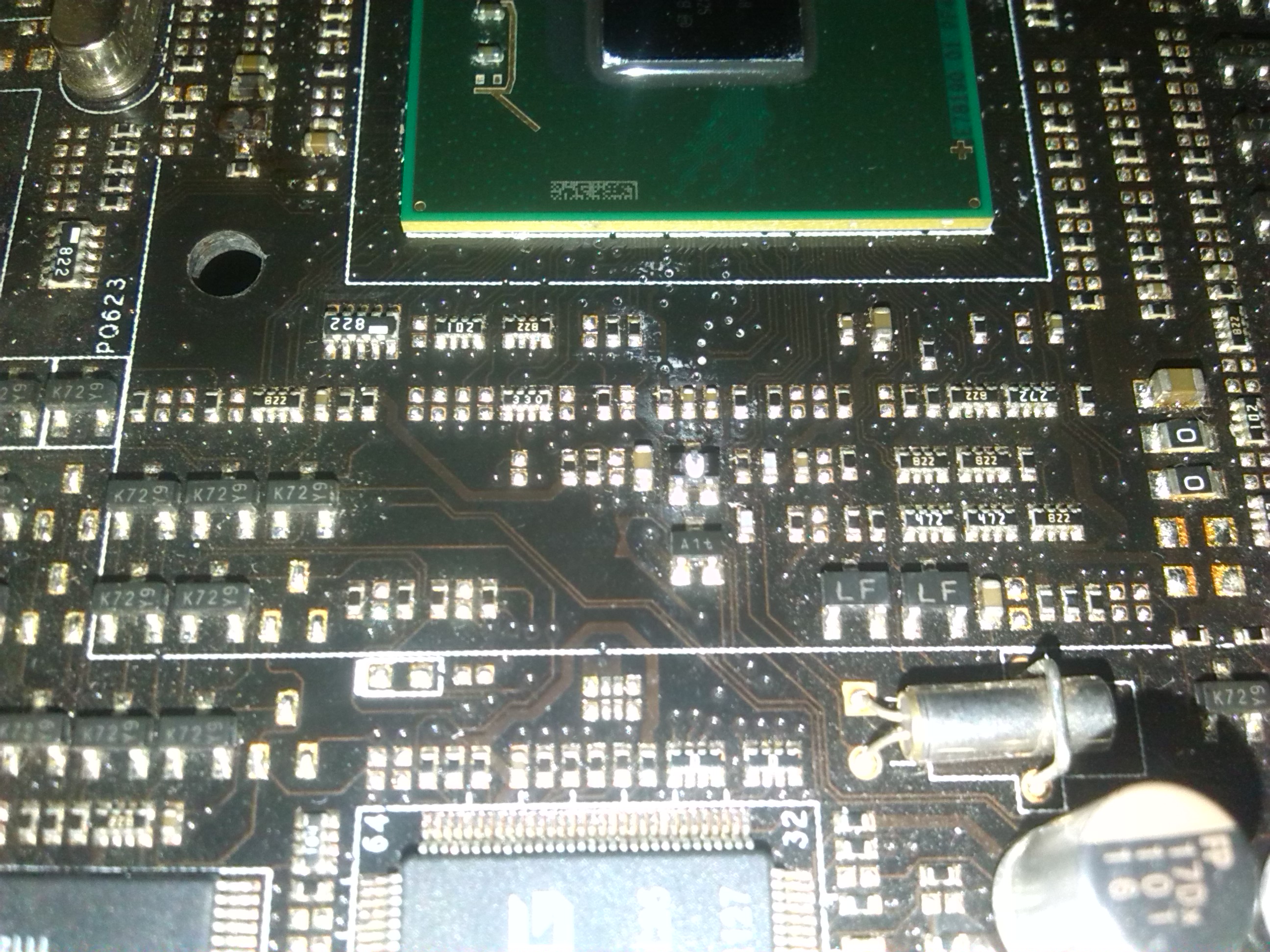

                  Update:
                  Someone changed for me the diodes, the work is apparently well done.
                  Now if I plug the power cord the Chipset stays cold, which is good.
                  BUT:
                  Things are worse:
                  Now There is no more stand by led activity (the slow pulsating ROG symbol), the only thing I see is the rapid blinking of "bios 1" LED althogether with the stand by LED. Nothing more.
                  I can't switch from bioses anymore, can do nothing.
                  Someone on the net says that this behaviour is due to some kind of short, but I am on a cardboard and even stripped all the metal I could from the motherboard (even all the heatspreaders, just to try).
                  Nothing at all, only bios 1 rapidly blinking (and ROG LED).
                  I am at a loss.

                      Re: Help with a Maximus IV Extreme Z and two mosfets (??)
                      From what I have learned (not much...) from here:
                      http://www.google.com/patents/US7747884
                      The diode should be connected via the catode to a South bridge.
                      Connecting all power cables (or even connecting the 24 pin ATX plug only)
                      I notice that the little thing is VERY HOT, maybe the circuit is broken at some level past the diode?
                      Now, I assume this:
                      A) Before replacing diodes
                      With the psu cables plugged in, there was no way to power the motherboard, all I see was the ROG activity led normally bleeping and I was able to flash the bios with the ROG connection and a laptop, it's a ROG exclusive feature. I was able to switch from bios1 to bios2.
                      The Whole Z68 chipset was really HOT.
                      B) After the diodes replacement
                      With PSU cables plugged, no power to motherboard, I obtain only the rapid blinking of bios1 led togheter with blinking of ROG activity led, as I stated it seems to be a signal of some short on the motherboard.
                      The 43t diode "south of" the Z68 chipset is really HOT, the Z68 chipset is cold.
                      I can see an electric trace going from the diode's catode to the Z68 chipset (left of the Yellow mark)....
                      Don't know if this make sense
                      • Uazzamerican
                        • Feb 2016
                        • 33
                        • Italy
                        Update.
                        Changing the PSU, from a Corsair HX520 to a Seasonic S12 600, the Diode 43t blowed up.
                        Now there is the same condition as before...
                        So it's definitely not the diode, but something above or beyond it.
                        I really can't tell what. Giving up....
