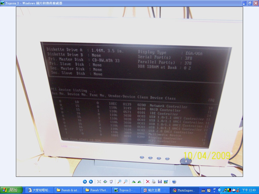

      Dear Friend,
      Why not? The no. of capacitors inside a monitor is usually limited. The monitor of the picture below was taken after its complete replacement of capacitors.
