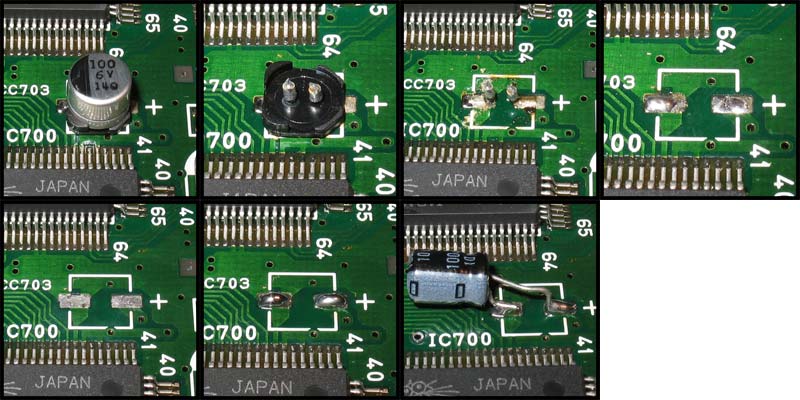

                  Re: bad surface mount capacitors in vintage video gear?
                  i googled some more and found this: http://console5.com/wiki/Converting_...ded_Capacitors
