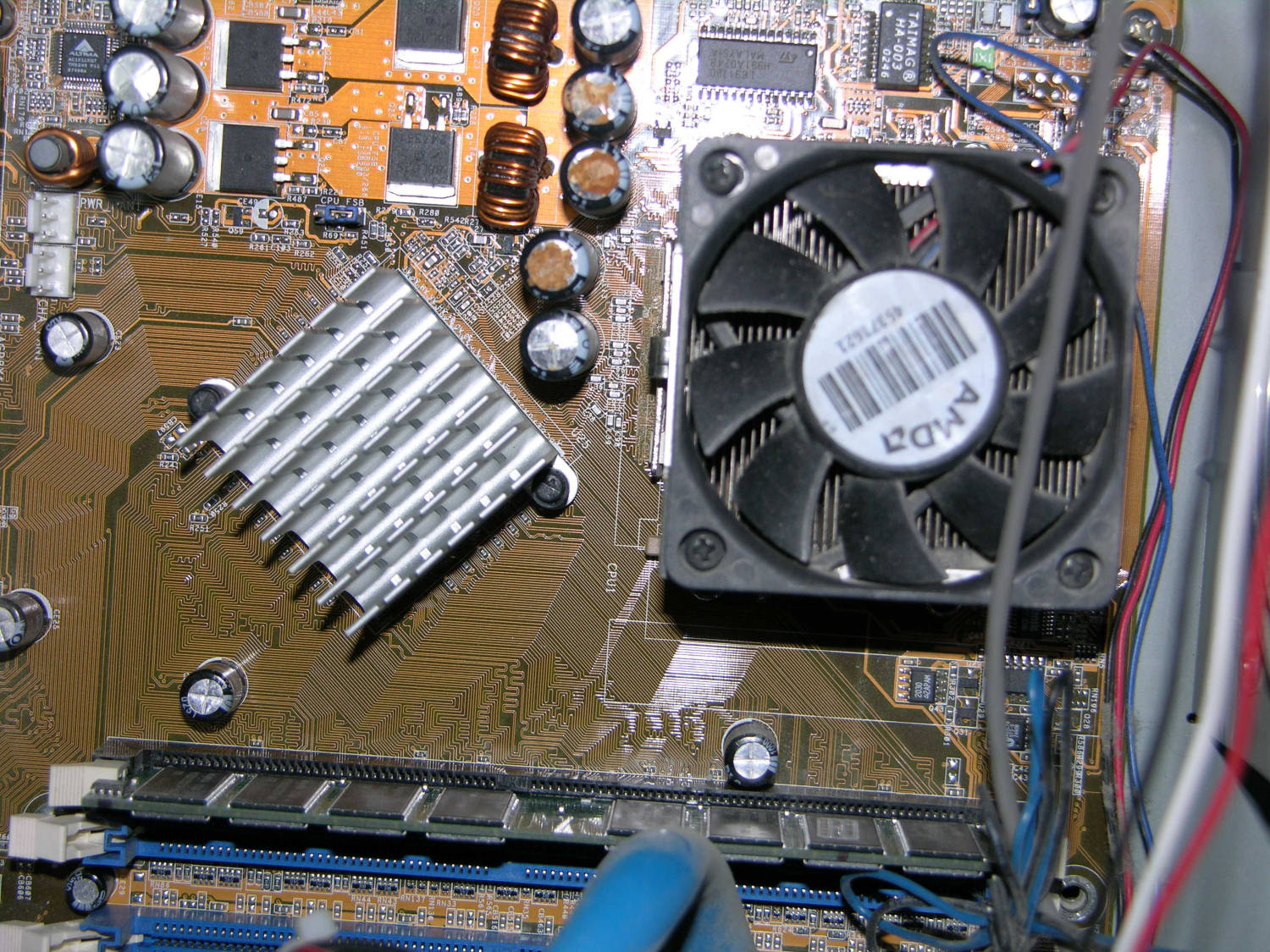

          I have a Asus A7V8X which is 4.5 years old. It has always been temperamental with regard to cooling. The OEM AMD Fan is a huge dust collector.
          I was checking something out recently and found these bad caps! Luckily the board is being replaced with a new Gigabyte, but i will be replacing these caps shortly.
