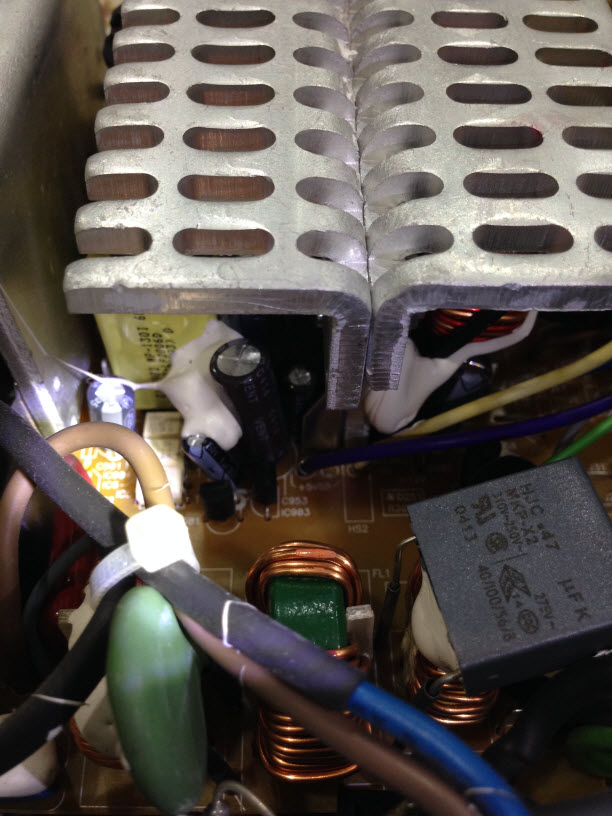

Replace bad caps with Panasonic caps
    replied
    Re: Replace bad caps with Panasonic caps
    If you Google "7905" and open the datasheet from TI (Texas Instruments), you will see a typical application circuit right on the first page. But I am giving you this just for information. Like I mentioned in my previous post, I think your PSU looks fine. The CapXon caps may or may not be bad. But if you want a 100% reliable and trustworthy PSU, then recap it with Japanese caps.
    Leave a comment:
  • liukuohao
    replied
    Re: Replace bad caps with Panasonic caps
    It might be preferable to just purchase a new PSU, because it might end up costing the same.
    Hi mockingbird,
    Thank you for your response.
    But replacing a new PSU will not be an option for me if I want to run
    my P3 motherboard, because it requires -5v to boot up. Without it,
    the -5v rail ( I know it is for the old ISA slot, even though I don't use it)
    I am afraid, I just cannot fire up the motherboard.
    Unless, like momaka mentioned build your own -5v rail using -12 rail
    by building a voltage regulator chip, which I have no such idea unless there
    is circuit diagram.
    Leave a comment:
    replied
    Re: Replace bad caps with Panasonic caps
    Originally posted by liukuohao
    I have taken a couple pictures of the internal view of my Enligth PSU.
    Please see below.
    Thank you.
    Your power supply seems very well-built. Definitely worth saving and recapping.
    Originally posted by liukuohao
    If those crappy CAPXON caps need to be replaced, do I need to replace all of them, as a couple of them hid underneath the huge heat sink which quite impossible to replace, unless I know how to remove the obstruction.
    Usually, it is fine to replace just the output caps - that is, the caps associated with the 3.3V, 5V, 12V, -5V, -12V, and 5VSB rails. Normaly, each rail has two caps. Sometimes I am lazy or don't have enough caps, so I replace only one of the two caps on each rail.
    The caps to replace in your PSU are the larger caps you see in your 1st, 2nd, and 3rd pictures you posted. The smaller caps don't need to be replaced (exception to the rule here are any "critical" 5VSB circuit caps, but I don't think your PSU has that design). Follow the wires for the 3.3V (orange), 5V (red), and 12V (yellow) rails on the solder side of the power supply, and you should be able to figure what caps belong to which rail. A multimeter with continuity/beeper function can also help if you are new to this. If a cap belongs to a certain rail, then the lead on its positive (+) side of that cap will beep/show continuity to the rail it is on. Let me know if you need more explanation here.
    As for the two very large 200V caps - those don't need to be replaced.
    You don't have to remove the heatsinks to access the caps. Just pull the old caps with fingers or tweezers. Work yourself from the outside in.
    Originally posted by liukuohao
    Another option is to buy a new PSU but the problem is none of the modern PSU has a -5v rail.
    You can make your own -5V rail from the -12V rail with a 7905 voltage regulator and two caps. But as I said above, your current PSU looks good, so you don't really need to buy a new PSU. I think your problem may be elsewhere.
    Originally posted by liukuohao
    I tried a couple of them which has got no -5v rail, and the motherboard does not boot up. The only way to boot up is to have an old PSU that has -5v rail.
    Like I said, you have an ISA slot. Most mobo's with that need a -5V rail.
    Last edited by momaka; 02-21-2015, 12:07 AM.
    Leave a comment:
  • mockingbird
    replied
    Re: Replace bad caps with Panasonic caps
    You can leave the two large ones. You should replace everything else.
    If you need help finding good replacements, I suggest you make a post with a list of the caps in the following format:
    Code:
    1) Voltage, Capacity, Diameter * Height, Brand, Series
    2) etc...
    It might be preferable to just purchase a new PSU, because it might end up costing the same.
    Leave a comment:
  • liukuohao
    replied
    Re: Replace bad caps with Panasonic caps
    Originally posted by mockingbird
    Yes. The datecode on them reads "346", which is the 46th week of 2003. These capacitors are more than 10 years old, and they're a lousy brand, so it's very likely they're no good.
    Thank you for your reply.
    So, I need to replace those capacitors as seen in image no.1. = Image_2106.jpg
    That is those noise filter caps.
    How about the massive caps like the black ones, leave them alone?
    Also how about the one that in the middle (referring to image no.3)
    which is sitting alone underneath the heat sink?
    Last edited by liukuohao; 02-20-2015, 11:53 AM.
    Leave a comment:
  • mockingbird
    replied
    Re: Replace bad caps with Panasonic caps
    Yes. The datecode on them reads "346", which is the 46th week of 2003. These capacitors are more than 10 years old, and they're a lousy brand, so it's very likely they're no good.
    Leave a comment:
  • liukuohao
    replied
    Re: Replace bad caps with Panasonic caps
    Hi
    Is there anyone can tell me whether I need to change the CAPXON capacitors
    in the PSU? Since they are considered a bad capacitors in the forum?
    Thank you.
    Leave a comment:
  • liukuohao
    replied
    Re: Replace bad caps with Panasonic caps
    Ok, momaka,
    I have followed your advice......
    I have taken a couple pictures of the internal view of my Enligth PSU.
    Please see below.
    If those crappy CAPXON caps need to be replaced, do I need to replace
    all of them, as a couple of them hid underneath the huge heat sink which
    quite impossible to replace, unless I know how to remove the obstruction.
    Another option is to buy a new PSU but the problem is none of the modern
    PSU has a -5v rail. I tried a couple of them which has got no -5v rail, and
    the motherboard does not boot up. The only way to boot up is to have an
    old PSU that has -5v rail.
    BTW, the 4 pieces of RAM was slotted into position and the BIOS
    did detect ALL 4 pieces correctly and showed on the screen, that was 1GB RAM.
    So it has been working fine for quite some months, note that the motherboard
    was working as a firewall at 24/7 under a very warm conditions.
    The weird problem only arise when the PC was not turned off for a number
    of months unused(resting for a long holiday). Then only last month,
    I booted up the PC and this memory detection issue came into in existence.
    I have to swap out and in the RAM modules(place in a different position
    compare to last time) only then the BIOS will fully recognize ALL memory
    slots, otherwise, it will sometimes show 512MB during booting up the system.
    Appreciated your continuous advice.THANK YOU!!
    Leave a comment:
    replied
    Re: Replace bad caps with Panasonic caps
    Originally posted by liukuohao
    Hmmm....if the your theory is right, then it has to be the Power Supply Unit.
    Because I have a strange problem with my ASUS P3V4X motherboard, sometimes,
    it just cannot detect ALL memory slots when RAM are inserted.
    Don't jump to conclusions just yet .
    Yes, it could be the power supply, or it could also be just the motherboard itself and not related to the caps at all. I say that because you have an ASUS motherboard, and they can be "picky" or buggy sometimes. But let's assume that is not the case for now and try our other options.
    Concerning the RAM: Have you tested each memory module individually? Are they all rated for the same speed? Did you ever try running those RAM sticks together before? Did they work fine and the problem just appeared now?
    Try using one module at a time. If it works, try adding another. Keep doing so until the motherboard cannot boot.
    Lastly, check your motherboard's manual for any settings and compatibility issues, especially about the RAM.
    Originally posted by liukuohao
    I took my old PSU out and open up and found a whole bunch of CAPXON noise/ripple filter caps near output rails = +5v, +3.3v, +12v, -12v, -5v, +5vsb.
    None of the CAPXON caps are bulging nor leaking, they all look normal
    to me.
    So the question is do I waste the time and money to replace the
    CAPXON caps or dump it and buy a new one instead, since you
    already CAPXON caps are shitty caps and unreliable.
    That depends on the power supply you have. It is best to post some pictures of its insides here so we can suggest if it's worth your time or not. Some PSUs are so crappy and "gutless" that it's not worth repairing them at all. However, if you do have a decent PSU, then some new high quality caps will keep it working for a very very long time.
    Also, it depends what kind of power supplies are available on your market and at what price. A new crappy PSU with crappy caps will not solve anything. On the other hand, if you can find a decent power supply for a decent price, then buy a new one.
    Originally posted by liukuohao
    What does a Pentium 3 motherboard need a PSU with -5v for it to boot up.
    I try to boot up with modern PSU (without the -5v rail), it won't fire up at all?
    Probably because your motherboard has an ISA slot. IIRC, the board might require a -5V rail to be present even if there is nothing in the ISA slot.
    Originally posted by liukuohao
    Should I buy a ESR meter to test the SANYO caps to see whether they have been under stress?
    If you plan on doing more repairs and can find an ESR meter for a good price, then, yes, buy one. Otherwise, it may not be worth the cost.
    Leave a comment:
  • liukuohao
    replied
    Re: Replace bad caps with Panasonic caps
    Originally posted by momaka
    Usually no. Good Japanese brands will easily last more than 10 years, especially if they are not abused (i.e. heat, overvoltage, etc.... which on your Pentium 3 motherboard, I'm sure they were not). Heck, I have an old socket 7 Pentium motherboard with original Sanyo and I.Q. (I.Q. is a crap brand) caps, and it still works great. Even my Pentium II motherboards all work fine, and some have extremely crappy caps. They just weren't stressed and that's why they lasted.
    Not necessarily (and I would say no).
    Sometimes, the capacitors can be mounted a bit high on the board (usually a factory thing). This will allow them to lean sideways like you noticed.
    Also, Sanyo capacitors have a rubber bung on the bottom that is raised and has a channel in it - this is to allow any liquids to dry from under the capacitors after the boards have been washed after the soldering process.
    Hmmm....if the your theory is right, then it has to be the Power Supply Unit.
    Because I have a strange problem with my ASUS P3V4X motherboard, sometimes,
    it just cannot detect ALL memory slots when RAM are inserted.
    I took my old PSU out and open up and found a whole bunch of CAPXON noise/ripple
    filter caps near output rails = +5v, +3.3v, +12v, -12v, -5v, +5vsb.
    None of the CAPXON caps are bulging nor leaking, they all look normal
    to me.
    So the question is do I waste the time and money to replace the
    CAPXON caps or dump it and buy a new one instead, since you
    already CAPXON caps are shitty caps and unreliable.
    Side questions.....
    What does a Pentium 3 motherboard need a PSU with -5v for it to boot up.
    I try to boot up with modern PSU (without the -5v rail), it won't fire up at all?
    Should I buy a ESR meter to test the SANYO caps to see whether they have
    been under stress?
    Last edited by liukuohao; 02-14-2015, 11:32 AM.
    Leave a comment:
    replied
    Re: Replace bad caps with Panasonic caps
    Originally posted by liukuohao
    If the Sanyo capacitors are not leaking, but......
    I have been having the Pentium 3 motherboard for more than 10 years.
    1) Can assume the Sanyo capacitors have gone way pass its working life span
    and it is about time to replace it?
    Usually no. Good Japanese brands will easily last more than 10 years, especially if they are not abused (i.e. heat, overvoltage, etc.... which on your Pentium 3 motherboard, I'm sure they were not). Heck, I have an old socket 7 Pentium motherboard with original Sanyo and I.Q. (I.Q. is a crap brand) caps, and it still works great. Even my Pentium II motherboards all work fine, and some have extremely crappy caps. They just weren't stressed and that's why they lasted.
    Originally posted by liukuohao
    2) I discovered that 3 Sanyo capacitors located next to the ATX socket are not firmly sitting on the motherboard, and can be pushed away on angle something like this: \ or /. The slash depicts the position of the capacitors can be moved.
    Does this mean the capacitors is actually bulging from the bottom of the capacitors?
    Not necessarily (and I would say no).
    Sometimes, the capacitors can be mounted a bit high on the board (usually a factory thing). This will allow them to lean sideways like you noticed.
    Also, Sanyo capacitors have a rubber bung on the bottom that is raised and has a channel in it - this is to allow any liquids to dry from under the capacitors after the boards have been washed after the soldering process.
    Leave a comment:
  • liukuohao
    replied
    Re: Replace bad caps with Panasonic caps
    If the Sanyo capacitors are not leaking, but......
    I have been having the Pentium 3 motherboard for more than 10 years.
    1) Can assume the Sanyo capacitors have gone way pass its working life span
    and it is about time to replace it?
    2) I discovered that 3 Sanyo capacitors located next to the ATX socket are not
    firmly sitting on the motherboard, and can be pushed away on angle something like
    this: \ or /. The slash depicts the position of the capacitors can be moved.
    Does this mean the capacitors is actually bulging from the bottom of the capacitors?
    Last edited by liukuohao; 02-09-2015, 11:09 AM.
    Leave a comment:
  • liukuohao
    replied
    Re: Replace bad caps with Panasonic caps
    Originally posted by mariushm
    My thoughts...
    1. Removing the plastic cover saves money.
    2. Polymer capacitors don't need vents so there's a flat top where it's convenient to print stuff and make clear notation of the negative side. Electrolytic capacitors needed to have the top clear of everything, for safety. Regular paint probably had little adherence on the sides and since it's curved, the printing process was probably difficult, hence the need for plastic wrap.
    3. Printing on top is beneficial, it makes it easy for machines that automatically check how parts are placed to detect the negative strip and to optionally read the characters (making sure the machine or person inserted the proper capacitor in the proper position)
    4. A majority of the manufacturing process can be reused to create surface mount capacitors, which are like regular capacitors but with a rubber square on the bottom instead of leads.
    5. With some polymer capacitors, the height is too small to fit everything needed (capacitance, voltage, series, temperature, polarity).
    Some polymer capacitors have diameters so small that you just can't fit all information on top in a long way.
    For example, you probably can't fit 1000uF and 2.5v on a capacitor that's only 8mm in diameter, so you write 102 instead of 1000 ( 10 x 10^2 = 10x 100 = 1000uF) and they use the code "0E" to represent 2.5v. See datasheet and the chart for such a series of capacitors:
    Hi mariushm, thank you for explaining the reason!
    Leave a comment:
  • mariushm
    replied
    Re: Replace bad caps with Panasonic caps
    I wonder why polymer capacitor can't have printed uf + voltage just like the
    older generation electrolytic capacitors, may be the printing cost will be high?
    My thoughts...
    1. Removing the plastic cover saves money.
    2. Polymer capacitors don't need vents so there's a flat top where it's convenient to print stuff and make clear notation of the negative side. Electrolytic capacitors needed to have the top clear of everything, for safety. Regular paint probably had little adherence on the sides and since it's curved, the printing process was probably difficult, hence the need for plastic wrap.
    3. Printing on top is beneficial, it makes it easy for machines that automatically check how parts are placed to detect the negative strip and to optionally read the characters (making sure the machine or person inserted the proper capacitor in the proper position)
    4. A majority of the manufacturing process can be reused to create surface mount capacitors, which are like regular capacitors but with a rubber square on the bottom instead of leads.
    5. With some polymer capacitors, the height is too small to fit everything needed (capacitance, voltage, series, temperature, polarity).
    Some polymer capacitors have diameters so small that you just can't fit all information on top in a long way.
    For example, you probably can't fit 1000uF and 2.5v on a capacitor that's only 8mm in diameter, so you write 102 instead of 1000 ( 10 x 10^2 = 10x 100 = 1000uF) and they use the code "0E" to represent 2.5v. See datasheet and the chart for such a series of capacitors:
    Last edited by mariushm; 02-06-2015, 12:19 PM.
    Leave a comment:
  • liukuohao
    replied
    Re: Replace bad caps with Panasonic caps
    Originally posted by momaka
    Maybe, but I don't know of any. Capacitorweb, perhaps.
    That said, I think you are misled into thinking that all sleeveless caps are polymers and vice versa. For example, the shiny silver sleeveless FZ capacitors in the picture below are NOT polymers, they are standard electrolytics:
    https://www.badcaps.net/forum/attach...9&d=1421341284
    Likewise, the yellow caps on the motherboard in the picture below are not electrolytics, even though they have sleeves and vent stamps. They are polymers - Fujitsu FPCAP RE series.
    https://www.badcaps.net/forum/attach...8&d=1351481371
    So how does that answer your question? Well, there is no special way to read those sleeveless caps. You just look at the numbers on the top and that is usually enough to tell at least what voltage and capacitance they are.
    Generally, it looks like this:
    Line 1: Cap series, cap manufacturing code, and/or company logo
    Line 2: capacitance (either in standard or multiplier format*)
    Line 3: voltage (again, either in standard or special coding format**)
    These lines may appear in a different order, though (i.e. line 2 before 1, and etc.)
    * : here is an example of multiplier format: 821. The first two numbers (82) are part of the capacitances number, and the last number (1) is the multiplier.
    1 = 10
    2 = 100
    3 = 1000
    and so on
    So "821" translates to 82 x 10 = 820 uF
    If you have the number 152, then that could be 15 x 100 = 1500 uF
    ** : as for the voltage coding format, this tends to vary between manufacturers and is not standard as far as I know. But these coding formats are not used that often.
    Hi momaka,
    Yes, I did notice that some polymer capacitors look like polymer but in actual
    fact they are not........when I read the link below:
    http://www.capacitorlab.com/capacitor-types-polymer/
    But I never realized that those Fujitsu yellow capacitors are really polymer
    even you can clearly see the vent sleeves on top of them:
    https://www.badcaps.net/forum/attach...8&d=1351481371
    So wonder why they made them to have sleeves????
    Most appreciated for giving your information about reading the polymer
    capacitor's value. I am going to have to write this information down
    on a note book.
    I wonder why polymer capacitor can't have printed uf + voltage just like the
    older generation electrolytic capacitors, may be the printing cost will be high?
    I just wish someone can gather all information and write all in 1 sticky for
    easy reference.
    I just can't not thank enough to people who contribute their advice on my post.
    Again. Thanks a million in helping out!!!! Give yourself a pad on your back!!!!
    Last edited by liukuohao; 02-06-2015, 11:43 AM.
    Leave a comment:
    replied
    Re: Replace bad caps with Panasonic caps
    Maybe, but I don't know of any. Capacitorweb, perhaps.
    That said, I think you are misled into thinking that all sleeveless caps are polymers and vice versa. For example, the shiny silver sleeveless FZ capacitors in the picture below are NOT polymers, they are standard electrolytics:
    https://www.badcaps.net/forum/attach...9&d=1421341284
    Likewise, the yellow caps on the motherboard in the picture below are not electrolytics, even though they have sleeves and vent stamps. They are polymers - Fujitsu FPCAP RE series.
    https://www.badcaps.net/forum/attach...8&d=1351481371
    So how does that answer your question? Well, there is no special way to read those sleeveless caps. You just look at the numbers on the top and that is usually enough to tell at least what voltage and capacitance they are.
    Generally, it looks like this:
    Line 1: Cap series, cap manufacturing code, and/or company logo
    Line 2: capacitance (either in standard or multiplier format*)
    Line 3: voltage (again, either in standard or special coding format**)
    These lines may appear in a different order, though (i.e. line 2 before 1, and etc.)
    * : here is an example of multiplier format: 821. The first two numbers (82) are part of the capacitances number, and the last number (1) is the multiplier.
    1 = 10
    2 = 100
    3 = 1000
    and so on
    So "821" translates to 82 x 10 = 820 uF
    If you have the number 152, then that could be 15 x 100 = 1500 uF
    ** : as for the voltage coding format, this tends to vary between manufacturers and is not standard as far as I know. But these coding formats are not used that often.
    Leave a comment:
  • liukuohao
    replied
    Re: Replace bad caps with Panasonic caps
    Is there a website or any information that teach you how to read the
    information printed on the polymer /solid capacitors?
    Last edited by liukuohao; 02-05-2015, 09:32 AM.
    Leave a comment:
  • liukuohao
    replied
    Re: Replace bad caps with Panasonic caps
    Originally posted by momaka
    Here's a simpler rule of thumb (and I say rule of thumb because I break rules and experiment all the time ).
    ESR of new capacitor should be the same or lower than the original caps.
    Capacitance should be the same or higher than the original caps
    Ripple Current should be the same or higher than the original caps.
    Working Voltage (or simply the Voltage) should be same or higher. Lower IS possible if you know the capacitor you are replacing will not go above a certain voltage. But if you are new to recapping, don't lower the voltage on caps just yet.
    Ok, then...Momaka, thanks for the advice. The air quality is much more better
    now then before, I can see the path straight ahead of me.
    I will go ahead and order some of this Nichicon polyer capacitor from RS:
    http://my.rs-online.com/web/p/tantal...itors/0541491/ and see
    how it work out.
    Hopefully your advice of rule of thumb is rock solid
    Leave a comment:
    replied
    Re: Replace bad caps with Panasonic caps
    Originally posted by liukuohao
    But I am getting conflicting advices from the forum members.
    As you are advising me to stick to a capacitor that can MATCH the previous
    capacitor's ESR value as CLOSE as possible. Yet I am hearing others that get
    a LOW ESR will work fine provided you are getting a same capacitance of
    820uf, 6.3v(or higher 10v). Sigh..... which side do I follow??
    Here's a simpler rule of thumb (and I say rule of thumb because I break rules and experiment all the time ).
    ESR of new capacitor should be the same or lower than the original caps.
    Capacitance should be the same or higher than the original caps
    Ripple Current should be the same or higher than the original caps.
    Working Voltage (or simply the Voltage) should be same or higher. Lower IS possible if you know the capacitor you are replacing will not go above a certain voltage. But if you are new to recapping, don't lower the voltage on caps just yet.
    Leave a comment:
  • liukuohao
    replied
    Re: Replace bad caps with Panasonic caps
    Originally posted by c_hegge
    It's listed as a tantalum capacitor. It should really have been listed as an electrolytic (like most of the other polies on RS).
    I wonder why it is listed as Tantalum + electrolytic, must be a typing error??
    Leave a comment:
    by momaka
    03-12-2025, 03:42 PM
  • Paxman_Swede
    Identifying caps on an old Zoom 9000
    by Paxman_Swede
    Hello!
    I have two projects on my work bench. One is a friends dead JBL Xtreme speaker with a blown voltage regulator and corresponding bulged and shorted cap. That cap has clear markings so I know what replacement I need for it.
    The other project however is a whole different deal. It's a Zoom 9000 guitar effect from the 90th that has developed a devil hound howl when there is no input from the guitar. I'm guessing caps problem. So, since I don't really use this effect anymore I thought it would be a perfect project to learn on.
    I have studied the board and...
    01-14-2025, 09:51 AM
  • Foetuss
    Gigabyte GA-6OXT :: caps question
    by Foetuss
    Good evening
    I recently aquired a rev 1.1 Gigabyte 60XT, and was suprised of the amount of leaking caps for a motherboard of the P3 era. Especially the way the 330µf caps seems like the housing discolored even.
    Now, there are some 3300µF 6.3V KZG series around the CPU. Would it be OK to replace them with something like EEUFR1A332 ? (Panasonic FR 3300µF 10V). Or was this board designed around very low ESR caps?
    But I was also suprised about the bigger boys, which are 330µF 25V.
    Could it be they used 25V caps because they were cheaper / available at that time?...
    02-11-2025, 12:22 PM
  • edith
    Caps and how to find one to replace
    by edith
    Hello everyone I have a question. I have a laptop and his schematic. Can anyone tell me how to measure or any way to understand specific of caps so i can buy new one?
    Also in case how can I understand if some caps of some dead Mobo i have, are ok to be replaced in my new motherboard which im trying to fix?
    Thank you!
    06-11-2023, 05:00 PM
  • captain150
    Help with switching power supply caps
    by captain150
    I'm trying to repair two old VCRs, they both have bad caps. One has leaky ones, the other would barely run until I subbed in some caps from another power supply I had laying around (though they are the wrong values). This vcr works for an hour or two, but then the power supply starts whining and the picture gets lines in it. I didn't replace all the secondary caps, so another voltage might still be problematic, or the values I used are too far off.
    I've been on mouser and digikey but the options are a bit overwhelming. I just need some new ones that will work. They don't need to be top quality,...
    03-16-2025, 07:34 PM
