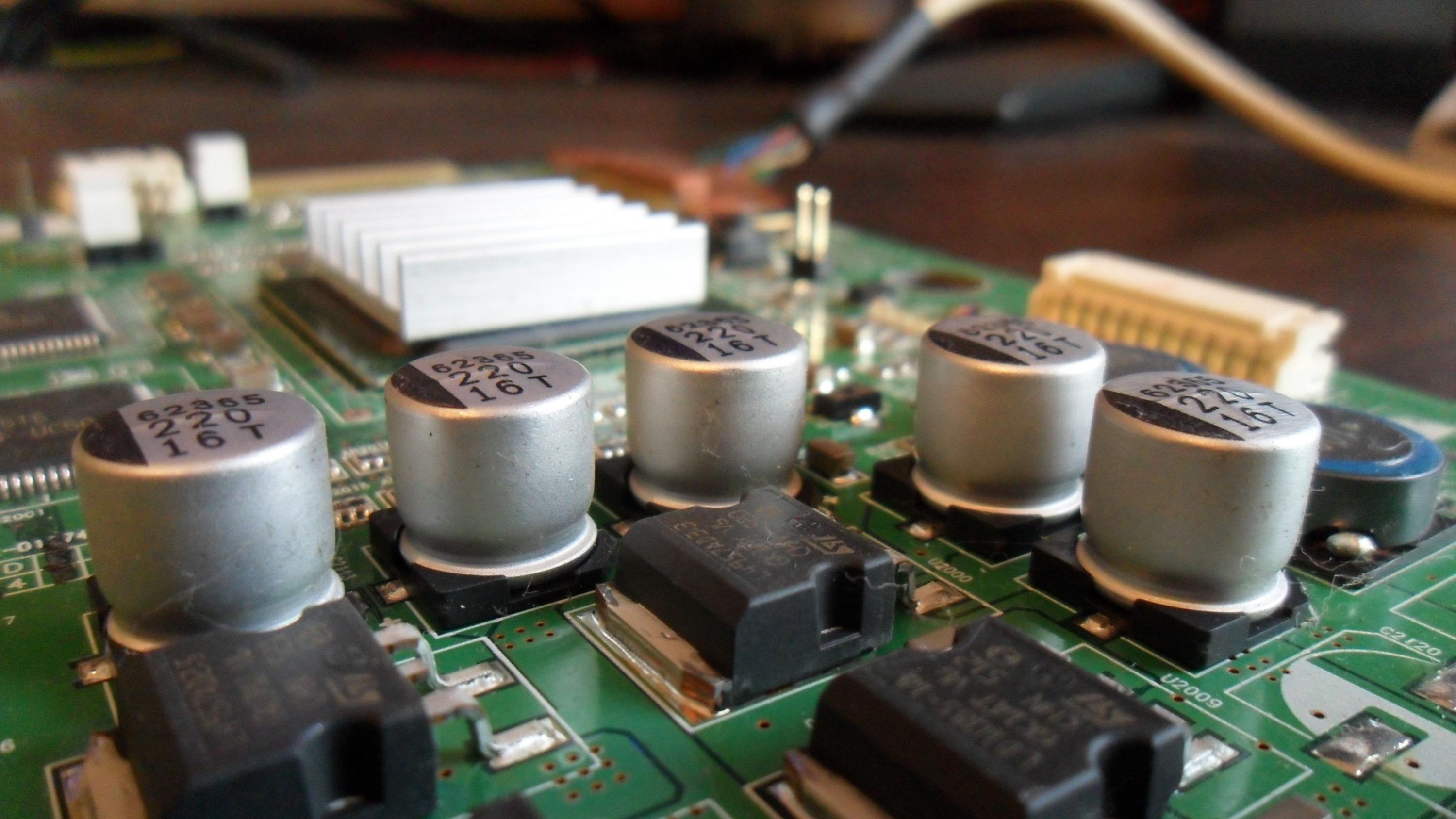

    220 16T SMD Caps
    Does 16T refer to the voltage as in 16v? what does the T represent?
    Does 220 = 220uf?
    Can these be replaced with normal radial caps?
    I'm new to electronics and appreciate any guidance given.

    Re: 220 16T SMD Caps
    Those are standard electrolytic capacitors, just in a surface mounted format.
    Yes, they're 220uF 16v, you can use normal radial capacitors.
