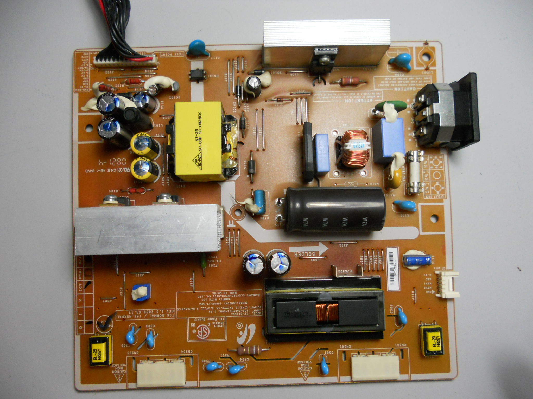

    the Samsung T240
    few weeks ago i decided to shut down my pc but when i tried to turn back on several hours later, the monitor won't lit up,
    I rule out the "2 seconds to blackness" since there's not even half a second letting me turning it on. only once a while when i tried to turn it on, the red led will lit up for less than half a second.
    Nothing is showing on the screen, so i have no idea what's wrong with it
    after i did some googling and some youtubes videos
    i decided to pop it open
    i studied a few thread saying
    it's either
    a) bad caps
    b) bad ccfls
    c) bad ccfl wiring (especially the return wiring)
    d) bad secondary windings on the inverter transformer
    which in my case
    the first thing i see are the Bad yellow cap from sam young
    so my first option would be replacing all the caps
    problems, because some of the white glue or paste are on the way and how the caps was placed,
    i have no idea how to identify them
    I know the Yellows are 1000uf 10v which i might replace it with 1000uf 16v or 25v
    aside from that which caps should i be replacing, should i replace all? including the small one?
    hopefully the problems only stay with the bad caps and nothing else
    thanks in advance, help is much appreciated.

    Those yellow caps are almost certainly the problem.
    This, this, this, or this should work. You'll need to measure the physical size of the old caps to see which will fit. Of course, you could use a different brand with the same specs if you wanted to.
    Now, while likely only the bulged caps are bad (yet), it is a very good idea to replace every lytic cap on the board. If you can tell us the markings on the others, we can suggest replacements for those as well.

      the problem is the cap placement, i can't seems to be able to identify them but ill try my best
      (from top left to bottom right in order)
      Twin black next to yellow are 820uf 25v
      smaller black solo next to twin black is 330uf 10v
      mini black with white paste allover it is 3.3 uf 50v
      Yellow caps are 1000uf 10v
      another small one near the heat sink(top) i have no idea but it's (41uf)?50v i have no idea, the white paste is covering it and the distortion of the plastic distorted it, so im not sure if its 41uf or 4.1uf
      what's the white paste for anyway? all monitor seems to have it.
      twin blacks near the inverter are also 820uf 25v
      do i need to replace the big cap(W7A) too? the info is blocked, i cant seems to find any text accept a half cropped 150uf or 750uf
      should i pay any attention to the small white cyclinder shaped thing with both end wrap in metal? it is near the power in plug at the top right potion of the picture(refer to post 1)
      nonetheless once i get all accurate caps spec i will replace them with either rubycon or panasonic

        Hi - White cylinder is a fuse - test it meter on ohms 200.
        There is another green one at F301 just under the heatsink in your picture.
        Not many 41uf 50v caps about it will be 47uf 50v
        You do not need to change the BIG cap unless it is bulged or leaky.

          i'd just noticed my inverter transformer is tm-09175
          but a lot of other thread mentioning about TM-10160 instead.
          when i look into it, some mentioned tm-09175 is not available anymore
          • selldoor

                          my monitor repairing has come to an end
                          i fixed the samsung t240 by replacing all the caps on the PSU
                          thank you guys so much
