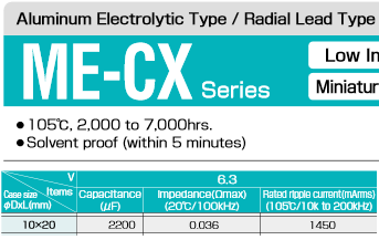

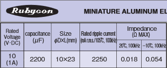

    Reading through this forum more, it looks like I dodged a bullet on ESR with the replacement ZLH Rubycons I bought.
    Too bad I don't have an ESR meter to have checked if they were counterfeit.
