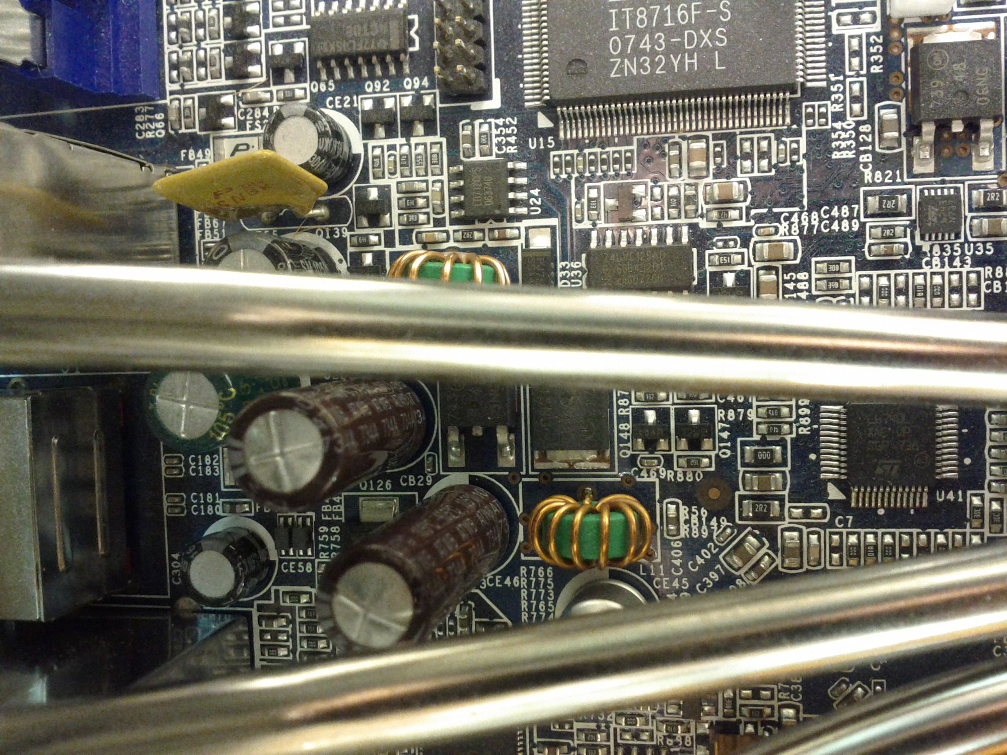

    Please can someone help me?
    A Shuttle SN68SG2 keeps shutting down every time I try to turn it on. Just as the login screen is about to display, it shuts down.
    (After removing and replacing the power supply, it turns off immediately after pushing the on button).

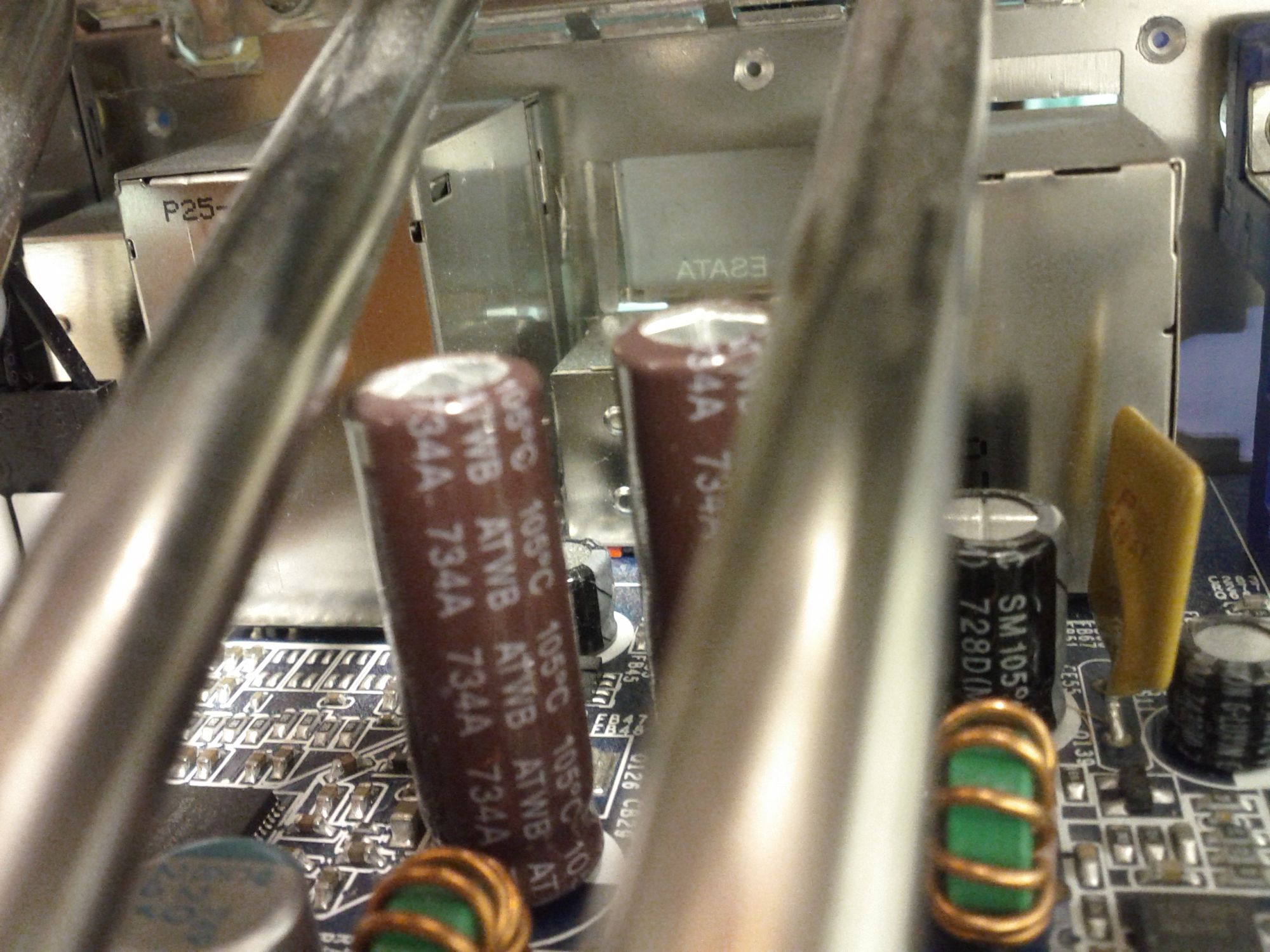

    I looked at the motherboard and I think the tops of two capacitors are slightly bulging out.
    Looking at the side I see the following printed on them:
    105°C ATWB 734A TK 6.3V1800uF
    Should I replace them (Please see attached pictures)?
    If I need to replace them, which ones should I order?
    Is this a capacitor issue? (Based on the pictures and description)?
    Is this a case of a bad motherboard instead?
    Thanks for any help!

    Good thing you wrote the capacity and voltage as you've posted two pictures with the same sides of the capacitor
    Replace with these (from best to less good):
    http://search.digikey.com/us/en/prod...PM6-ND/2428106
    http://search.digikey.com/us/en/prod...PD6-ND/2428124
    http://search.digikey.com/us/en/prod...109-ND/1662495
    http://search.digikey.com/us/en/prod...MPD-ND/2428125
    http://search.digikey.com/us/en/prod...381-ND/2433515
    http://search.digikey.com/us/en/prod...364-ND/2433498
    Yes, some of them in the list above are rated for 10v - it's safe to use capacitors rated for higher voltage so it's no problem.
    -- the capacitors in the picture are bad, replace them. It wouldn't hurt to post pictures of the whole board so we can have a look - there may be other capacitors that should be replaced even if they don't look bad.
      They are definitely domed and bad.
      I don't know who makes the original, but these will suffice
      https://www.badcaps.net/store/produc...roducts_id=146
      You should also take apart your power supply. It may have bad caps in it too? If yes, then poor quality power is being sent to your motherboard which will cause more bloated caps in the future.
