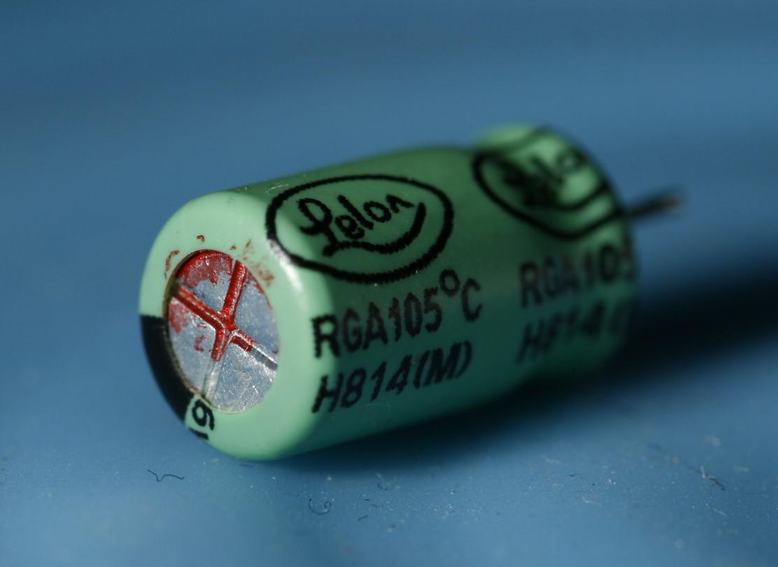

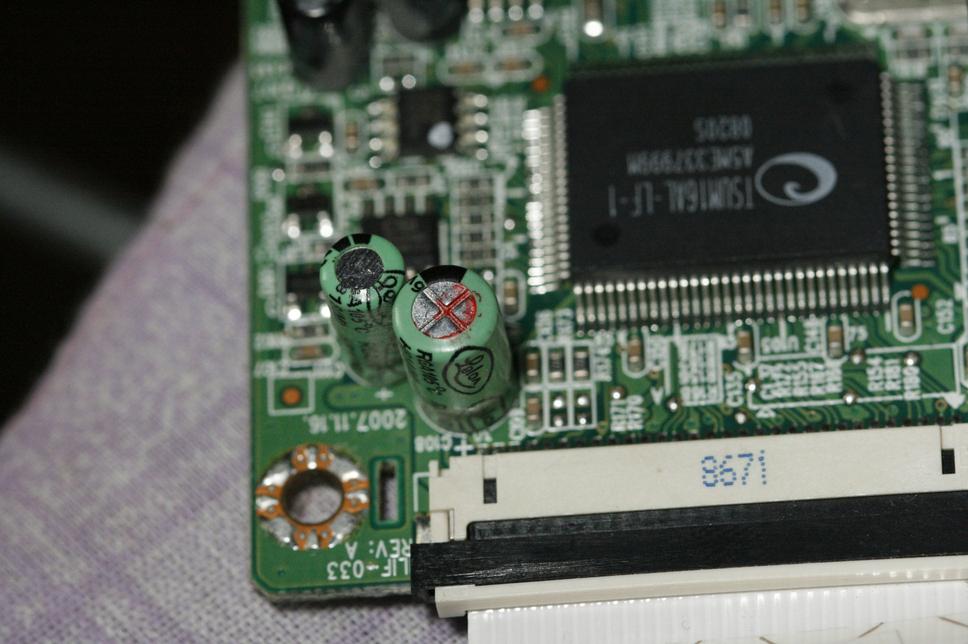

    Found this Lelon cap on the interface board of a LG W1934S monitor.
    The vent is covered with a redish thing and it's ESR is looking unusually: 0.36 ohms compared to another ones which are 0.13-0.16ohms.
    It's a Lelon branded 220uF/10V cap.
    Do you think this is a bad cap? Or a measurement error (altough I tested it more than 4 times).

    Re: Bad/leaky cap?
    Looks like ink to me.
    Sometimes they mark caps as part of QA so they know some check or another got done.

      Re: Bad/leaky cap?
      There's no other cap on that board marked as such.
      But yes, maybe ink.
      My feeling is that I should change it, based on the reputation of Lelon brand, but I wanted a second opinion.
      I will remove it and measure the capacity also, ESR looks a bit weird when measured on-circuit.
      Anyway, never seen such a small cap failing. It's filtering a 5V line to a regulator, but is behind another bigger cap located on power board, this one being a 1000uF/10V low-esr according to manual.

        Re: Bad/leaky cap?
        Look up what the ESR should be.
        Might not even be a low ESR cap.
        If the others you measured are in parallel and you measured in-circuit it's the other readings that are off.

          Re: Bad/leaky cap?
          That red colour doesn't look like electrolyte to me... it normally ranges from brown to yellow as far as I know.

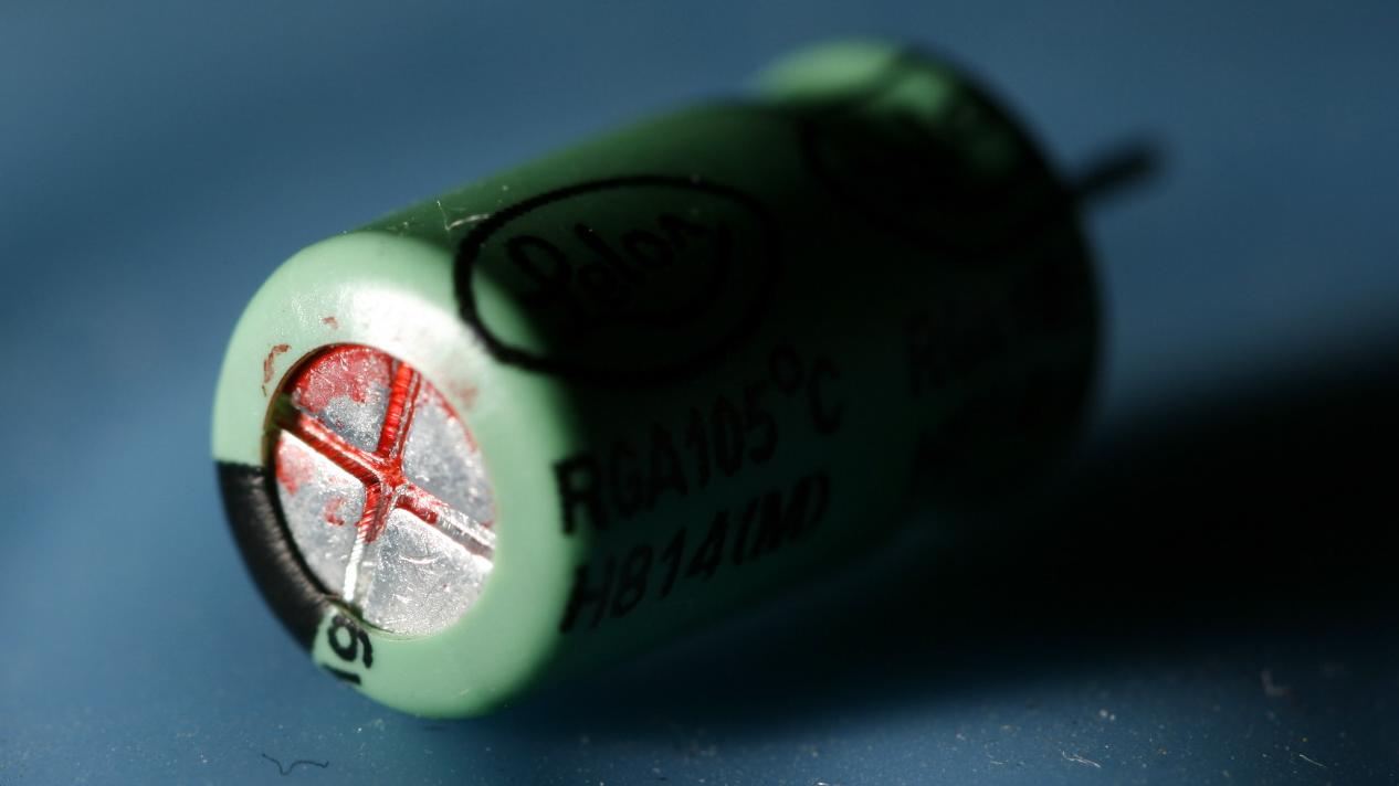

                Re: Bad/leaky cap?
                Today I've removed it from PCB. Now it shows values of 0.28 and slowly incresing with time. Afther just a few seconds it shows 0.31. Also, capacity measured with a multimeter (Fluke 189) is at first reading 220uF and slowly decreasing with time, in a few seconds is 213uF. Never seen that behaviour.
                Indeed, it's not lowESR type, just a standard cap. It's a 220uF/10V Lelon RGA series. But they do not specify ESR at all in the datasheet, unfortunatelly.
                There is no other cap in parallel.
                Two more pictures of the removed cap.

                  Re: Bad/leaky cap?
                  I was talking about when you measured the other caps you are comparing it to.
                  Your measurements say the cap is fine.

                            • ipman
                              • Jul 2011
                              • 159
                              Re: Bad/leaky cap?
                              I've put that one back on the PCB were it belong.
                              It seems to be working, the weird problem was a bad contact in a lamp pigtail connector.
