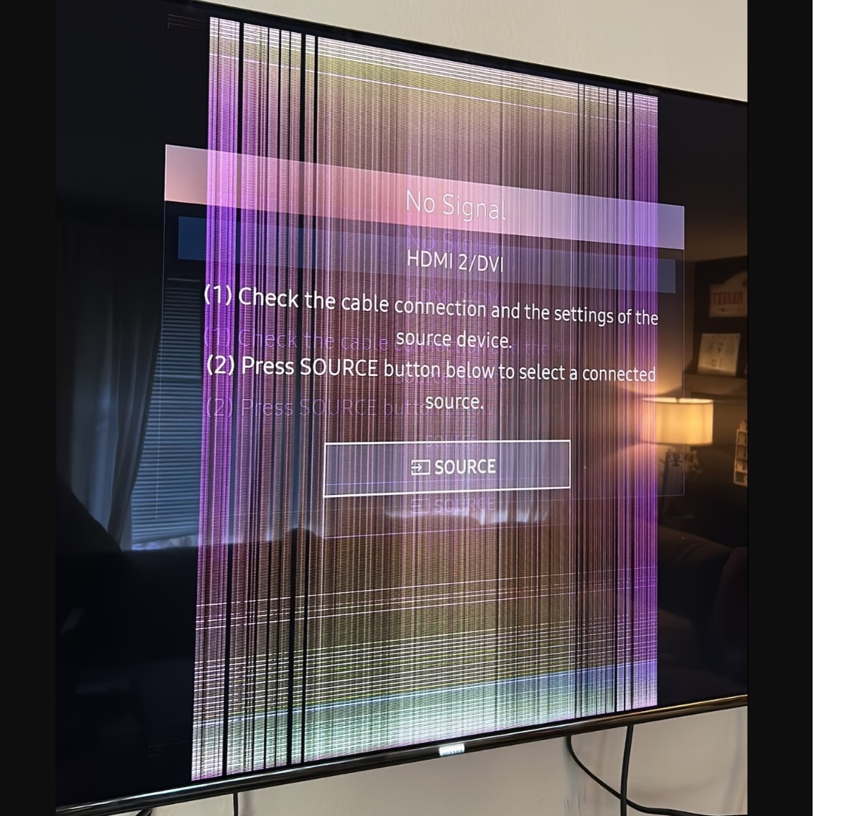

    I have a Samsung UN55KS800DF
    When I turn the TV on the picture initially looks great
    After 10 seconds or so, the bottom of the screen starts to show issues and it slowly creeps upward
    Eventually the entire display is ghosting and distorted. If I power the TV off for a few minutes and power it back on, the cycle repeats with a good display that slowly degrades.
    I have attached an image of the display after about 3 minutes of being powered on
    Thanks in advance for all you do for us!

      Re: Samsung un55ks800df - Display slowly degrades
      These are symptoms of bad t-con or panel.
          it is panel 99,9% not tcon, must check panel distribution boards and check if some diodes are present but much probably are the faulty gate drivers.. i have the ue46b7000 with similar issue, changed 2 tcons, same effect.. also changed two level shifters on the tcon, same problem..
            This model has issues like this sometimes related to the diodes on the buffer boards.
            It’s been discussed on this forum before. Doesn’t cost anything to try if your good with micro soldering. I would check this before ordering tcon etc.
                Nothing much difficult, you are searching for a row of maybe 8/10 diodes, must check them all in resistance mode, if you find one that measures bad, or another way is to pick a frequencymeter and search for a signal about 20khz (CLK), some are 100hz (VST/STVP)
                  I've finally got some time to test this TV, and so far I've found only a couple VERY small diodes on the buffer boards that read (1) on the Multimeter, all others "in resistance mode" read between ~300 and ~500
                  I assume this means that is a bad diode and should be replaced, but I'm not sure of the size to order for replacement
                    Always put the measures unit, 1, 300 are ohms? if yes first try to remove the lower ones and test the tv, if is ok then start searching a replacement
                        If we are talking about TVS diodes, then remove them and do not install anything, everything will work without them.
