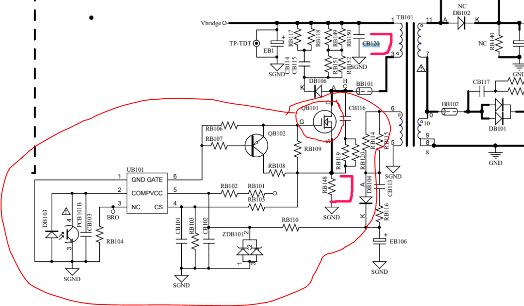

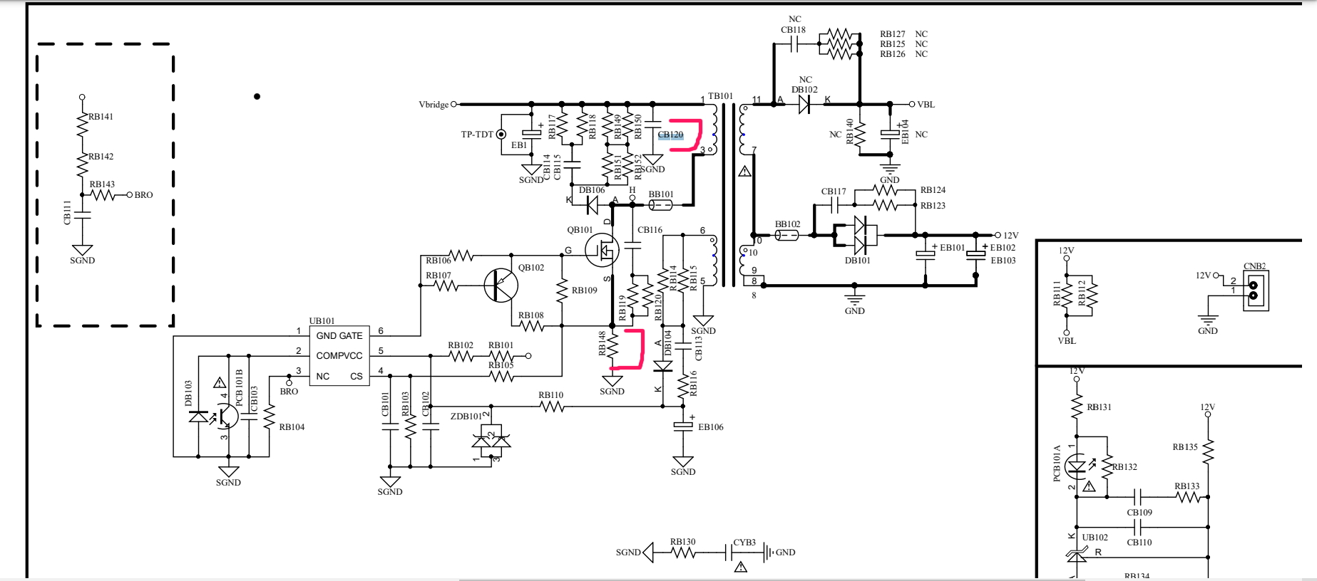

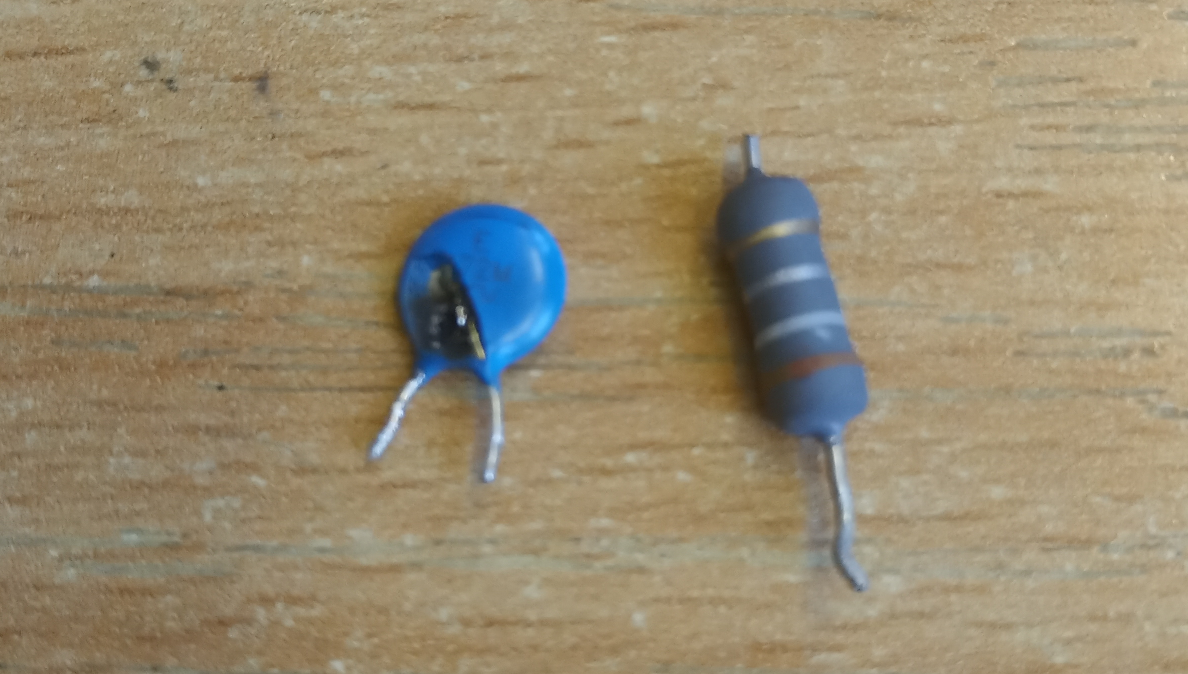

    During TV Sharp LC-22CFF4011E repair I found out several parts faulty.
    ( including a capacitor and a resistor)
    Eventhough I have a service manual the values of parts are not given there.
    The parts were in HOT part of power supply.
    Can you please suggest values that could be OK ?
    Thank you.
    P.S.
    I enclosed a schematic part of power supply - faulty items marked in red -

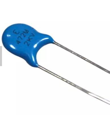

    and also original parts - capacitor has marking like 72M but the leading number seems to be missing.

    Re: Sharp LC-22CFF4011E
    C - 472 2kv
    R - 0.19 Om 5%
      QB101 should also be checked, if it is short, then UB101 and its harness probably suffered ...
        @lotas:
        Thanks a lot for help
        But what is the capacitance of tha capacitor? Is it 472 pico Farads?
        Yes, QB101 seems good.
          Originally posted by Jane
          @lotas:
          At the end 2 is the multiplier, ("1" is multiplied by 10, "2" is multiplied by 100...), 472 is 47 times 100 we get 4700 pF 2kV (2000v).
