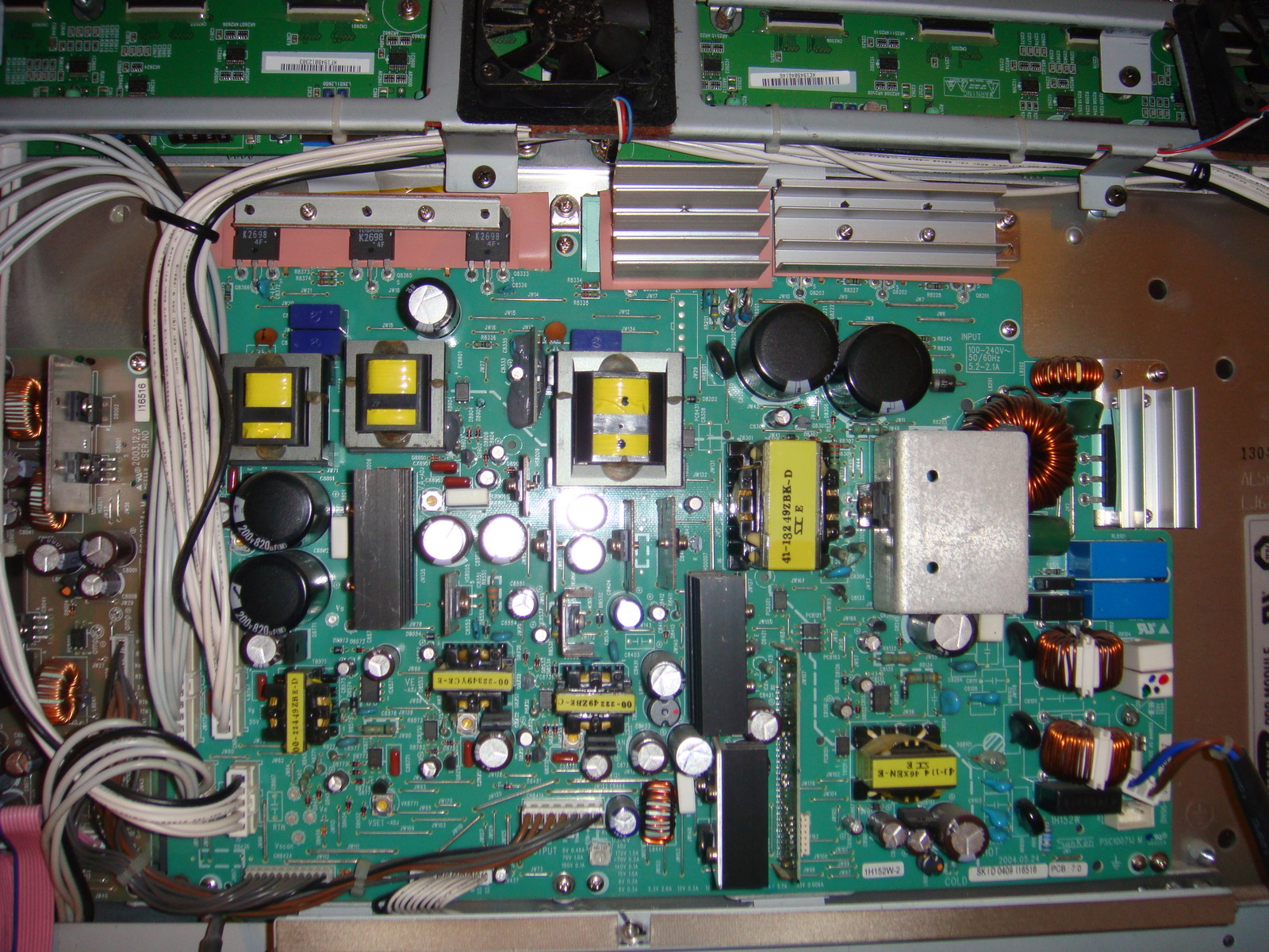

    Hello I have a Samsung PS-42P4H1 42" Plasma
    Power supply# BN96-01047A (PSC10071J M)
    It tries to turn on, but a relay just keeps clicking.
    The screen never actually turns on.
    I have repaired several computer LCDs before so I am not a complete noob, but I am new to the bigger stuff.
    I have the tv apart and searched every board for signs of a blown cap.
    But haven't found any leaking or bulging.
    I have always been lucky before the culprit capacitor was very obvious.
    From my research I am guessing the trouble probably lies with the power supply board. But with no visible indication of which capacitors is bad I do not know where to start.
    I have a good Fluke 189 meter that can check capacitance.
    With the board removed I have checked a few caps in circuit but for a 4700 uf 10V cap I get 8.25 MF.
    Which doesn't seem right but I am not sure If I understand what that is telling me. When I check a bigger cap like a 47 uF 450v I show 450 uF on the meter. Meter is set to auto range.
    So first maybe someone could explain what my meter is telling me. Google hasn't been much help so far.
    When I check the resistance they build to infinity.
    I know it would be best to check the caps out of circuit. But I do not want to just start pulling capacitors off and checking them if it is not necessary, as that could lead to more problems then I started with.
    So my real second questions is where should I start? How can I narrow it down?
    Thanks in advance for any help anyone can offer.

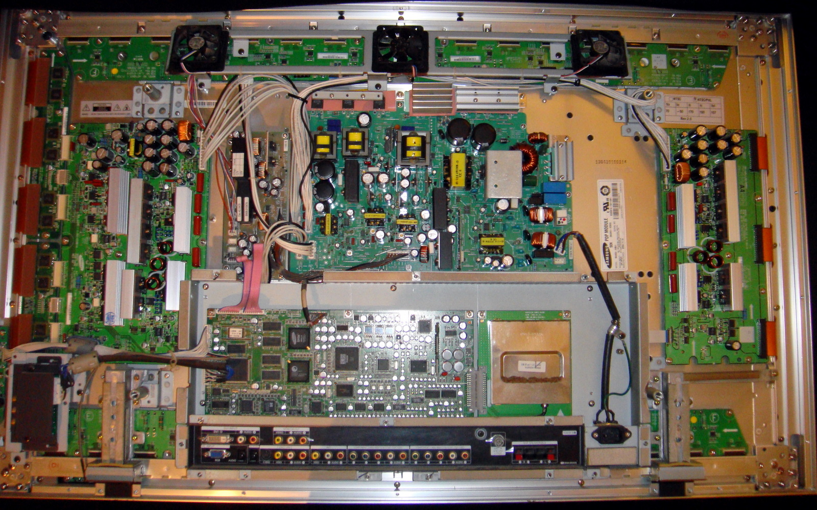

      PS. Pictures of all your boards would help too. Attach your pictures using this method ...
      https://www.badcaps.net/forum/showthread.php?t=1868

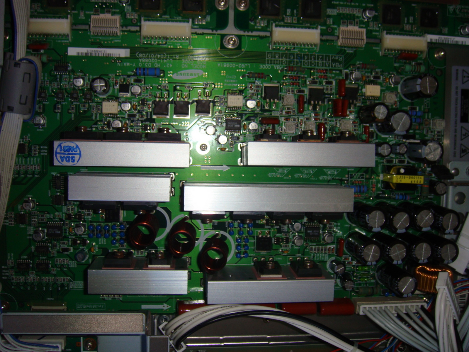

        To add to what retiredcaps said, pictures of the power supply would help. Also, most of these supplies have the output voltages labeled. The first experiment would be to use your Fluke to measure the standby voltage (probably labeled 12VS, 5VST, 6VSBY, or something like that), then check the other outputs to see if any are coming up when the relay clicks.

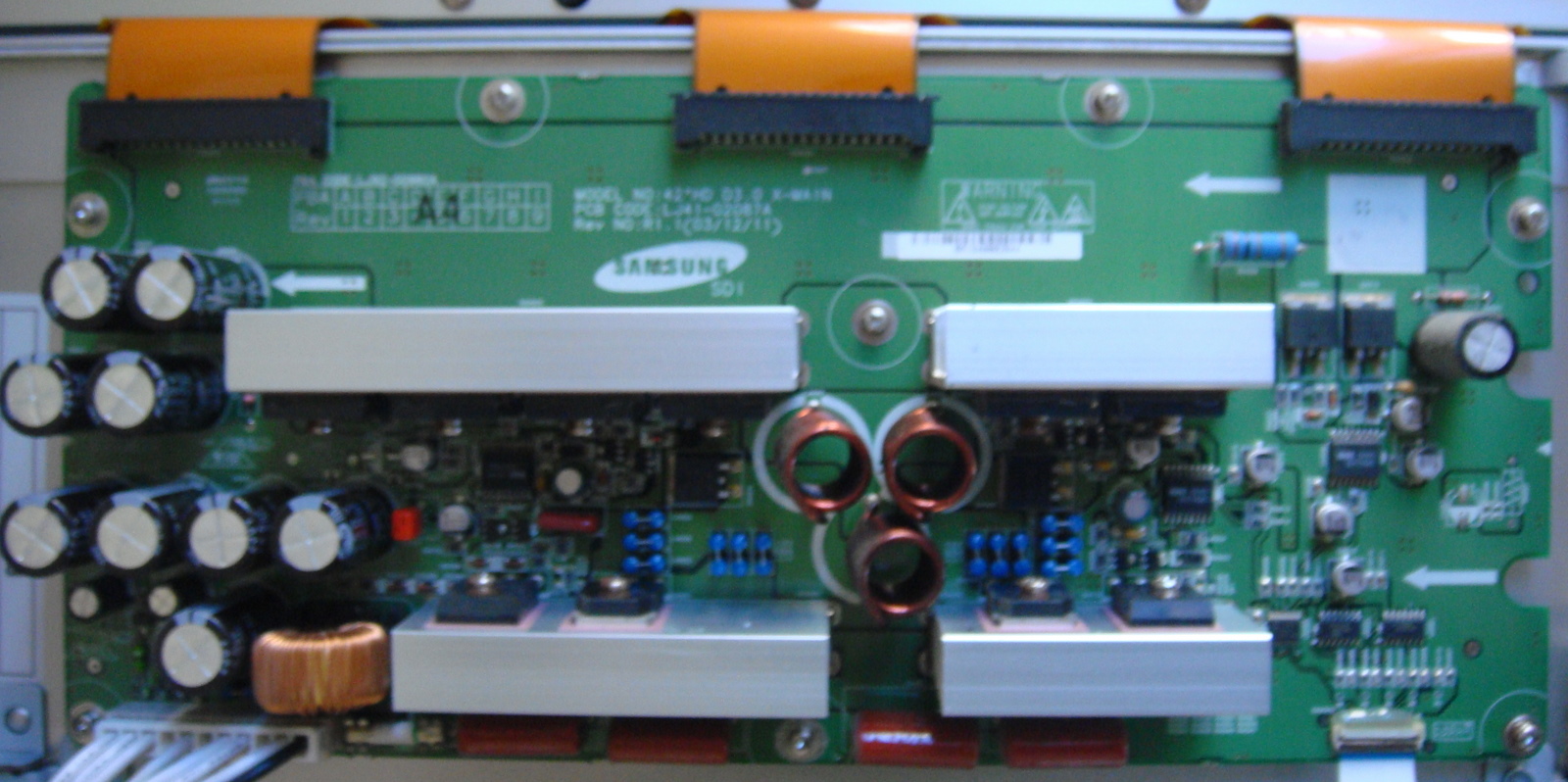

        A common cause of this type of failure is a short on either a sustain board or a buffer board (or both) that overloads the power supply.

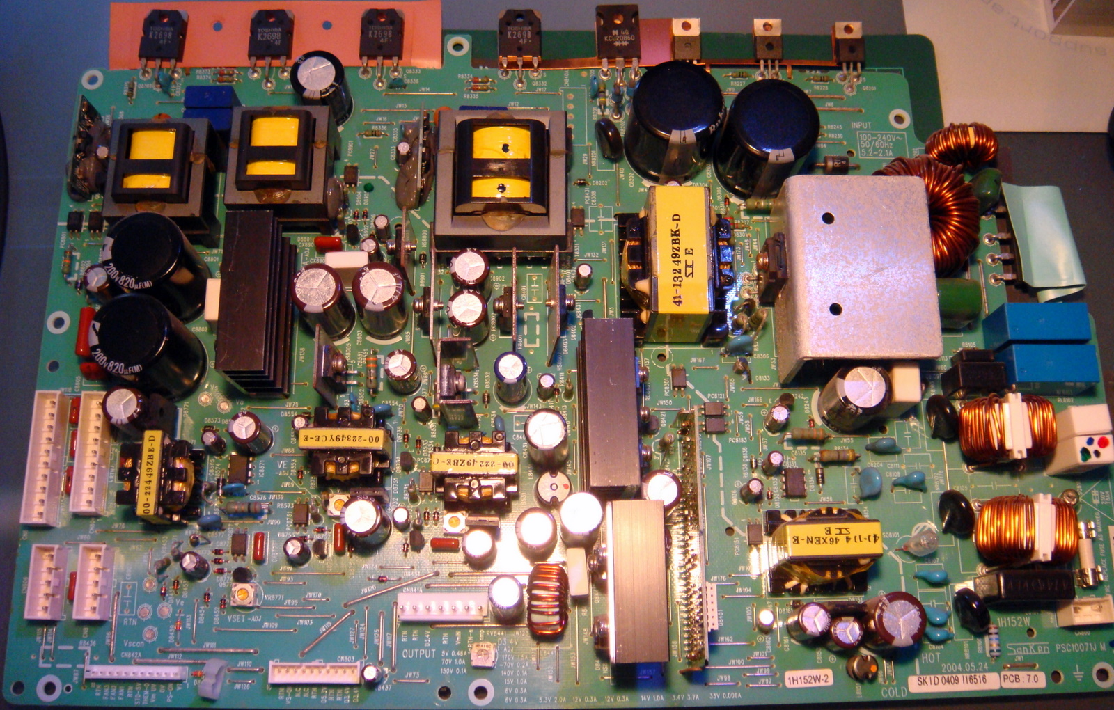

          Wow thanks Gents for the quick reply
          I did check all caps for voltage to make sure they were discharged.
          Found three fuses removed and checked continuity.
          All looked good.
          I am not sure where or how to check for standby and secondary voltages?

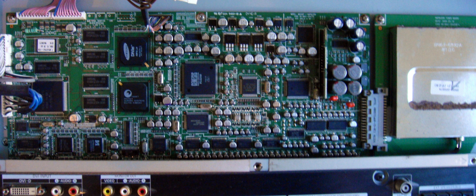

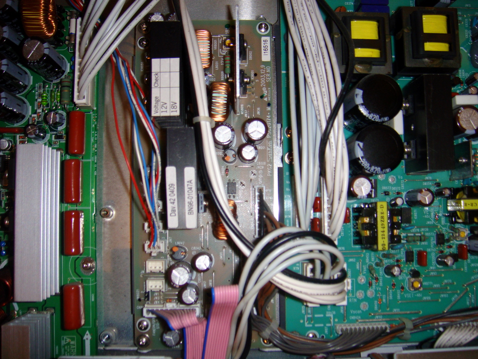

          I have attached several pictures of all of my boards.
          Let me know if you need to see more pictures.
          Also I have set up a picasa web album that has higher resolution images
          Thank you!
          http://picasaweb.google.com/Digital....eat=directlink

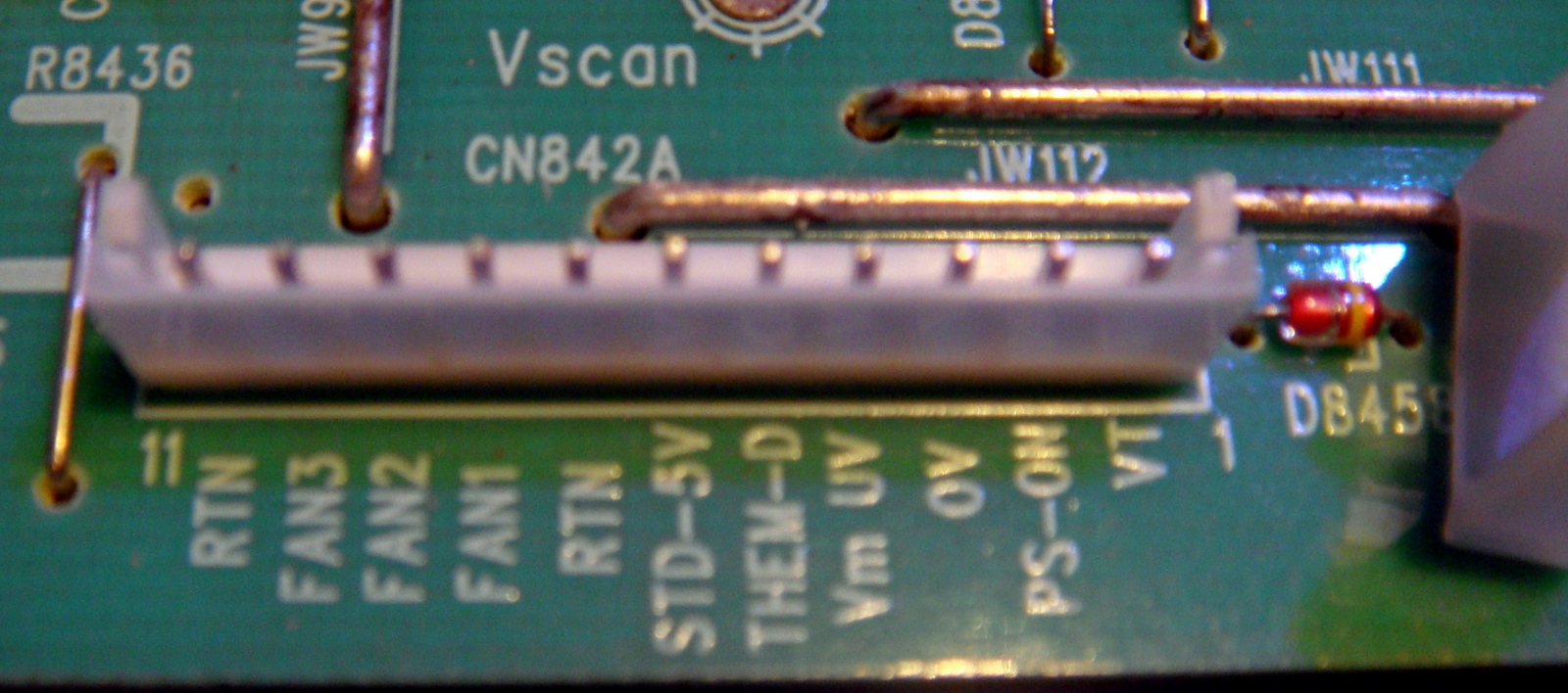

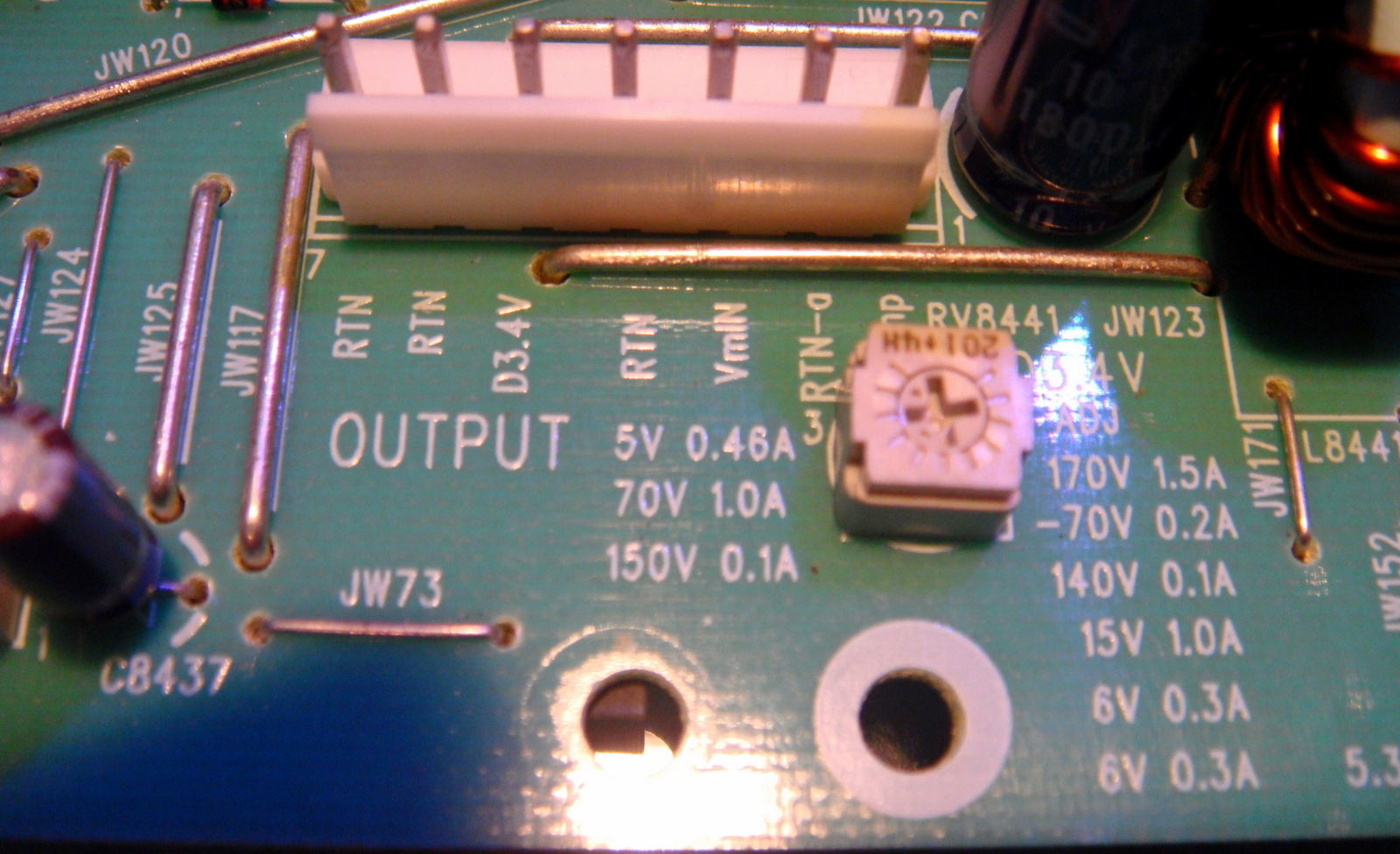

            It looks like CN842A has the connection for STD-5V. This is one of voltages we are interested in.
            Since this is a plasma with very high voltages, I'll let PlainBill describe how to measure for this voltage. I'm 99% sure I can safely describe it, but PlainBill can do it better.
            The logic board is the bottom one with the big Genesis chip on it.

                Very good set of pictures. Retirecaps is right on his description of the test point for 5V standby. That point should be at 5 volts whenever power is applied to the power supply. Measure it to chassis ground, or one of the RTN lines.
                One point. Terminology is tricky on these. If you look at the long board with the Genesis chip you will see a small cable coming out the top and going behind it. The long board is the main control board, main board, or Small Signal Board, and possibly other names. The cable is the video output and goes to the main logic board. The main logic board takes the video signal and routes it to the various X, Y, and Z boards.
                PlainBill

                    Checked the fuses again all are about .35 ohms.
                    Couldn't find anymore.
                    Checked for voltage at the CN842A test point. But there was none.
                    I tested it using several screws as ground, an RTN point near CN842A and some of the RTN points in a couple of the plugs.
                    I thought the relay was kicking on and off but, it only clicks on once then shuts off.
                    Let me know where to head next.
                    Thanks for the advice

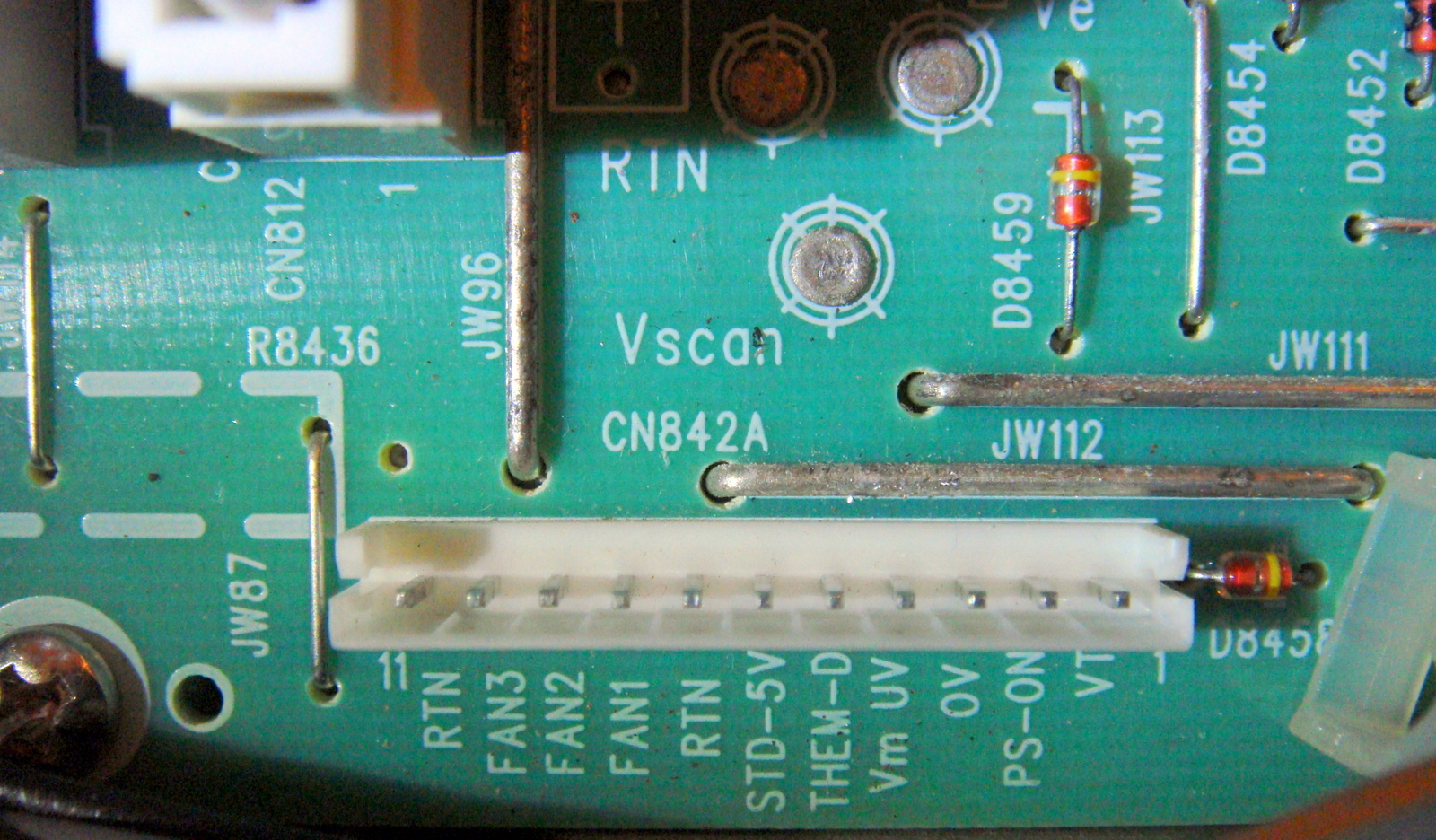

                      Ok did some more checking.
                      I think I was checking at the wrong place.
                      I checked at the bar where the CN842A was writing on the board.
                      There is not any voltage there.
                      But I looked around and the connector and realized it said STD-5V.
                      I couldn't see it with the plug in.
                      So with the connector plug in I checked the votagle in the connector and there was a solid 5V there.

                        That's as expected. And the fact that the relay clicks indicates that the power supply is being turned on. The next step would be to check the other output voltages. Since the relay clicks only once (and then presumably opens), it's not likely you will be able to get a stable reading, but it will be good to know if none of the other outputs come up, some of them come up, or (best of all), all but one come up.

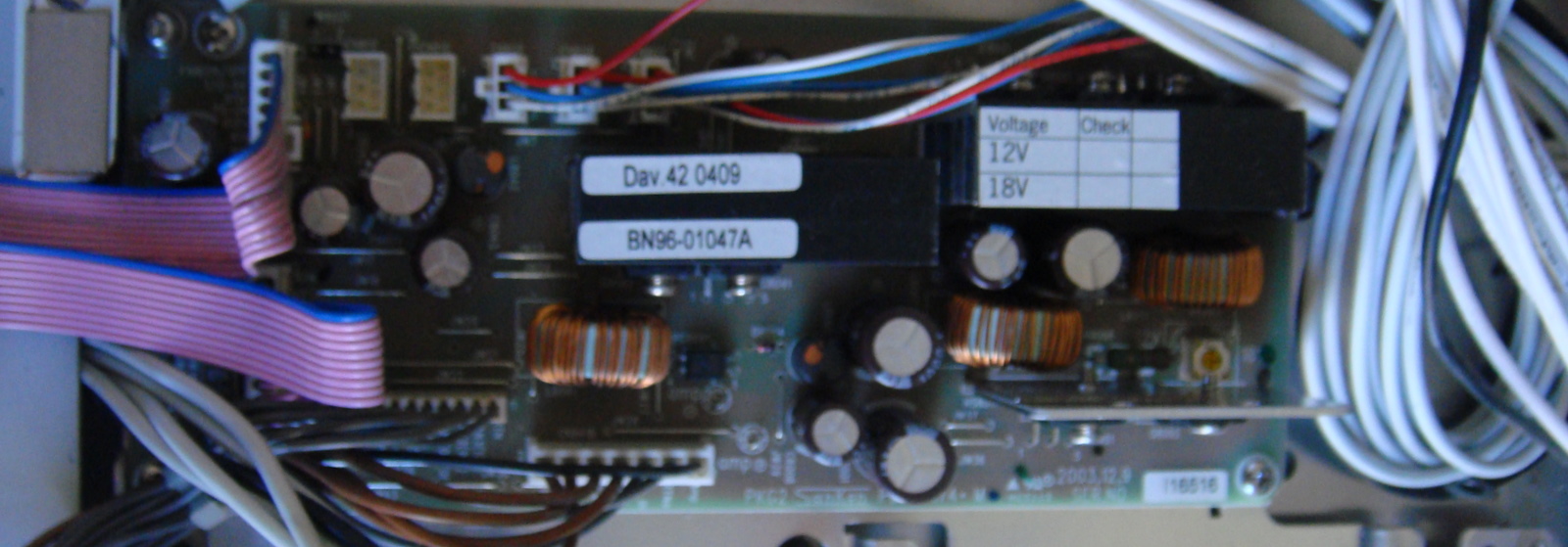

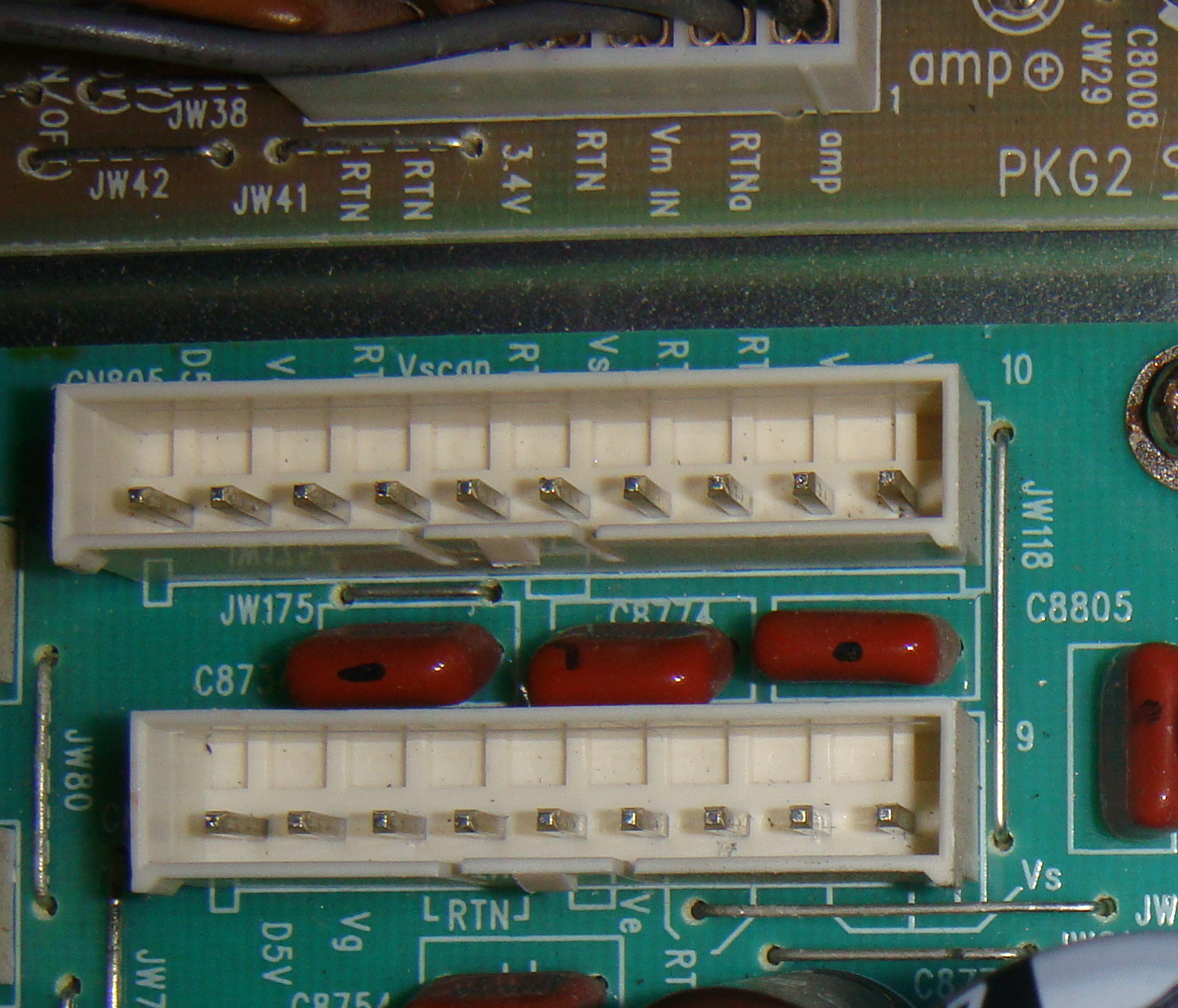

                                  As you indicated, a service manual would be a big help. It appears this TV has a main supply (big green board almost smack-dab in the middle) and an auxiliary supply just to the left of it (tight tan board). There is a white label near the upper right corner of the panel. It lists a number of voltage identifiers (Va, Vs, etc). These voltages go to the Y (left side) and Z (right side) sustain cards. Check those voltages. Again, they would only be present for the time between the first relay click and the second.
                                  It APPEARS the power supply is working, at least in part, but the main controller (small signal board) is detecting an error and shutting the power supply down. The fact you have to unplug power for a minute or two is normal. Once it detects a fault and shuts down the main supply it ignores all attempts to turn the supply back on until the power is reset by unplugging it.

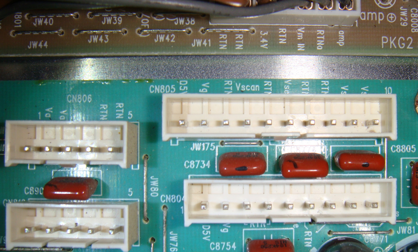

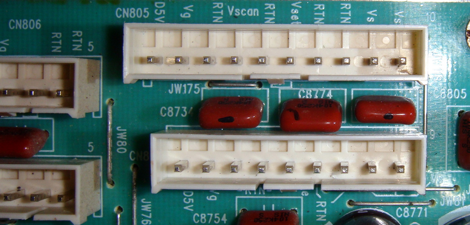

                                    My Label Says (see attached pic)
                                    VA Vsc VS Ve Vset
                                    70 -60 170 160 157
                                    I measured all votages on all of my power supply connectors on both the main
                                    Power Board and the little one to the left.
                                    Sorry for the long post.
                                    Voltages
                                    Main Power Board
                                    CN805 (Left)
                                    VS 2.4
                                    VS 2.1
                                    RTN
                                    RTN
                                    VSet 0
                                    RTN
                                    VScan 0
                                    RTN
                                    Vg 15
                                    D5v 5.3
                                    CN804 (Right
                                    VS 2.8
                                    VS 2.8
                                    RTN
                                    RTN
                                    Ve 2.6
                                    RTN
                                    Vg 15
                                    D5v 5.3
                                    CN806 (Left)[/B]
                                    5 0
                                    RTN
                                    RTN
                                    Va 0
                                    Va1 0
                                    CN812 (Right)
                                    5 0
                                    RTN
                                    RTN
                                    Va 0
                                    Va1 0
                                    CN842A
                                    RTN
                                    Fan3 0
                                    Fan2 0
                                    Fan1 0
                                    RTN
                                    STD-5v 5
                                    Them-D .04
                                    Vm-UV .27
                                    oV 5.4
                                    PS-ON 3.3 when unplugged .5 plugged in
                                    VT 33
                                    CN841A
                                    RTN
                                    RTN
                                    D3.4v 3.38
                                    RTN
                                    VmIN 16.7
                                    RTNa 0
                                    Amp 21.6
                                    CN803
                                    RTN
                                    VS-ON 0
                                    N.C 0
                                    N.C 0
                                    RTN
                                    D5.3v 5.3
                                    RTN
                                    RTN
                                    D3.4v 3.38
                                    D3.4V 3.38

                                    CN801
                                    RTN
                                    VT 33
                                    RTa 0
                                    RTa 0
                                    amp 18.3
                                    amp 18.3
                                    RTN
                                    A12V 12
                                    RTN
                                    A6V 6
                                    CN802
                                    Fan on/off 3.34
                                    Std-5V 5
                                    RTN
                                    PS-ON 2.78 unplugged / 0 plugged in
                                    D12V 12
                                    RTN
                                    RTN
                                    3.4v 3.38
                                    3.4V 3.38
                                    RTN
                                    D6V 6

                                        The second to the bottom pin on the 9 Pin connector (CN804) is labeled Vg.
                                        Pressing power button does not make difference on any test
                                        Step 2. = 15V
                                        Step 5. X Drivers unplugged = 15V
                                        Step 8. Z Sustain unplugged = 15V
                                        Step 11. Y Sustain unplugged = 15V
                                        The Top Two pins on the 9 Pin connector (CN804) are labeled VS
                                        Tested both pins and they were the same on all tests.
                                        Pressing power button does not make difference on any test.
                                        Step 2. = 2.8V
                                        Step 5. X Drivers unplugged = 2.8V
                                        Step 8. Z Sustain unplugged = 1.7V
                                        Step 11. Y Sustain unplugged = .7v
                                        The second to Last pin on the right Z Driver connector (CN812) is VA
                                        It was 0v on all tests.
                                        I have included better pictures of the CN804,CN805,CN806,CN812 connectors
                                        CN805 Left 10 pin Y Sustain
                                        CN804 Right 9 Pin X Sustain
                                        CN 806 Left X Driver
                                        CN812 Right X Driver
                                        You can also find more images in my picasa album at higher res.
                                        Thanks for your help Hope I gave you what you needed to know
