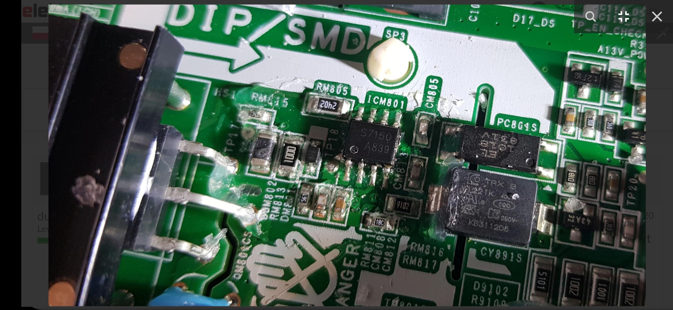

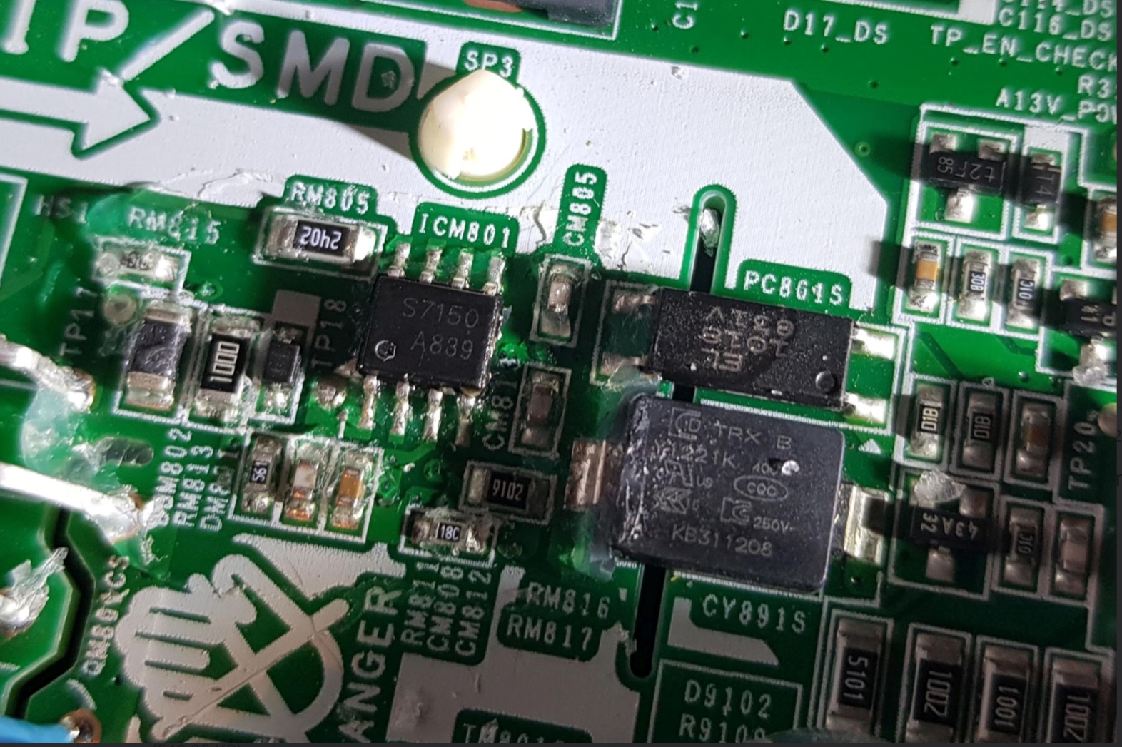

    This single board tv has smps blown. Need Icm801 marked as S7150 but don't know its proper part number.
    Any help pls?

    Re: Samsung UE32N4002AK ICM801 S7150 identification
    S7150 - SEM7150
    https://aliexpress.ru/item/100500433...45fb26dfA71Hmt
        I'm sure you have tested fet and gate resistors, diodes etc.
          Yes i have checked.
          I am looking for datasheet for Sem7150 (S7150) or better still service manual of this tv.
