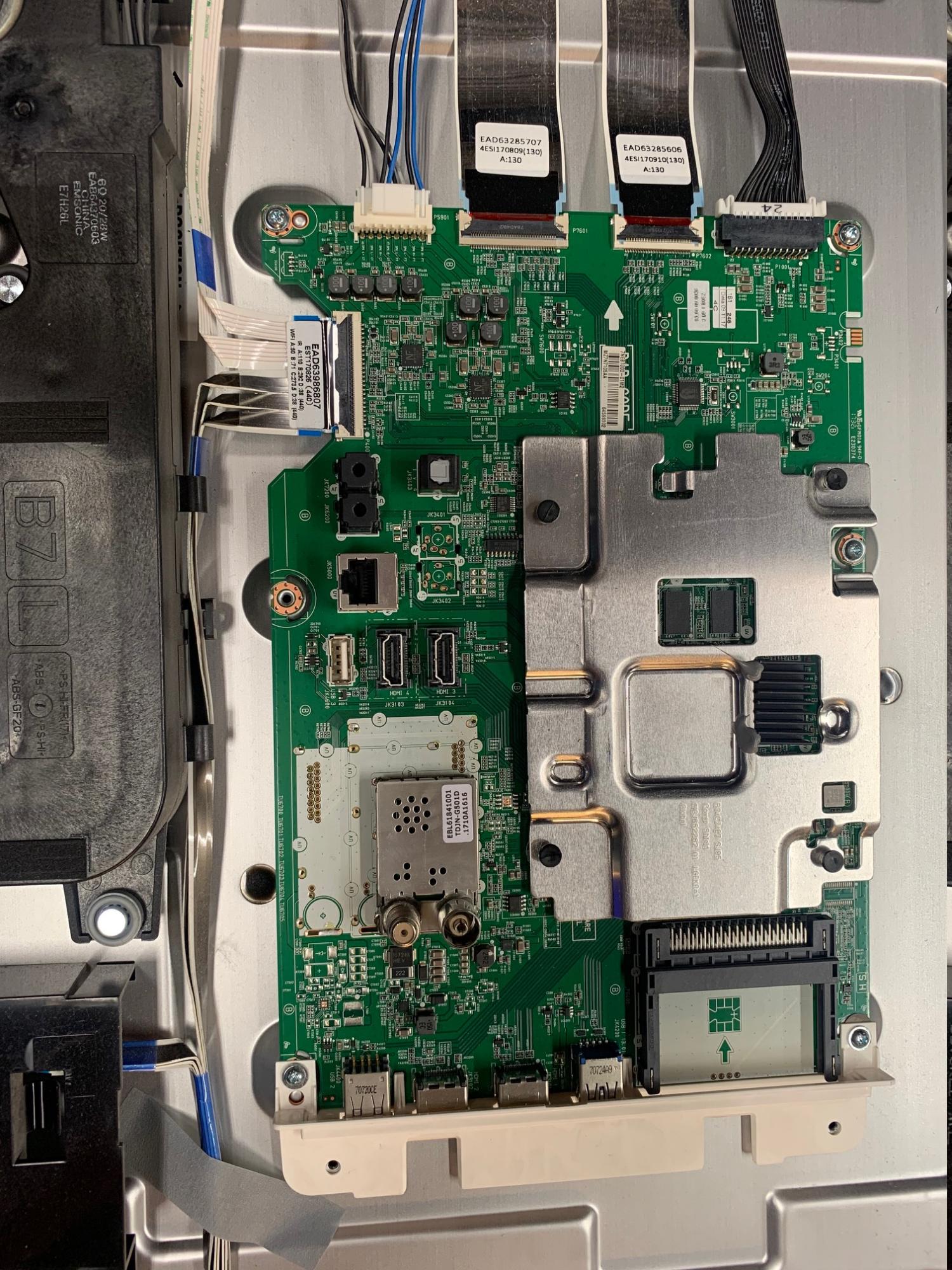

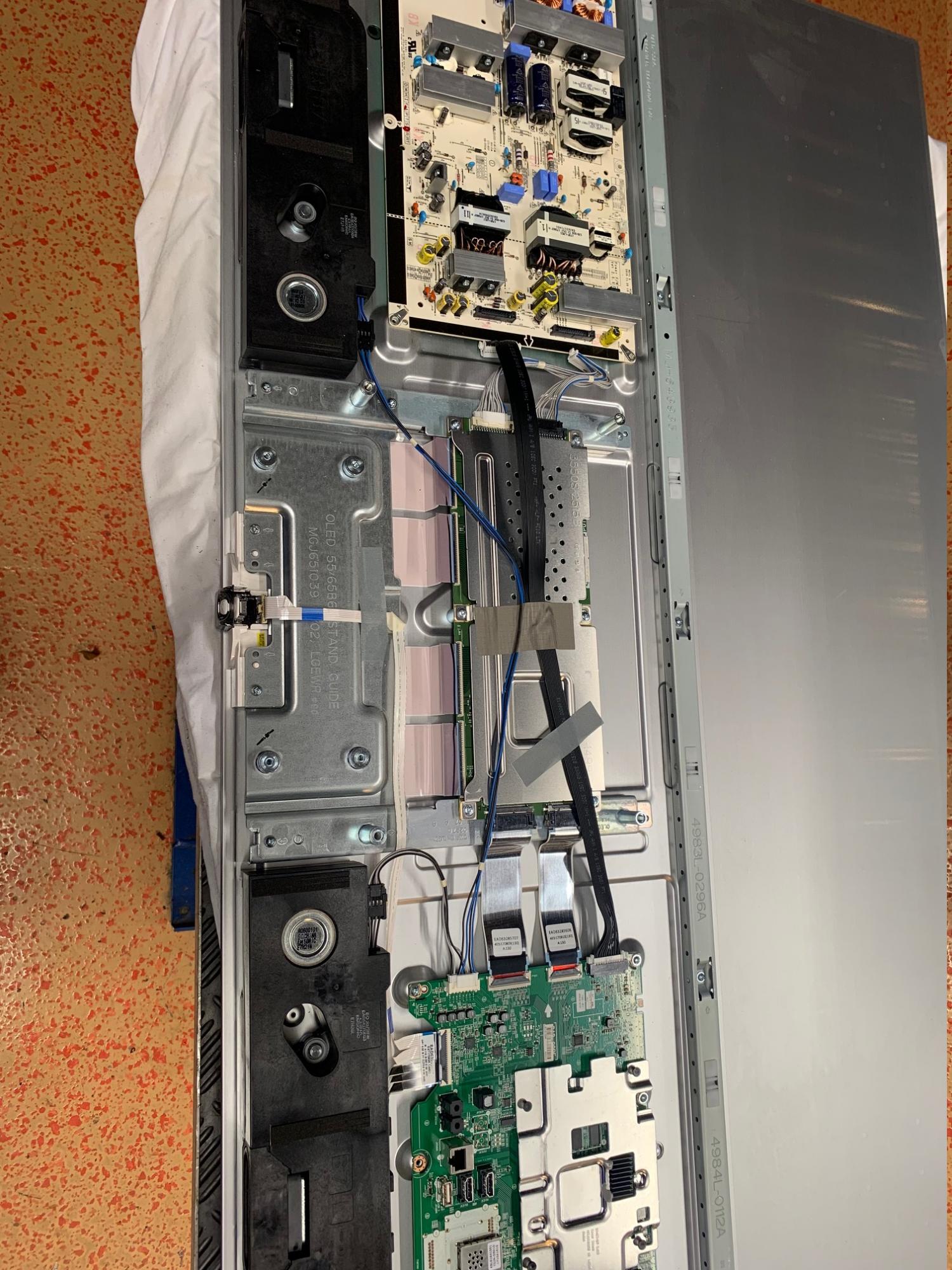

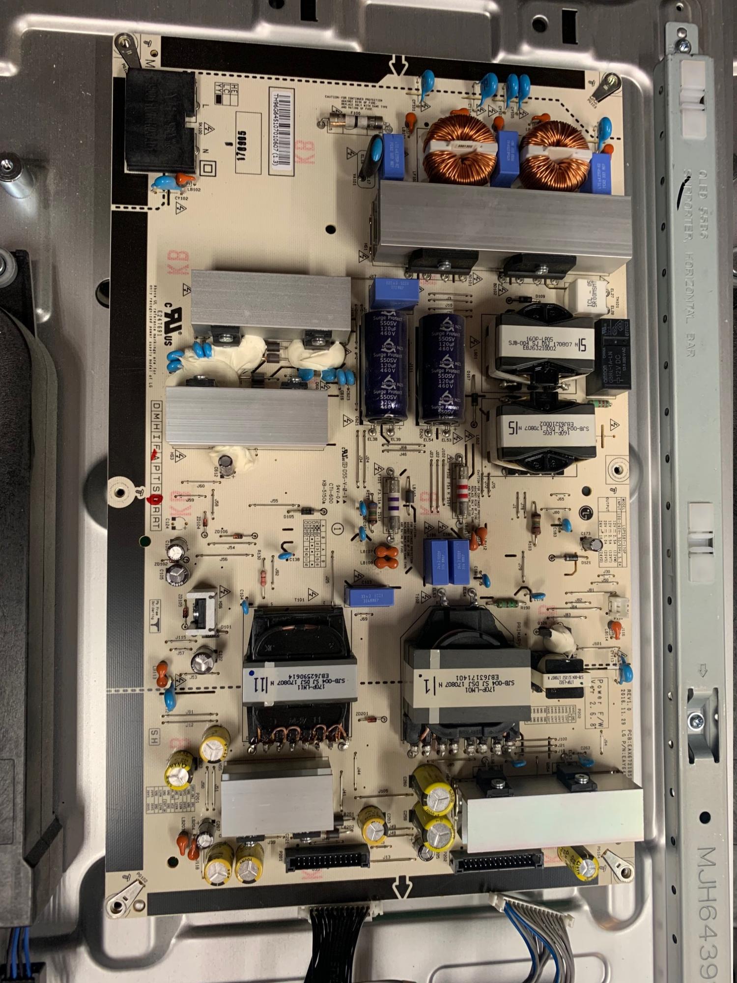

    LG OLED 55B7V does not start
    LG OLED 55B7V respond to power-on button, PSU goes on for a second then stops.
    No sign of picture nor sound.
    Any advice?
    The PSU has two main outputs. One +12V and one +24V. The 12V supply is running for like 5 seconds, and the +24V output shuts off after a second.
    If disconnecting the loads, the voltages stays on both of them, until the diagnostics turns off the PSU.
    Sourcing the +24V continously from external PSU does not change behaviour.
    Thanks in advance!

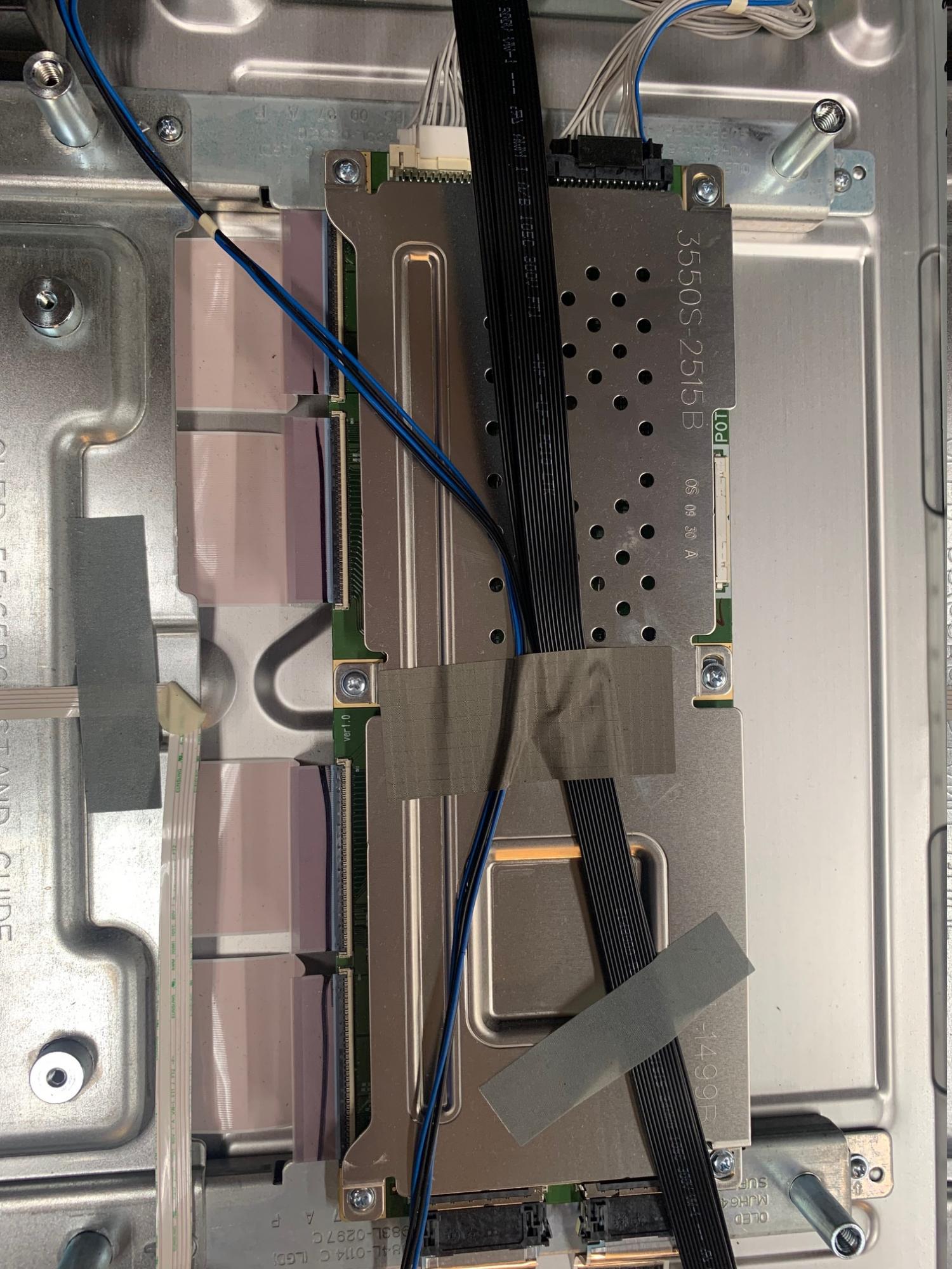

    using external source for 24V panel driver boards a big mistake..
    put every things as original in place .. only the socket 24V from psu to T-CON driver boards disconnect it from PSU side and turn on.. let yours eyes on the Audio optic port on MB if it lit red and for how long.
    • PowerAmpFreak
      • 982
      • Sweden
      Re: LG OLED 55B7V does not start
      When I turn on the set without the 24V connector from PSU side connected, the optical port stays on for 10 seconds.
      EDIT: Found the issue - a shorted ceramic 10uF cap on the T-CON board. Now it works!

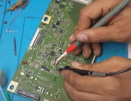

          I started off by checking the youtube vid below:
          https://www.youtube.com/watch?v=WHjJpT77jpY
          14:08 in the vid he probes resistance across a voltage converter MLCC bank.
          In my case I could see a small crack in the cap so I did not need to go for current injection and thermal camera method.
          Also attach a screenshot of area from vid.

            common man... from his hand color and the T-CON under his hand... its not OLED and Asian famous with fake.. they caused fault and then they cliam repair or issue found LOL
