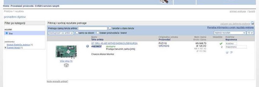

                  There is Aswo in Croatia. Is there a specialist dealer for spare parts in your city? At ASWO there is a mainboard for G7 Chassis and your panel below 10 euros. Manufacturer number PVZ110.

                      #50
                      Re: Grundig 49 VLE 420 BN - no picture
                      Today I got answer from ASWO.
                      Price for this mainboard is over 157 EUR, little to much.
                        #51
                        Of course, the other Main can be defective.
                        I'll send you a picture of Aswo.
                        LG Thomas

                          I stil have price of 157,56 EUR at ASWO.
                          I bought complete tv with broken screen for about 25 EUR, all other working, so I was told.
                          I am waiting to receive it, maybe next week and then I will try with those parts.
