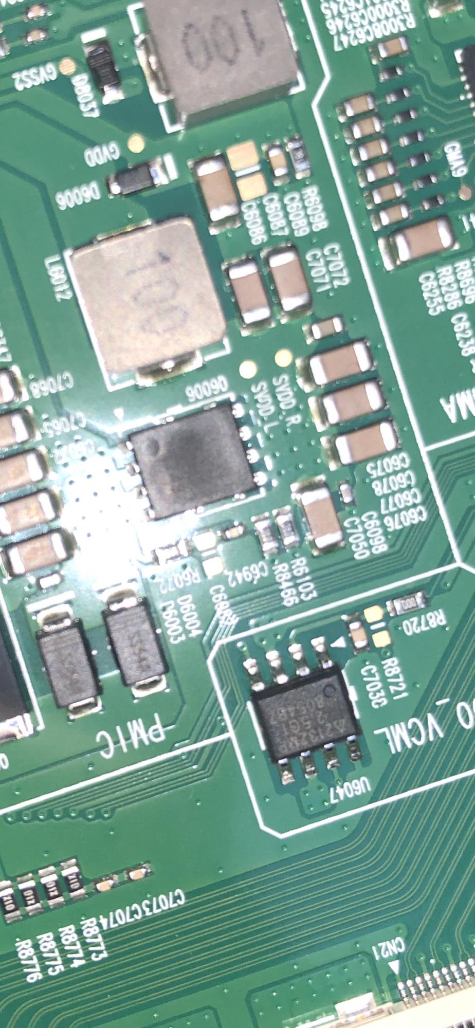

                      Problem just came back today..
                      I took the t-con out of the tv today and looked for short circuits on the board with my multimeter. All of the capacitors on DVDD09_CORE have a short to ground, I couldn‘t locate it.
                      The fuses on t-con are good.
                      Q6006 in the PMIC section does look a little bit weird too, maybe burned? it‘s not melted or something, but the surface is much darker and matte in the middle, it‘s not fingerprint or oil. I made a picture of it, not the best but I hope you can see what I mean. I can‘t read the model number on it, if I knew what chip I would measure it to make sure it‘s ok or not.
                      Should I buy the bundle and maybe try with new parts?

                        maybe 05.30.25 had same level firmware so the fault remain the same... so try downgrade to early firmware 4.xxx so we will be sure the micom version will definitely written. the version you can see at in_start or also az_adj.
