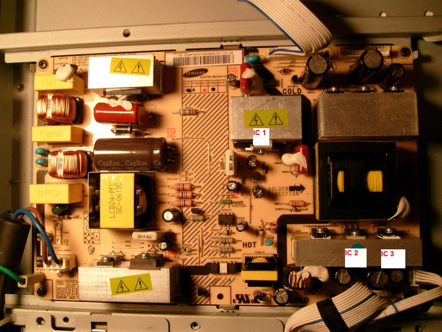

              Hope the attached pic is helpful.
              IC 1 is a F9222L; designated as ICM801S on the PCB.
              IC 2 is a MC33167T; designated as ICM852 on the PCB.
              IC 3 is a KIA278; designated as ICM853 on the PCB.
              I am still uncertain as to what is meant by a "linear regulator"!
              Maybe some other term by which it is known?

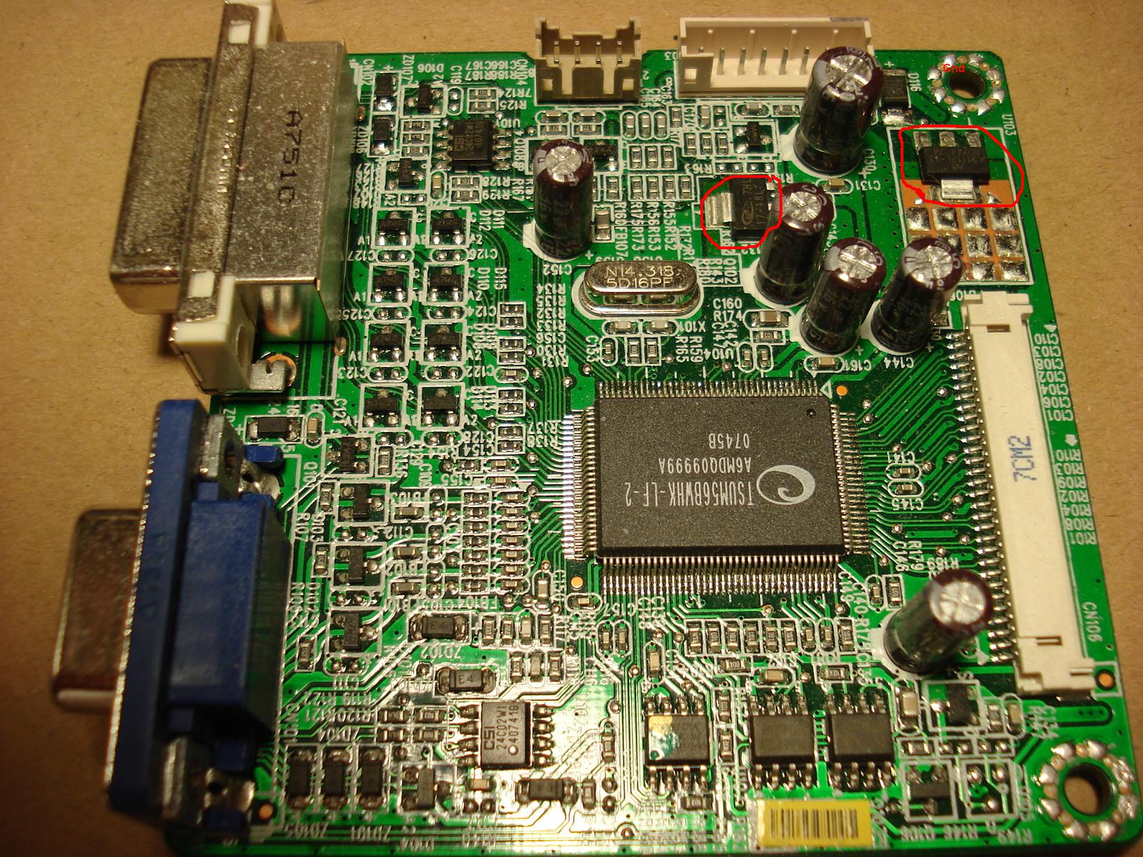

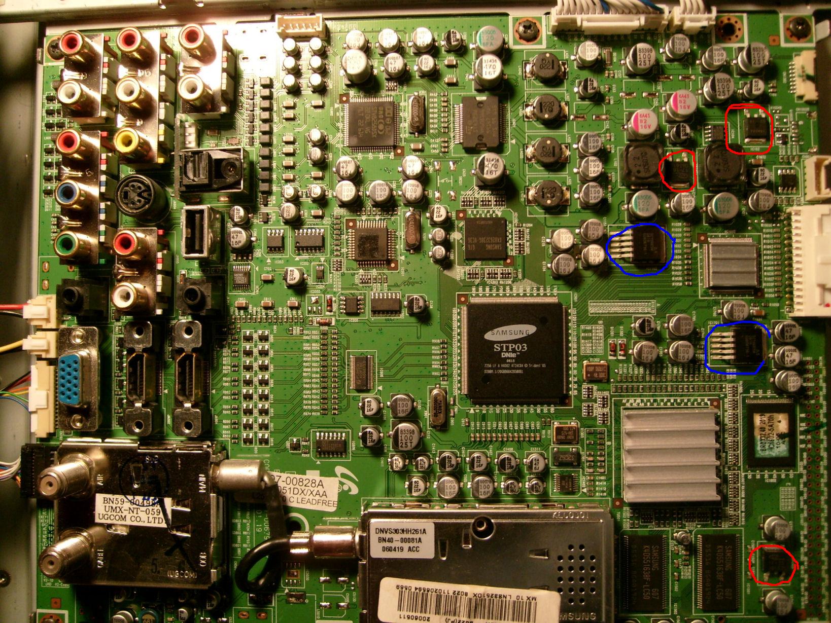

                  Those aren't the ones possibly responsible. On the main pc board and probably on the tcon board are three or four pin regulators. One of these is responsible.
                  I've circled two of them in the attached picture.While this is the logic board from a monitor, it should give you an idea of what you are looking for.
                  PlainBill

                      Not on power board. I'm talking about linear regulators on the main board itself.
                      Your power supply is doing fine. I have seen this noise before due to oscillating linear regulator due to bad capacitor or bad regulator itself.

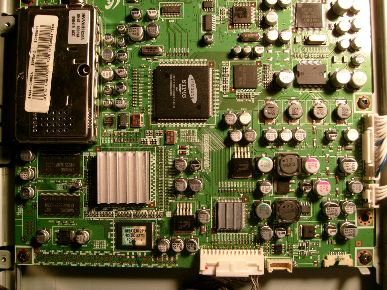

                        • Sam I Am
                          • Jun 2010
                          • 115
                          #32
                          Re: Samsung LN-S3251D

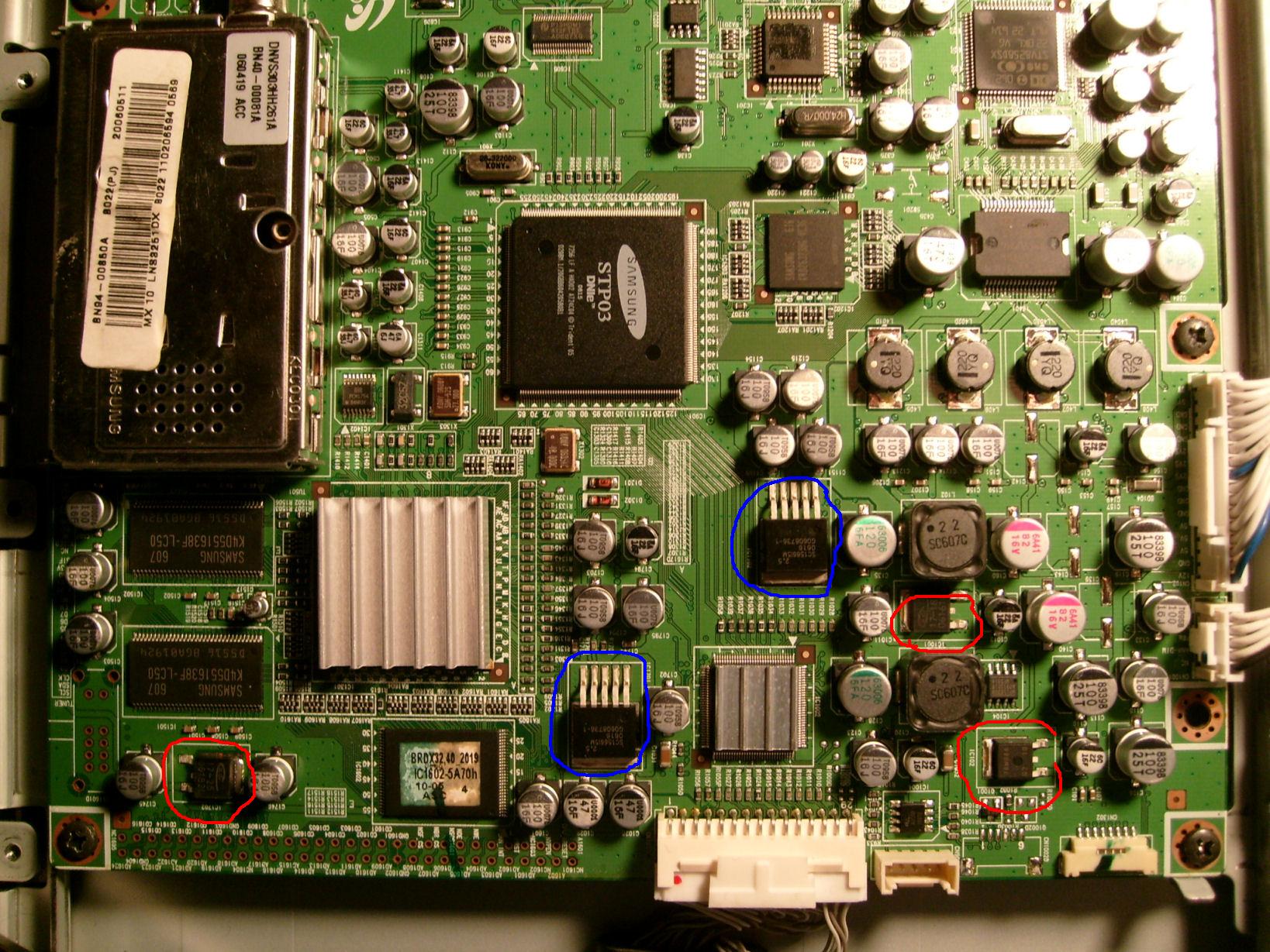

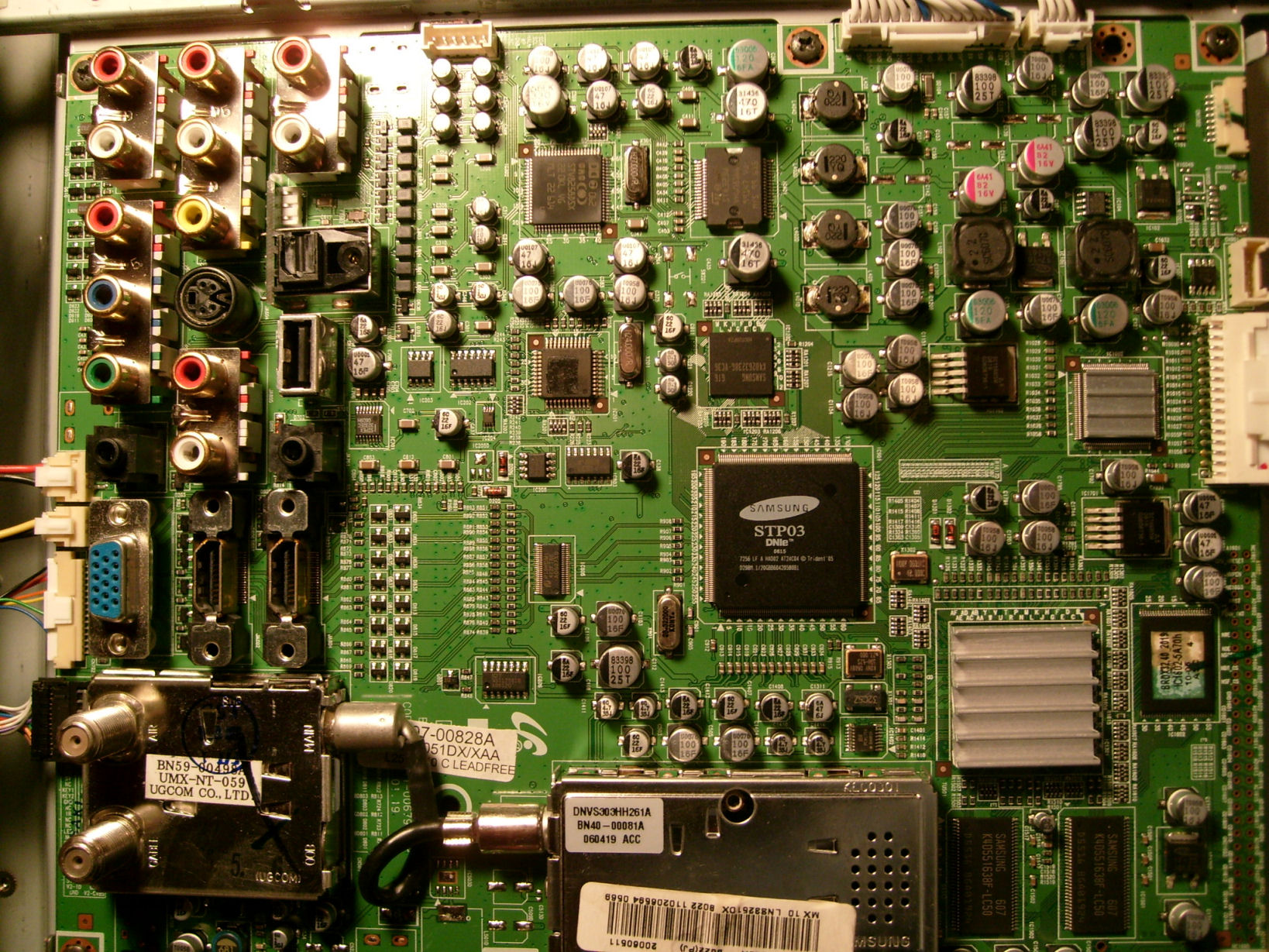

                          Sheesh.... That info would have been nice to have earlier as it is readily obvious I did not have a clue on which board I should be looking.
                          Here are a couple of pics of the main board.
                          Thanks in advance for everyone's assistance.
                          • el3ctroded
                            • Nov 2008
                            • 198
                            #33
                            To the right of the big black chip STP03 is a 5-legged surface mount part. There's another one nearby. Those are LDO Linear regulators.
                            Check all the caps in this area for high ESR. Using your scope, set it a 1V/div and 1ms/div. Now Check Pin 4 for output voltage. Pin 1 is the one on the same side as the text is justified at.

                            • PlainBill
                              • Feb 2009
                              • 7034
                              #34
                              Red circle - primary candidate
                              Blue circle - less likely, probably a switcher.
                              Part numbers will help us give you more information.

                                #35
                                Yep, the red circles are the one I was talking about. They are SC1565 LDO regulators, with pin4 as the output.
                                Here is the datasheet for them:
                                Edit typo

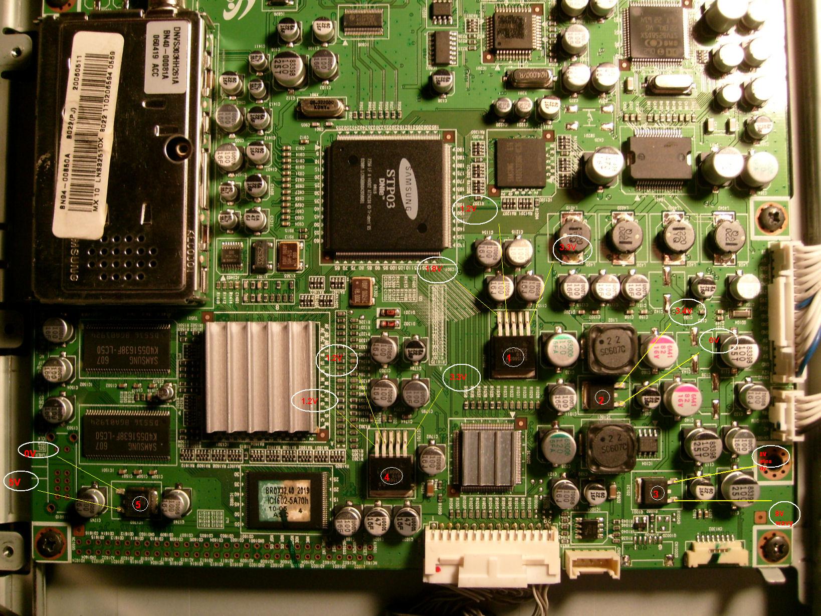

                                  Aside from probe issues and equipment failure, I can finally get back on this set....
                                  The "five leggers" are SC1566's and if I am reading this scope right @ 1V/div and 1ms/div., Pin #1 is 3.3V while Pin #4 is 1.2V on both LDO's. In addition, ESR readings of all caps within the immediate vicinity are anywhere from .49 - 1.8.
                                  The most frustrating part is for the last day or so I have been unsuccessful in acquiring a distinct signal pattern. I tired of seeing this #%$@&! "flat line".
                                  More than likely its operator ERROR.
                                  Soooo..... until I can figure that out......

                                    Well, flat line is the correct thing for reading DC voltage However you would want to adjust the time/div looking for excessive noise in the voltage rail or look for oscillation in the dc.
                                    1.8ohms seems a little high to me.

                                        You are in the right area, but I suspect your technique is wrong. Use AC coupling on the input (check the output voltage with a DMM first), then increase the sensitivity until you start seeing a waveform, even if it's nothing but noise.
                                        I'm not sure, but it also looks like there are more regulators on that board.

                                          Attached is a pic of the latest readings.
                                          #1 and #4 are SC156615M 2.5 LDO Regulators. (scope set @ 1 and 1)
                                          #2 (17-18 06161L) and #5 (17-25 06182L) are what I believe to be LDO Regulator's. (scope set @ 5 and 1)
                                          #3 (78M08A G2 1B) is what I believe to be another type of regulator showing a steady 8V on the input and a very, very, very short wavy 8V (1V PtP) on the output. (scope set @ 5 and 1)
                                          I am unable to locate any type of data-sheets on #2, 3, & 5.
                                          AC or DC coupling seems to make little difference in the readings.
                                          Next steps please....
