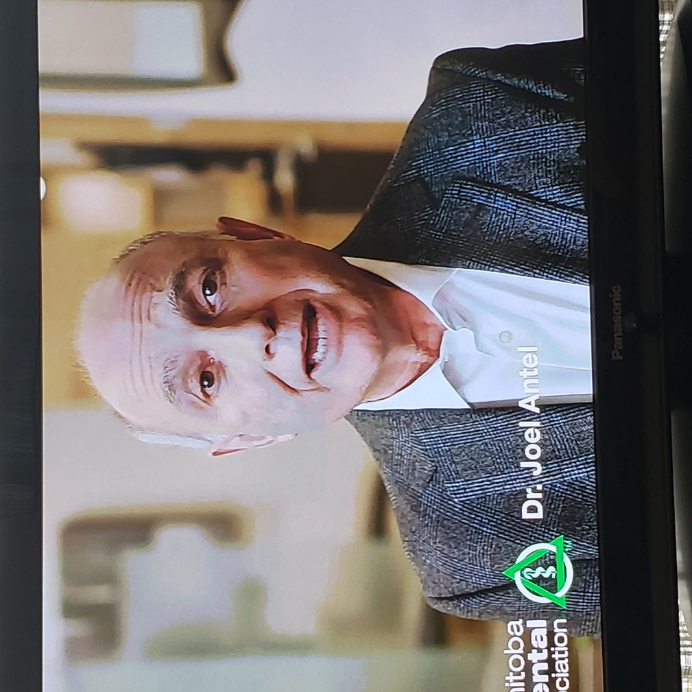

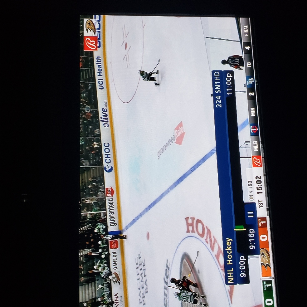

    Panasonic TH-42PZ77U blue clouding on white screen
    Hi, I just started having an issue with my plasma. If watching say a hockey game with white ice I get floating blue tinting on the white. I also noticed on peoples faces there are grey patches over their skin tones. I can also see the front panel grid board outlines in the patch areas. I'm wondering if it's the D board as the issue is more pronounced in the center of panel but covers the whole screen depending on scene.
    The pictures attached don't really show the intensity of what I see.

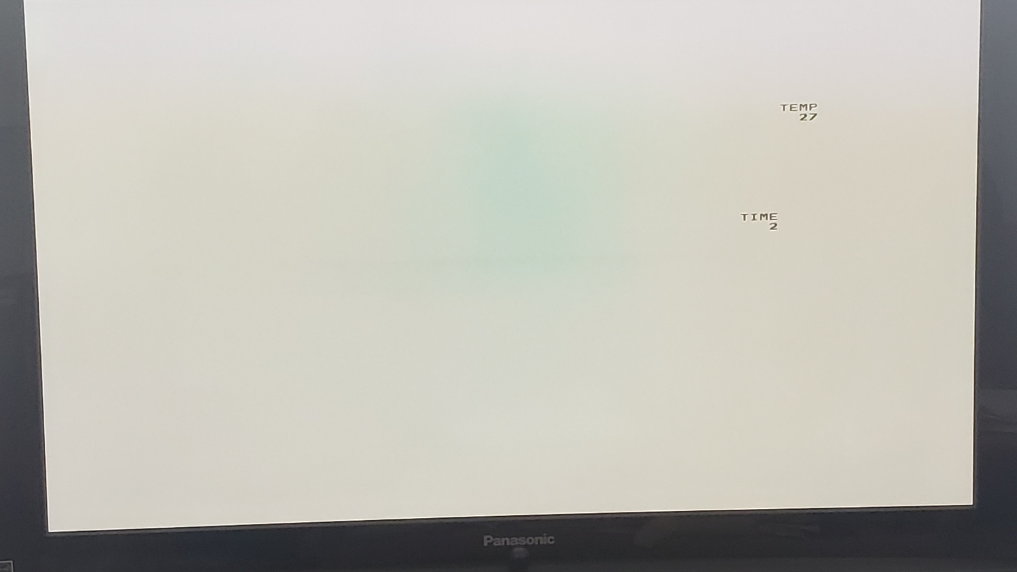

    Re: Panasonic TH-42PZ77U blue clouding on white screen
    Went to test screen mode. White screen shows blueing in center.
      Panel aging, try increasing VSUS(ඞ) in the power supply in incremental small adjustments until it disappears, don't go over 5V of the original value.
      You can also set VSUS in the service menu to "High".
            I'm baack; After multiple days of trying to figure out why changing out the larger 56uf and 68uf capacitors on the D and DG boards would cause a SOS code I found the problem. A minuscule drop of solder welded itself between 2 terminals on the FL304 feedback capacitor on the D board. I decided to change the caps on the D board, with nothing to loose, because unplugging the DG board made no difference to picture quality. Changed out the DG board as well because I had it out. As of now the bluing is gone so I've made adjustments as you've suggested. All adjustments were in spec except TPVSCN. It was 6.34V and my calculations VSCN +148V minus -139V Vad = 9V. I adjusted up to 8.99V. Would you agree with this or would this be too large of a voltage increase that may do harm? I haven't had a hockey game on yet to test white ice for blue patching yet but Picture looks better. Hope it lasts for awhile.
              No one but you could find that tin drop, thankfully it's fixed.
              First tune the voltages according to the panel, what's not on the panel is on the service manual, if the model is the same it's safe. Adjusting voltages is needed only if you swap boards that are from different panel revisions.
