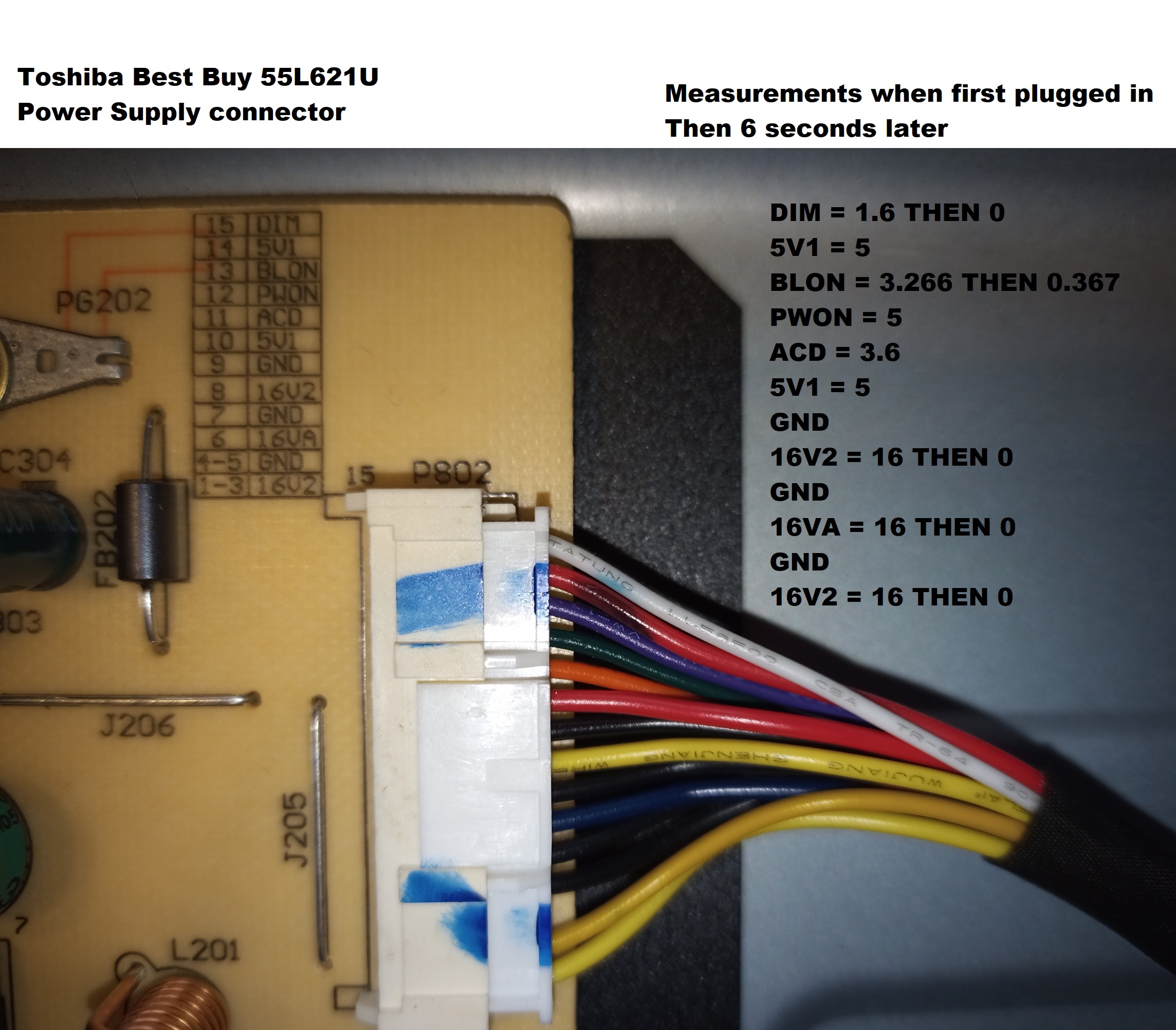

Help with Toshiba (Best Buy) 55L621U
    Help with Toshiba (Best Buy) 55L621U
    My friend dropped off his Toshiba (Best Buy) 55L621U for me to try to fix.
    Here is a list of the measurements I took.
    When first plugged in...
    Toshiba splash screen is displayed then goes away after 6 seconds.
    Power LED blinks 9 times, then goes off after about 45 seconds.
    My friend said the right 1/3rd of the screen was green. I can't keep it powered on long enough to see for myself but the right 1/3rd of the splash screen is dark. Could the panel be bad?
    LEDS on 6 seconds, Voltages on 6 seconds.
    Nothing on flashlight test.
    No response from remote or side panel button.
    No difference with LEDs unplugged.
    Video showing splash screen.
    https://i.imgur.com/hJGyDop.mp4
    Power connector measurements:
    DIM = 1.6 THEN 0
    5V1 = 5
    BLON = 3.266 THEN 0.367
    PWON = 5
    ACD = 3.6
    5V1 = 5
    GND
    16V2 = 16 THEN 0
    GND
    16VA = 16 THEN 0
    GND
    16V2 = 16 THEN 0
    LEDs connector while lit:
    LEDs to ground 135
    LEDs to white outside LED1 = 83.5
    LEDs to white middle LED2 = 72.5
    LEDs to white inner LED3 = 115
    C920 to ground 135 while LEDs on.
    C601 across +/- 402 LEDs on 165 LEDs off.
    Re: Help with Toshiba (Best Buy) 55L621U
    I would say you have a backlight problem.
      Re: Help with Toshiba (Best Buy) 55L621U
      Thanks. You're probably right. I've never run into having bad leds and not being able to see the screen with a flashlight, never had one that shutdown the power supply but no matter, I was getting ready to take the panel out to test the leds and cleaned the screen and once it was wet I noticed a hairline crack right where the dark part of the screen starts. No point taking any screws out and proceeding further.
        Re: Help with Toshiba (Best Buy) 55L621U
        I know it's a old post but look at the right side of the screen it's dark. There's a short In the leds causing a 3rd of the screen which is 4 backlight strips short out and turn off
