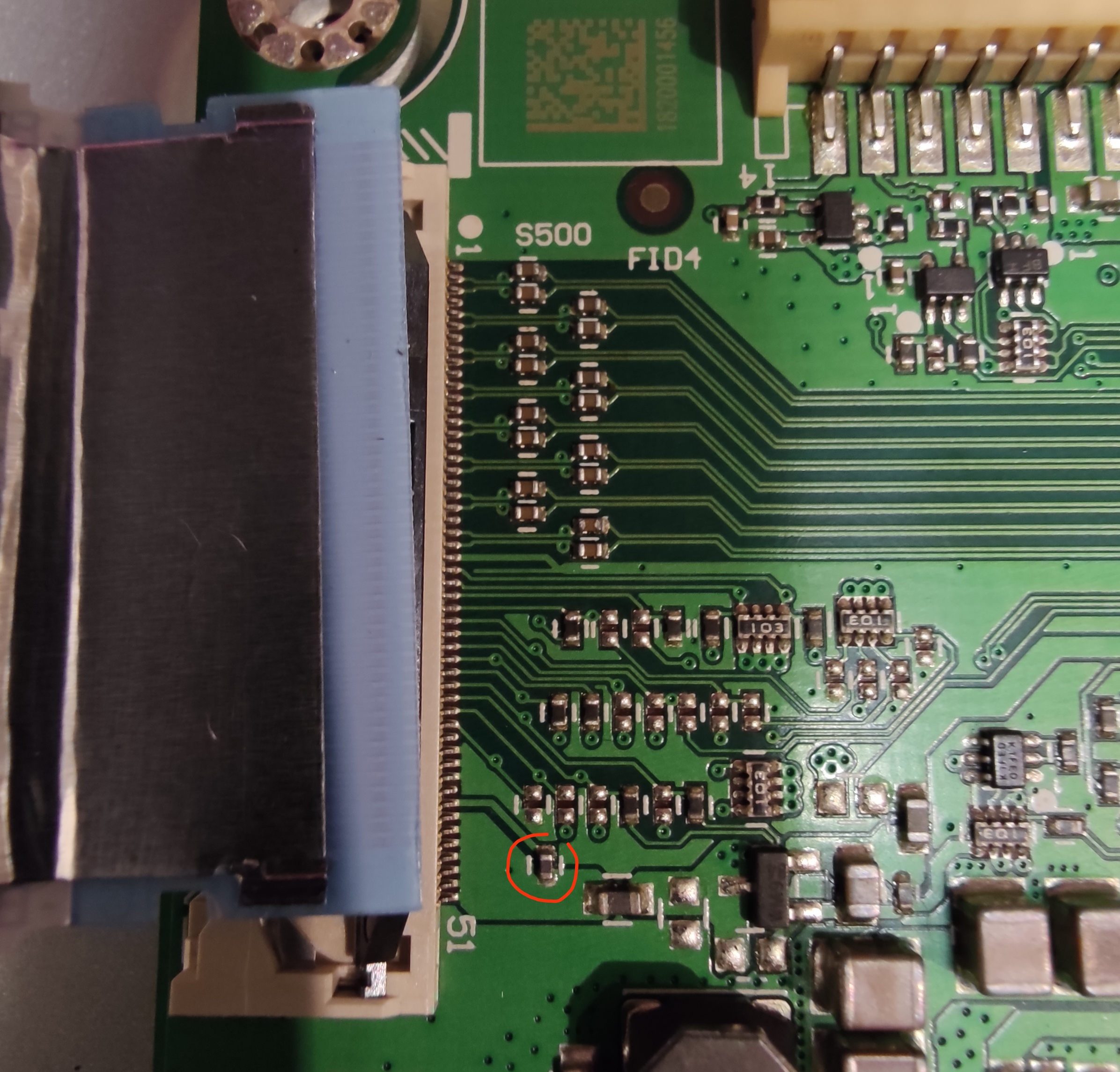

can you measure the reading of the small parts connected to pin 44 ? lvds most disconnected during measurements
I went up until 200°C with the oven and left the board in for 10 minutes.
No change at all and I fear if I go higher the plastic ob the connectors could melt.
200°not enough..in the factory when they apply the soldering pasta first and then the components , it move to the oven which first step 200 then to 310 then back to 150 to the cooling station. t´he worry you have about sockets you can apply kitchen aluminum paper to shape it like cups to cover them. put don't let the paper touch them. this is the packing which i use. beside other method to use Korean in room infrared grill if i want to go only on specification area / chips
Its time to give up unless I find a really cheap mainboard I think.
Thank you for the help, I have now taken it to the point where the mainboard is definetly toast.
I thought it would be smarter to heat up the main chip with a heatgun on low blow setting, while I monitored the chips temperature with an infrared thermometer. Slowly heated it up until the surface reached 250 very briefly, then went down to 190 then let it cool.
That killed it.

what ...??we didn't mentioned at all to use hot air gun.. however if some one read this thread in case using normal hot air gun we should cover the chips and all components around with type to avoid one of them move or flying out. and this what happen now.
