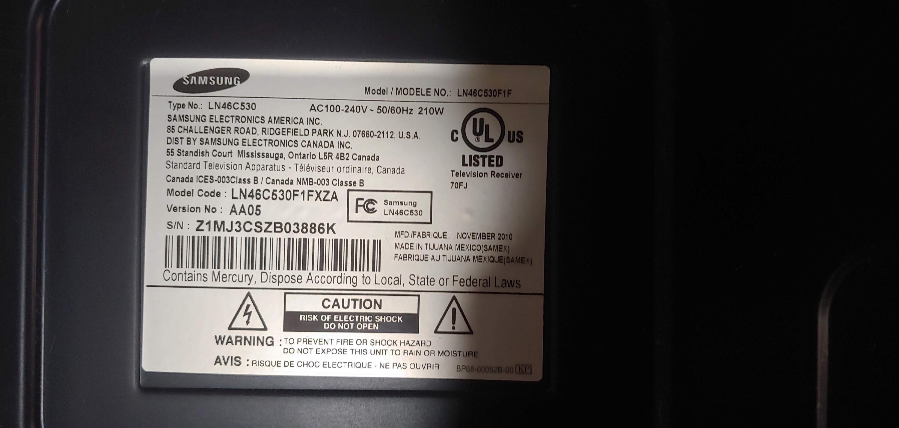

    Samsung LN46C530F1FXZA ⚡ DAMAGE

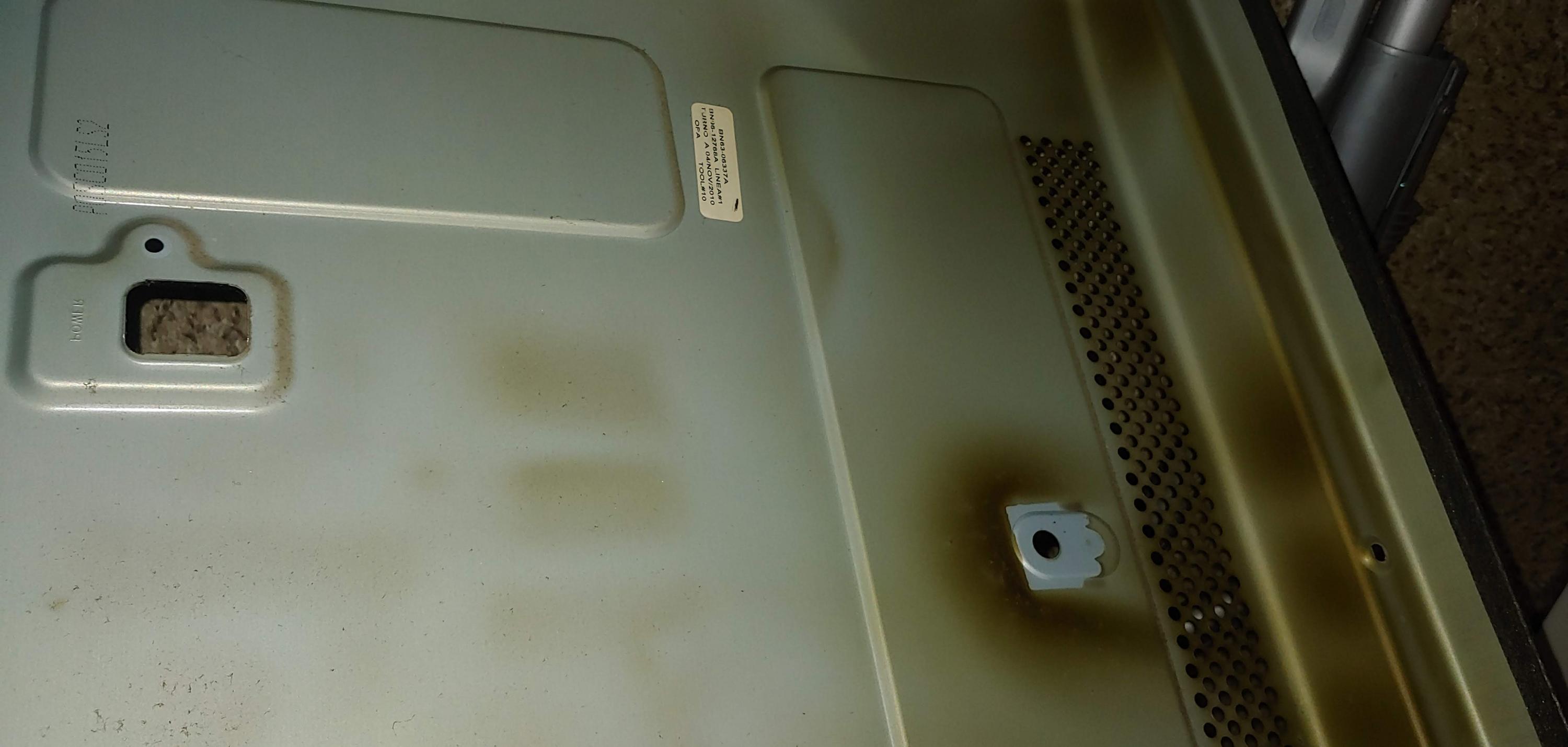

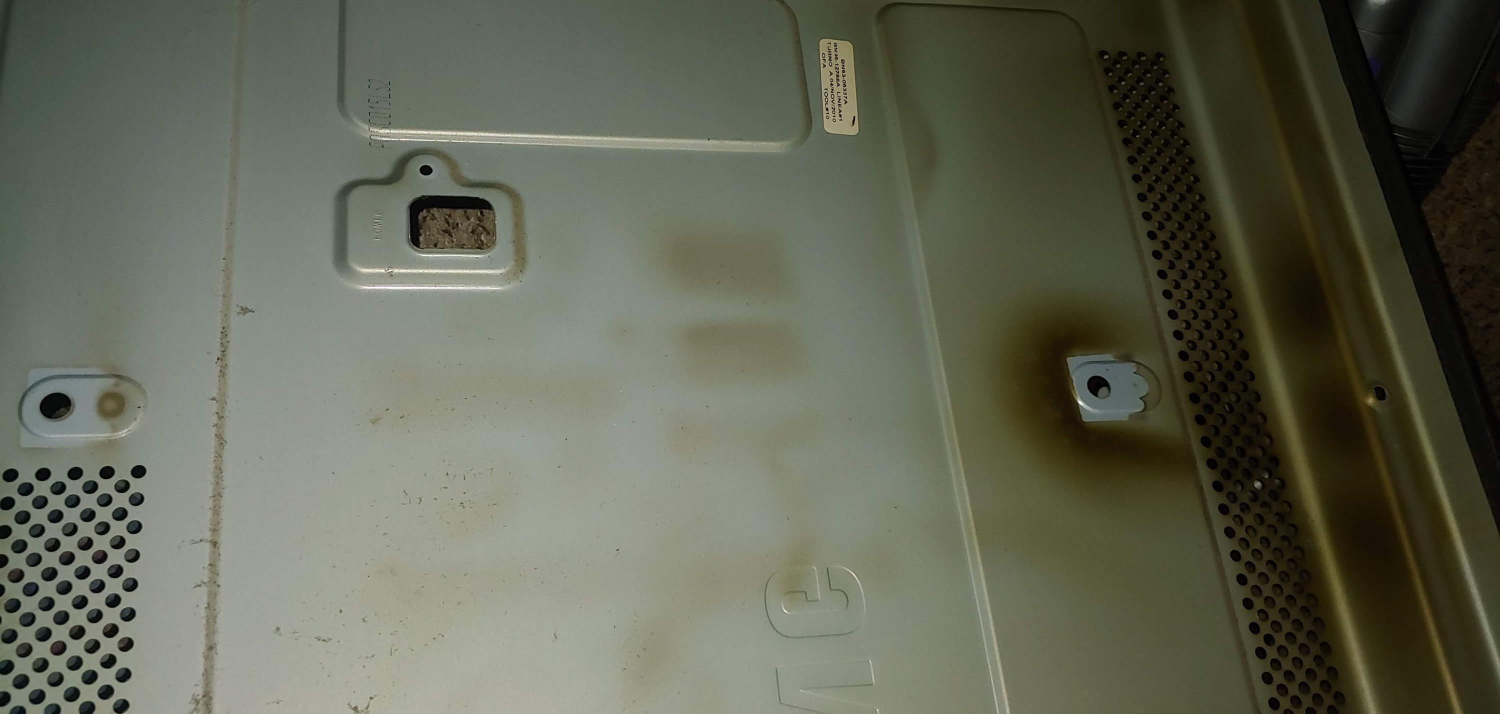

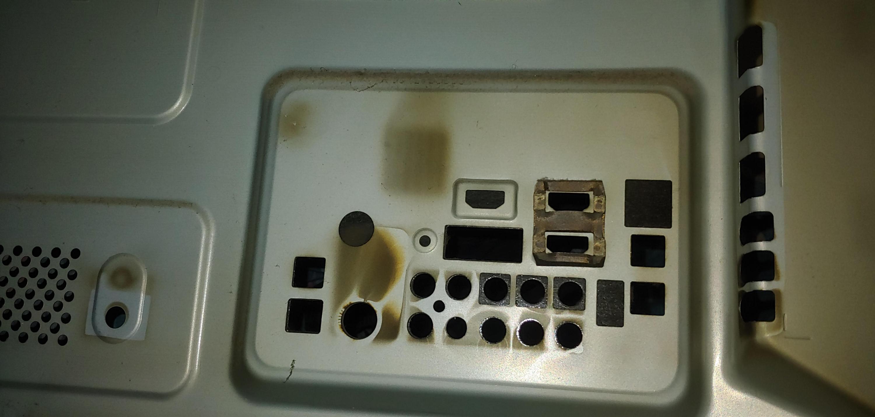

    Hi everyone I have a tv that was struken by god himself cause it blew this tv up. There is extensive burn marks by the antenna coax. I think it needs a new motherboard as the issue is that you plug it in red light comes on you press power and it turns the backlight in but no image shows up. Just a faintly lit screen that's black. Can you guys help me out here? Thanks

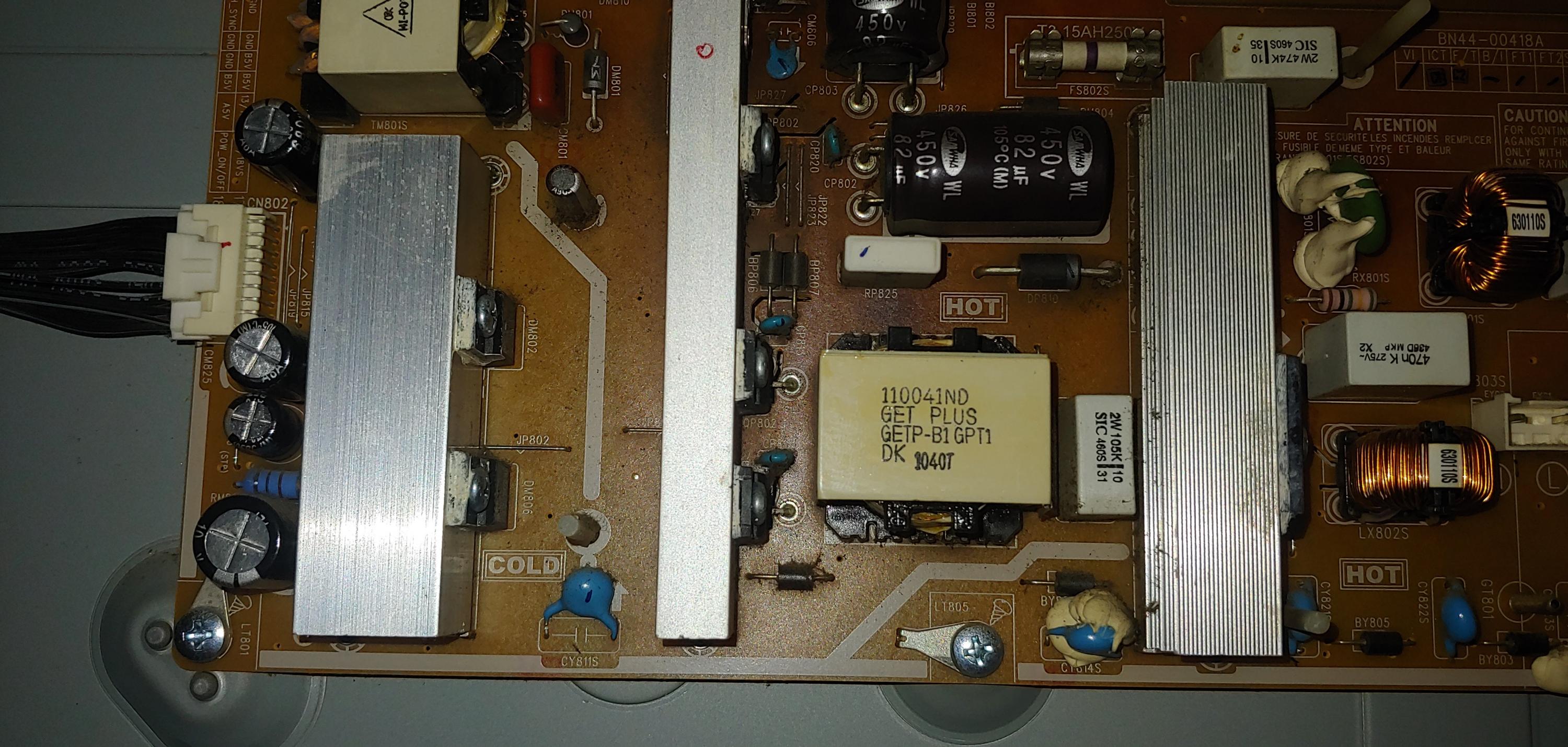

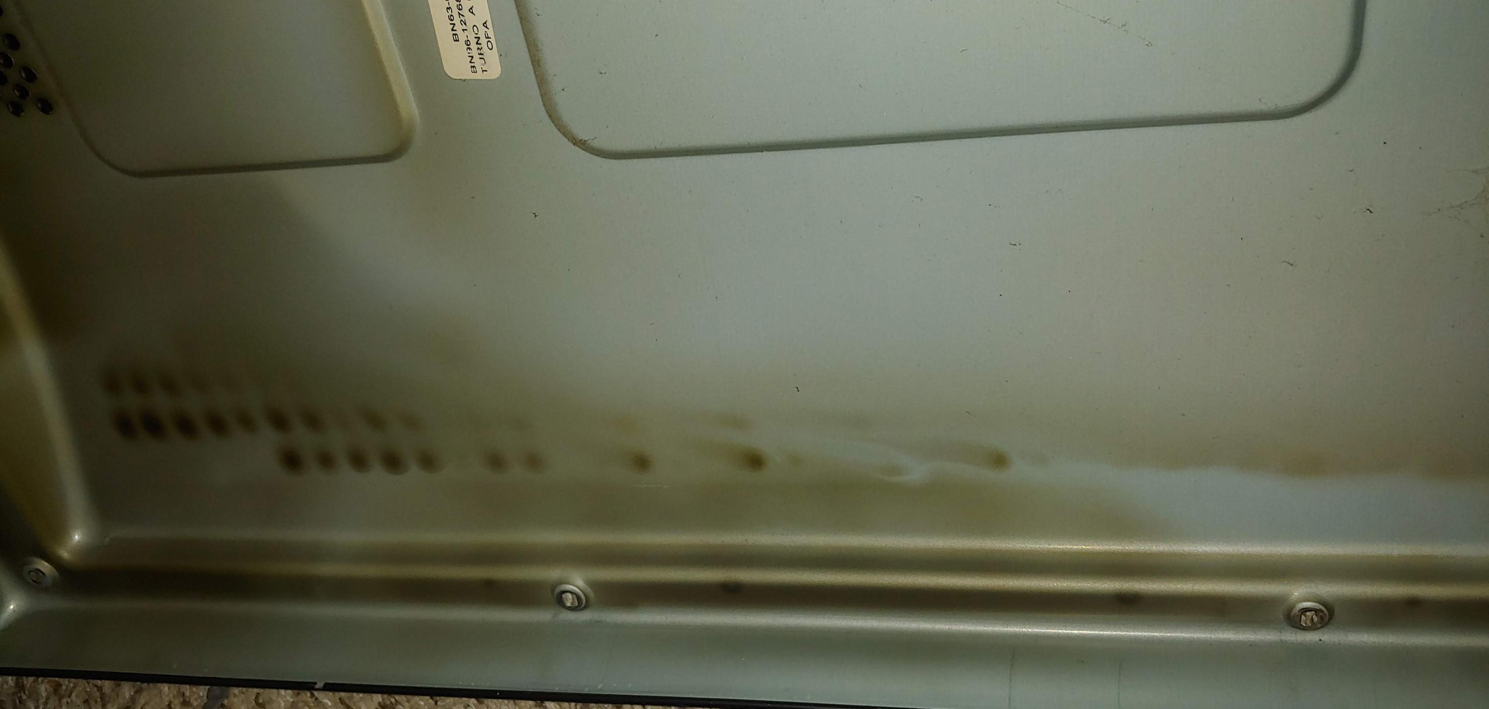

    Well I think the owner, or the previous owner eats cigarretes all day, what else can explain these dark stains on every ventilation hole and the kind of dust that the power supply is covered in other than smoke?
    If there's sound and the tv responds to the remote it may not be the mainboard,, test that out and report please.A

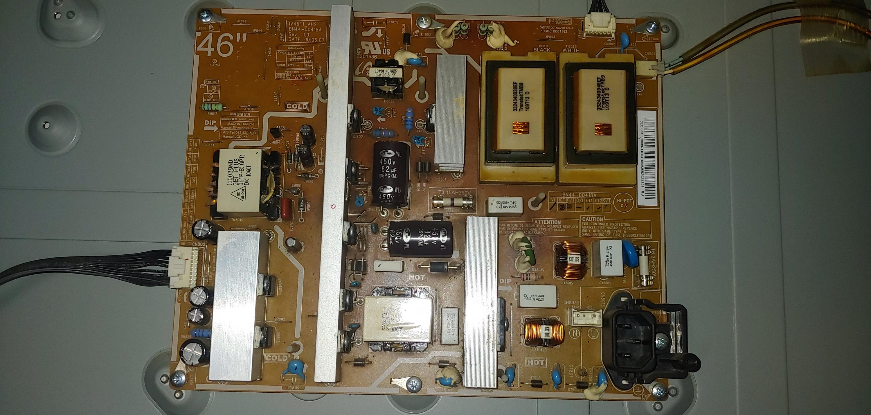

    Are the voltages on the CN802 connector matching the spec? B5V and the others.

      Yes I know I just pick up this junk and have to fix em ya know. I tested all the standby voltages all good. If I unplug the mainboard and plug in, the backlight kicks on right away. So I think the mainboard is fried so I will replace it with a new one and report back with results. Don't smoke kids. This was a very dirty tv yes.

              That's exactly what I will do sir. I'm a certified professional board swapper lol. Thanks for all your helpful input guys. I'm gonna get a new main. I think its obvious that some a voltage spike took this fucker out hard. While I think this tv is nasty smoker infested you can see the burn marks on the metal holy crap imagine the powah.

                I do not think it was a voltage spike, usually when that happens it strikes the main chip with the heatsink, and the capacitors that are parallel to it measure shorted, the TV wouldn't even turn on the backlights, this chip should have around 10 OHMs or more of resistance.
                This is a failure due to the bad condition of the smoke residue + oxidation, or BGA. If this board is expensive probing the one you have is useful, and test if 12V is reaching the T-CON fuse on both sides.

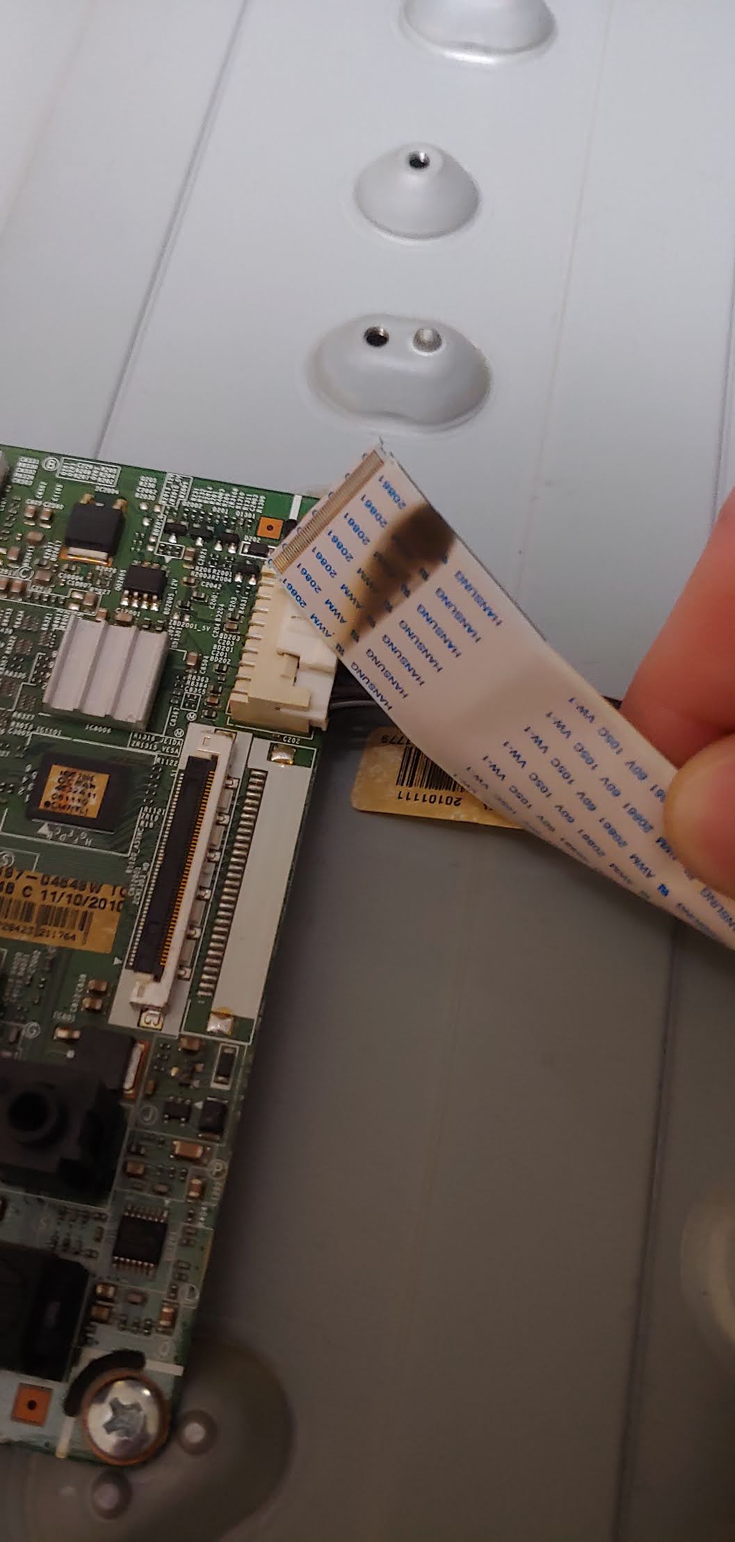

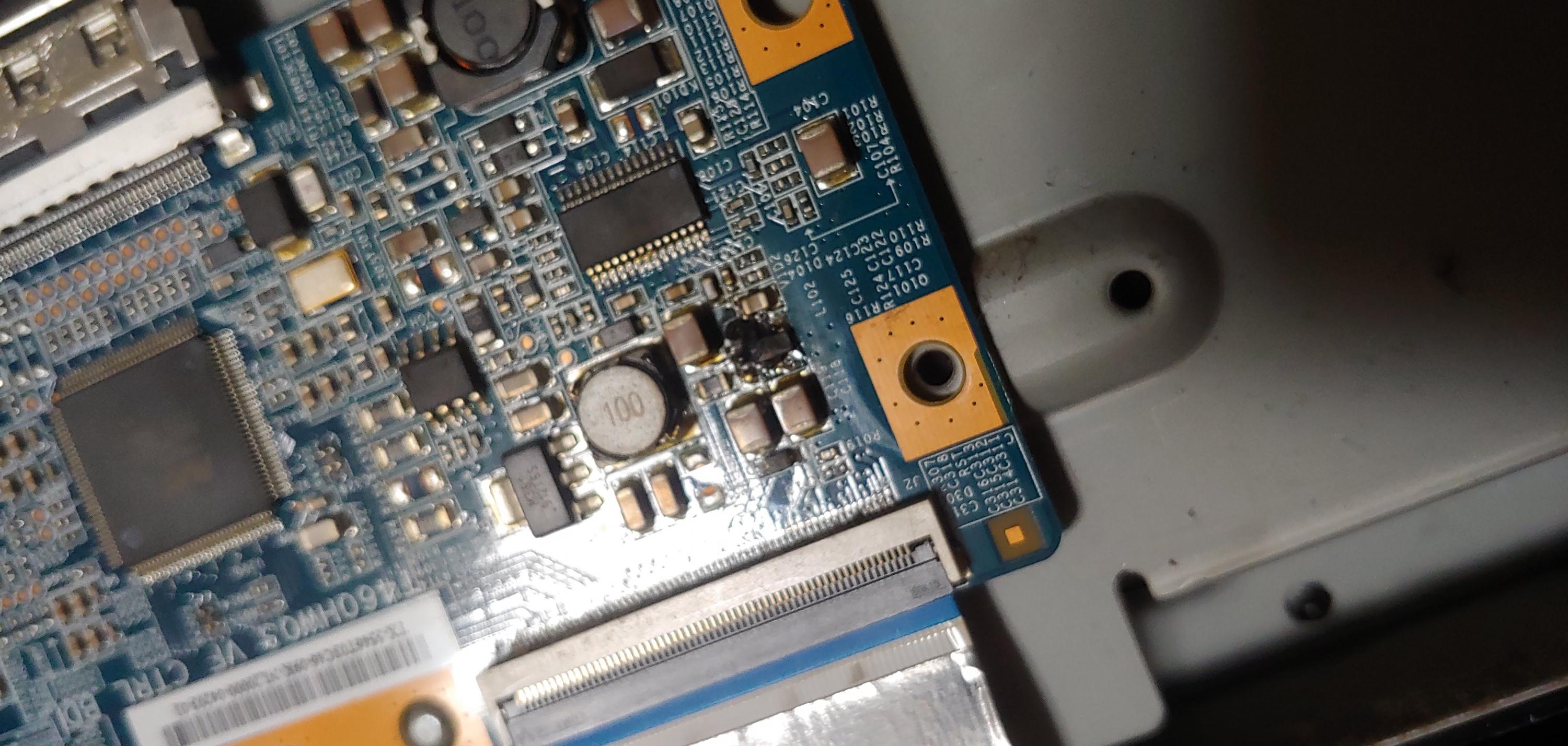

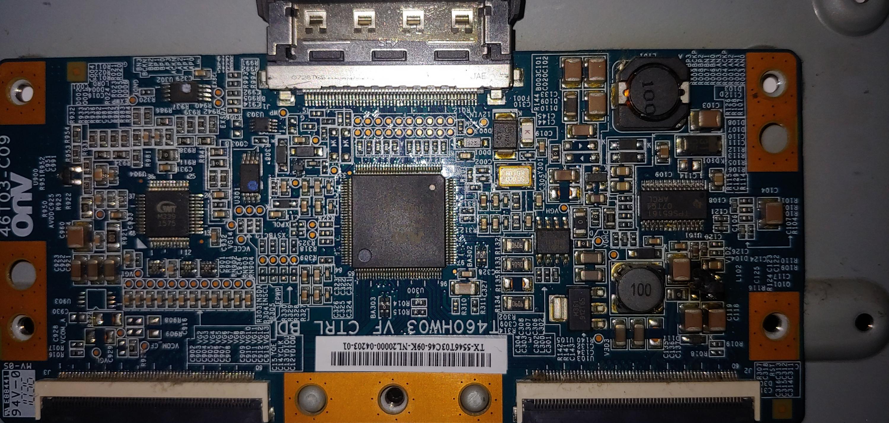

                  Thanks for mentioning tcon board look what I FOUND!!!
                  • Super360
                    • Jul 2016
                    • 243
                    Re: Samsung LN46C530F1FXZA ⚡ DAMAGE
                    Do I need this then?

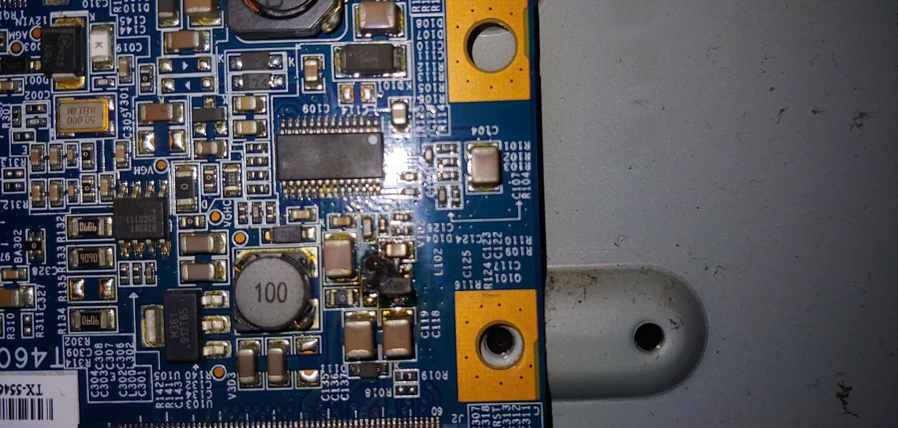

                      It does not mention what components are included in the repair kit, there's a schematic for this board, Q101 is burnt, due to a shorted capacitor on T-CON, it is also directly linked to the panel, may be some capacitor on the panel boards or the panel itself.
                      https://www.electronica-pt.com/esque...a-t-con-37136/
                      Q101 is SOT23GSD for AVDD voltage.

                        I had a burnt component on a tcon once. Replaced it to only find there was a liquid spill on the panel damaging the panel boards. I would inspect those.

                          Yes this one definitely had liquid damaged. I think this one is not "worth fixing". It had some pop spilled all over the screen dripped on the driver ribbon.

                                Rip this tv. It lived it's best life. It came to an end from all the nicotine soaked boards with the hairy boards. Then some jerk spilled pop. It spilled down to the ribbon tcon flex. It caused a short and blew up the tcon and the whole tv it seems. The only part that will be salvageable is the psu and backlight inverter.
