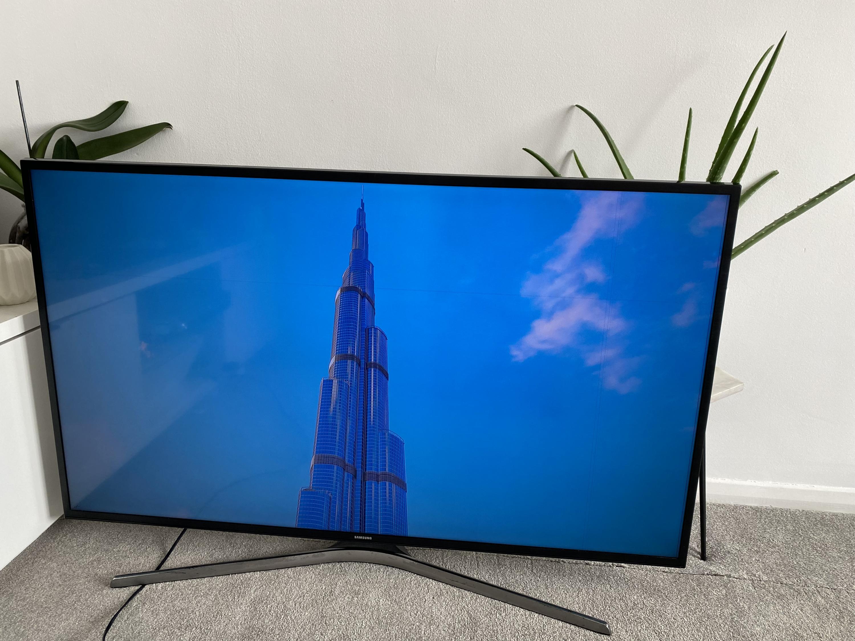

    Re: samsung UE49MU6120KXXU image problem
    The flex that joins main board to the panel
      I have just done that and it's working. I goy 5 very thin lines in stead and the quality of the picture is lower but the flickering has stopped. All together, acceptable results, if you are not to close to the tv you won't notice anything wrong.
      Thank you guys !
        Burj Khalifa!
          Burj Khalifa!
