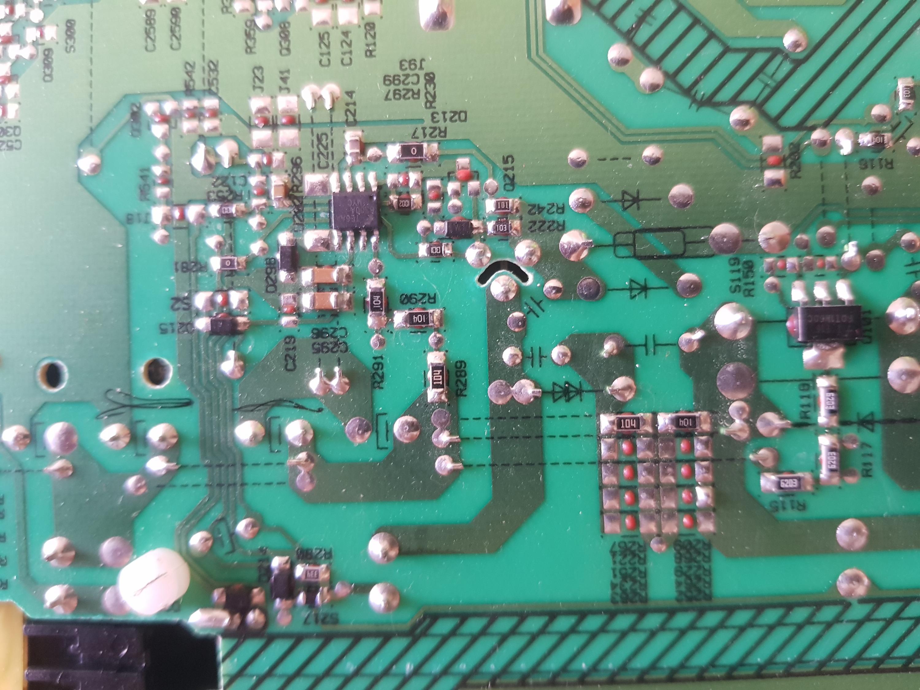

    Got this 40" TV off the tip and the power board has a problem, previous attempts have been made with the replacement of the thermo resistors.
    Main filter caps have 330V although It seems Q211 has a problem as the outer pins are having continuity, caps seem okay but I suspect there is a shorted resistor some where??

                        Q211 would be the mosfet attached to the heatsink.
                        Post some photo's of the area of the board around Q211, top and bottom to see what components are fitted on the power supply and match the schematic.

                          Re: Vestel 17IPS20 R6
                          Not sure if these close ups of the area will help, unless the schematic is not for this board?
                            Check D201 as per attachmnent
