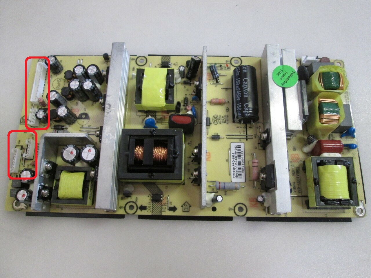

    Up till now it has been mostly random, when the tv is off sometimes it won't turn on without unplugging tv for a minute, once its on it works perfect, now it has to be power cycled everytime I want to turn the tv on.
    Any ideas

    Do you have any photo's of your power supply. Have you taken any voltage readings?
    Photo's of your circuit boards are best since the problem can sometimes be seen.
    Is this your power supply?
    If it is what voltages do you have at the connectors

      Googling the main board for your model, it is the design that typically has eeprom failures causing issues with turning on. If your standby voltage is good, the eeprom is suspect. https://www.shopjimmy.com/element-el...2-eeprom-only/
