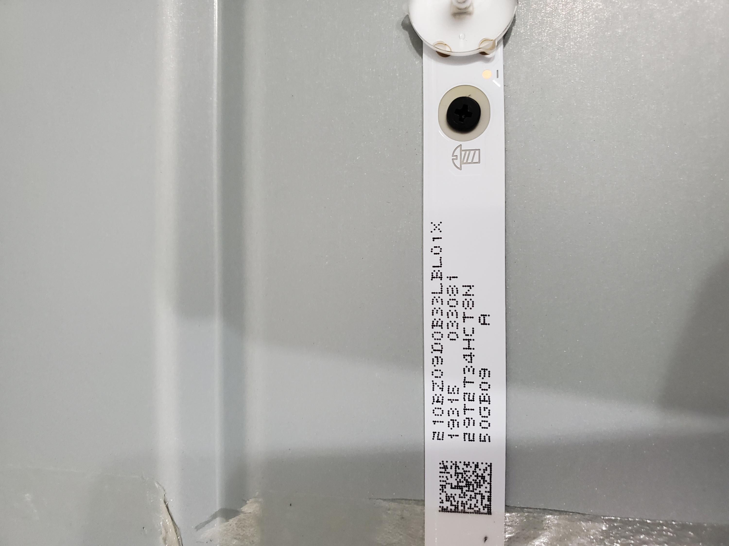

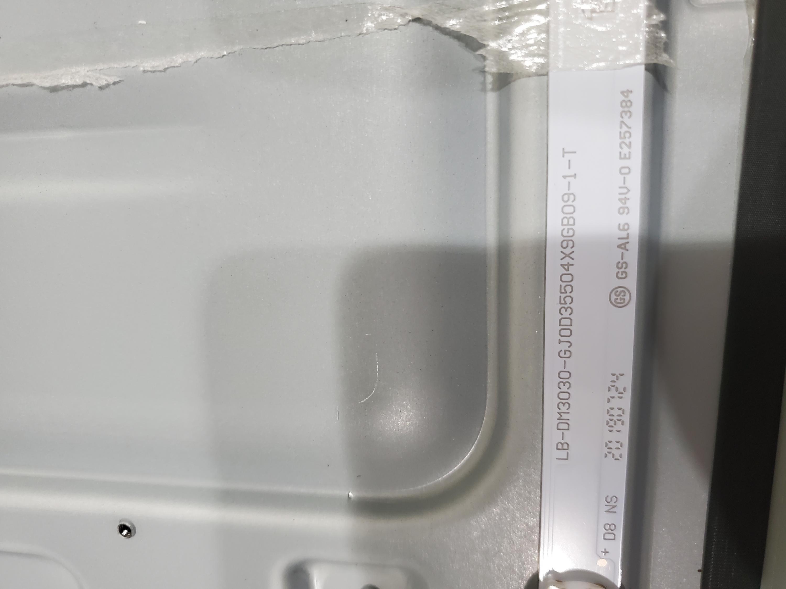

Good evening everyone. I have a 50 inch LG led tv that has 3 bad led strips. I would like to replace the entire set of strips but am having a hard time finding where to purchase them. The TV is a tad over a year old and right out of warranty so I don't know if its too new is the reason or not. I have pics of the sticker and pics of numbers on the strips but anything I enter doesn't show up anywhere I look. Any help would be appreciated.
LG model 50UM6900PUA. Need to find led strips.
Re: LG model 50UM6900PUA. Need to find led strips.
https://www.shopjimmy.com/insignia-l...ight-strips-8/
Matches your panel number. Substitutes in stock.Comment
Matches your panel number. Substitutes in stock.<--- Badcaps.net Founder
Thanks again for the help. Last question, the ones that are a substitute have only 8 leds where the originals had 9 per strip. Will there be a significant difference you think or just go with the 8 ones.Comment
