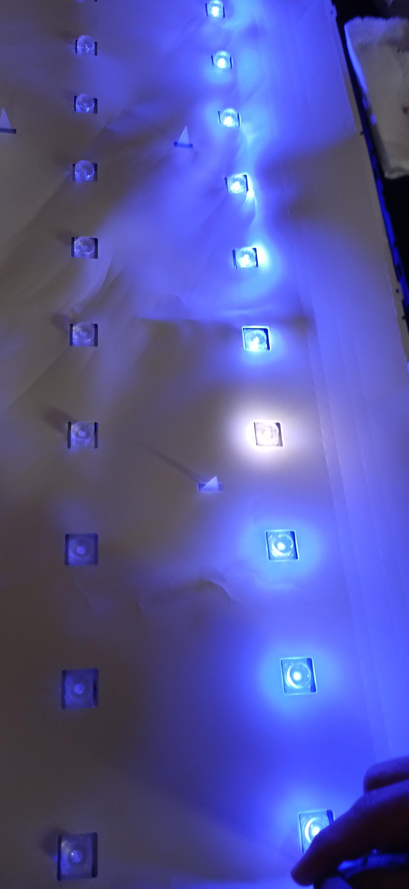

    The PO said he owned this for 14 months before it stopped displaying a picture. Turns out to be burnt out LEDs in the backlight.

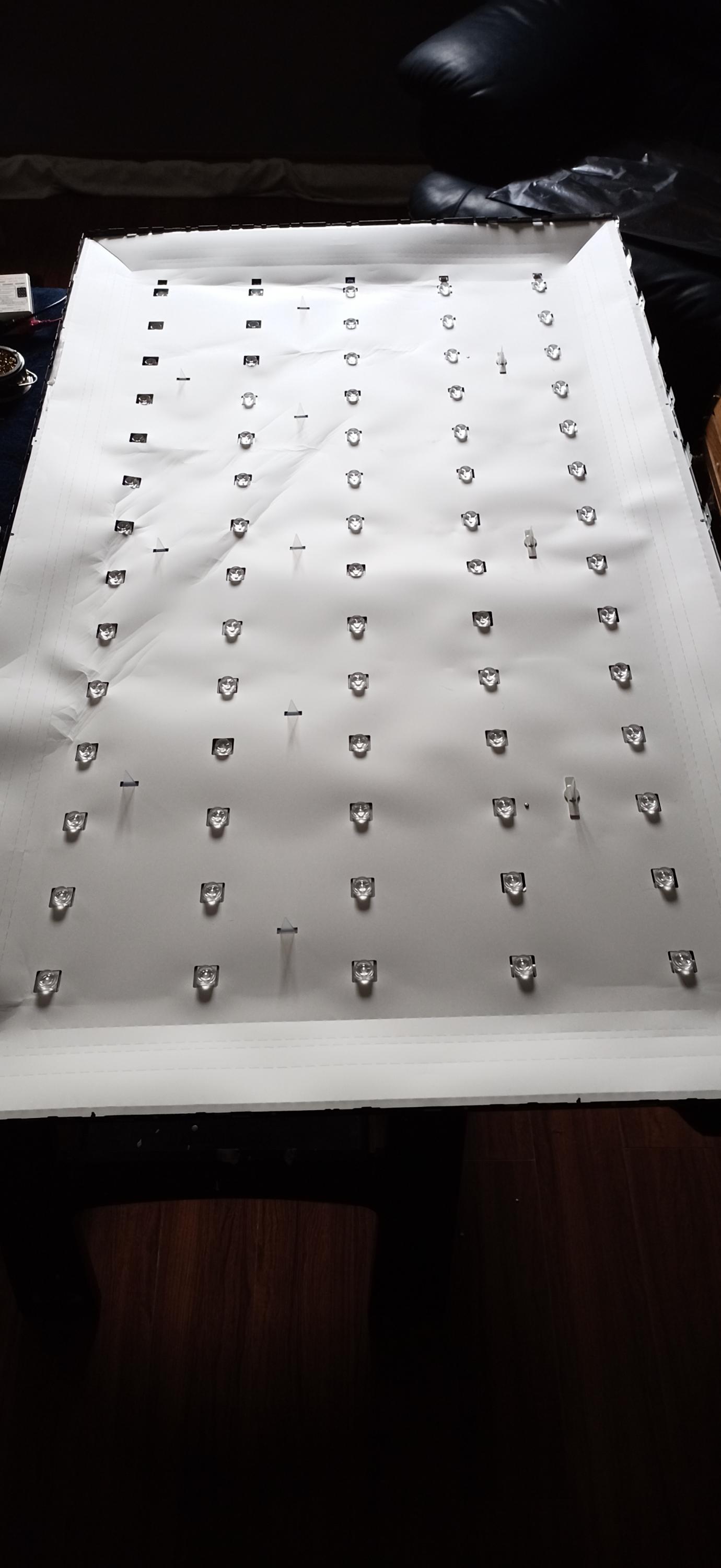

    I've torn it down. The LEDs are arranged in five long 14 led strips, each strip being two sets of seven in parallel. Only one half strip of seven still works so at least NINE DEAD LEDS!
    The LEDs are six volts, the only ones I had on hand I harvested from an LG set. When installed there is an obvious difference in colour temperature, the new ones being much whiter than the cool blue of the original.
    Anyone know anything about this type of led and where I might find some ?

    It looks like it might me a blue led. This is common on the quantum dot TVs. If one of your filters was a yellow color instead of clear, then it’s quantum dot and blue led

      Yes one of the filters is yellowish. Thanks for the input.

              There's no guarantee they match the specs of the ones I'm looking for but closer than anything I have anyway.
              By the way they've used too many glue strips to hold down the white light-box reflector covering the led strips. I've put many creases in it just trying to get it out. I'm sure this set will have uniformity issues upon reassembly but better than going in the trash I guess.

                I hate when they do that. Still haven't found a way to remove them that isn't a bit destructive... I had an older set that I did what I call a "down and dirty". Only one bad led, so I used foil to line the hole and used hot air to remove bad diode. Worked fine with minimal damage to the light box cover. I could peel the edges loose to use led tester on the whole strip...

                  Thankfully besides the glue there are only three of those post type clips holding it down. Of course they are each located behind the three boards of the set, so they each have to come off to release the clip.
