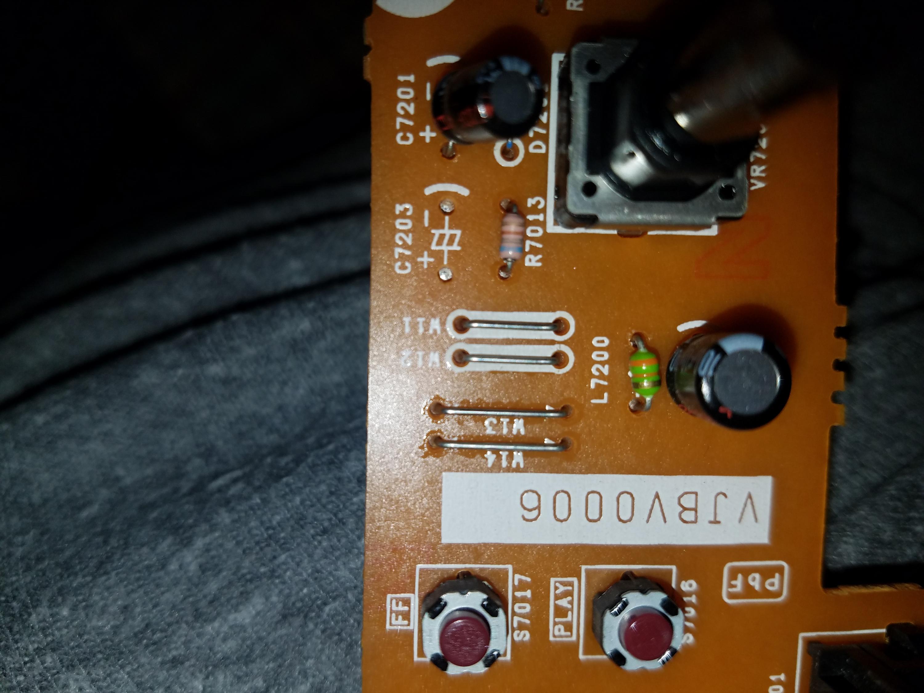

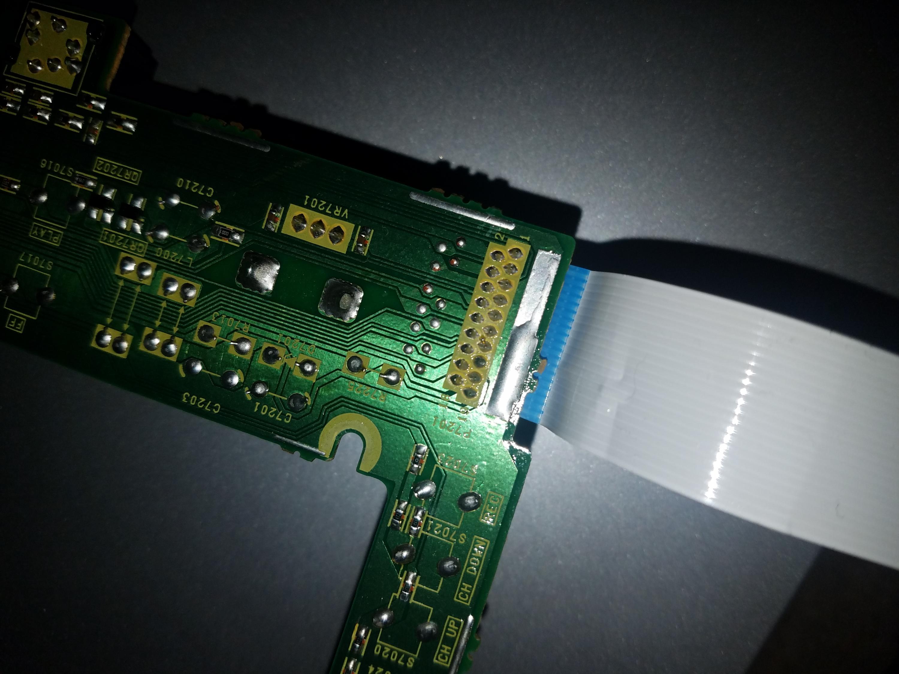

    Originally posted by R_J
    That is glue, the cap is not leaking, even if it was bad it would not cause the display to be like it is.
    Oh, looked like othep pics of leaky caps. Right, I just thought it looked like it needed to be replaced. So besides visually, how do you check for a short with a multimeter?

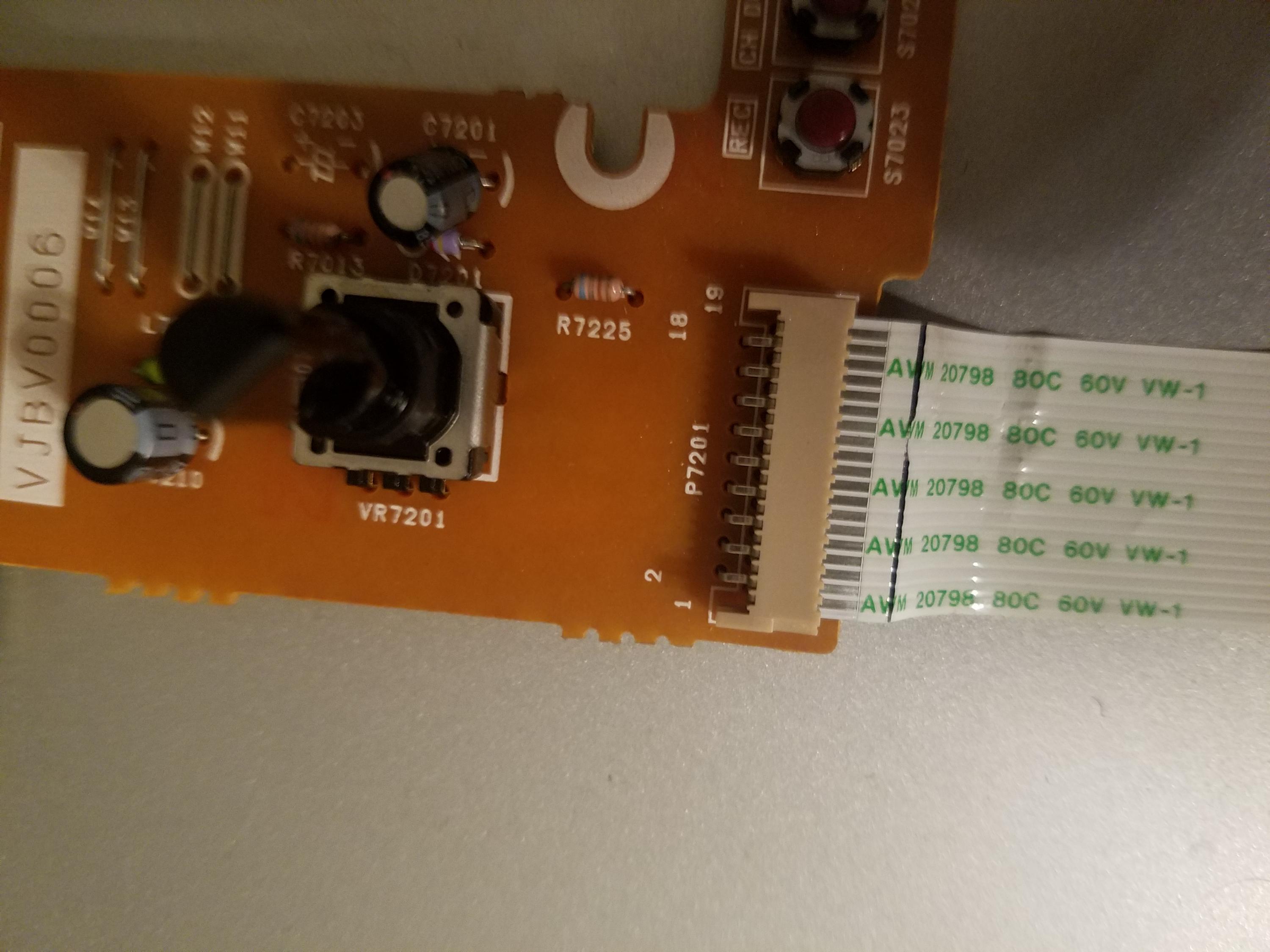

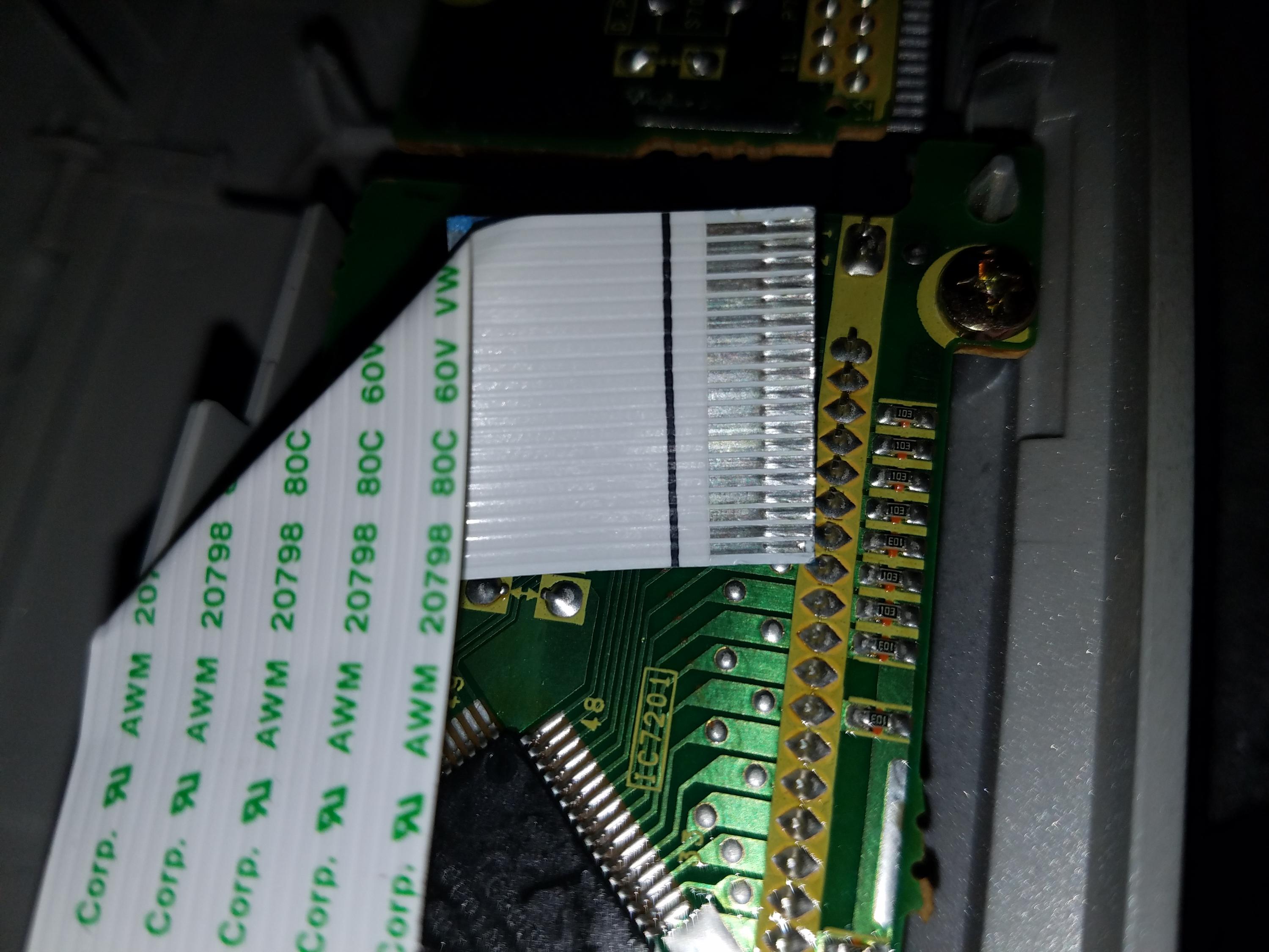

      Re: Panasonic SA-HT820V Home Theater System
      Does the display board have a flat ribbon cable going off to another board. If it has I would check the gold contacts at both ends.

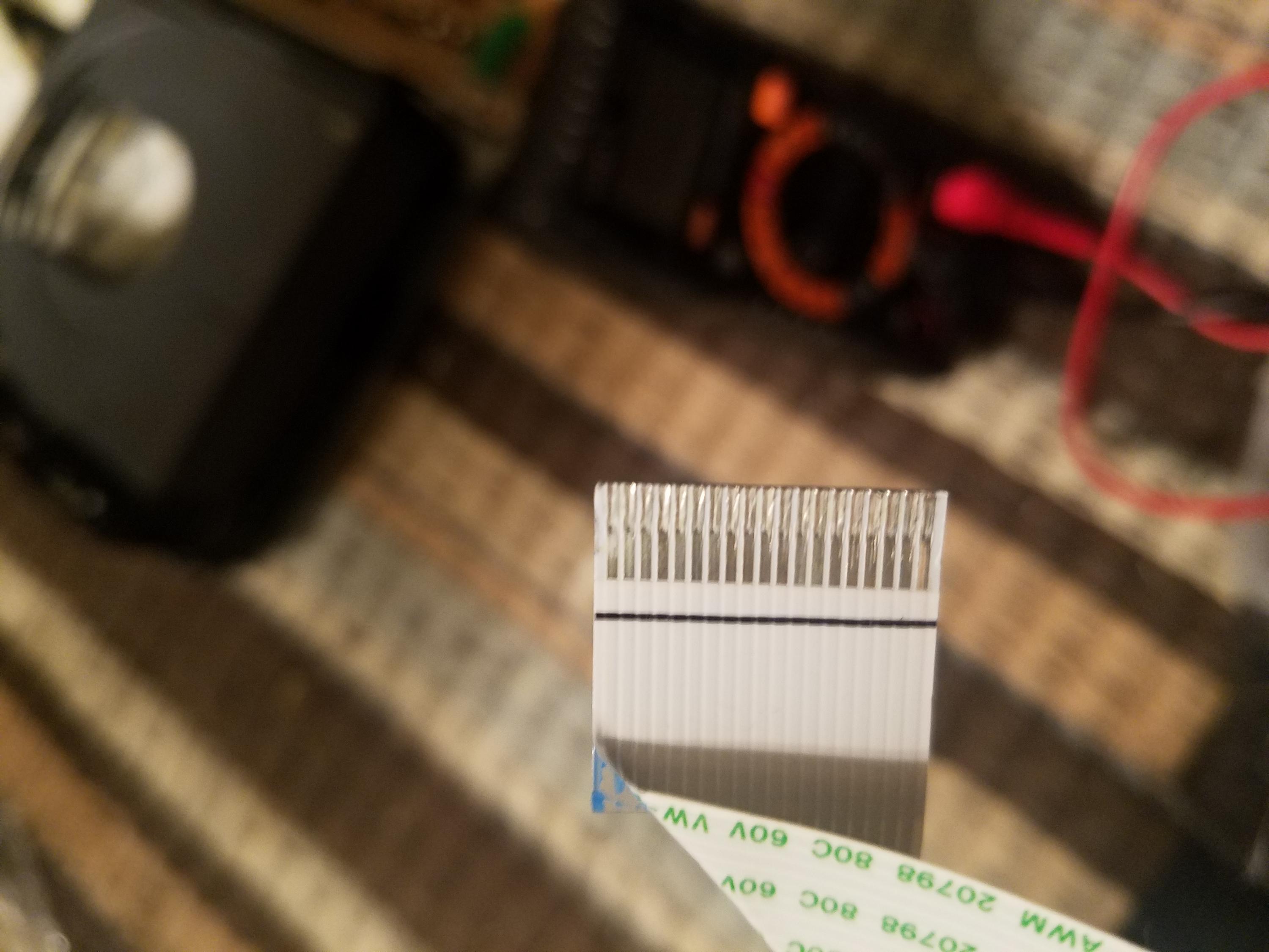

        I don't know what to say... You can use the ohm setting on its lowest scale, when you short the probes together, that is what a short would look like, 0 ohms (or close to 0) You likely shorted something and are missing a critical voltage or you blew the display driver Try and find out what created the burning smell. It was working (sort of) before so it is something you did, so go over everything that you removed or unplugged.
        Check thatyou did'nt damage the cable P7201 between the display board and the main dvd interface. Can you locate L7200 on the display board? it should have +5volts on it

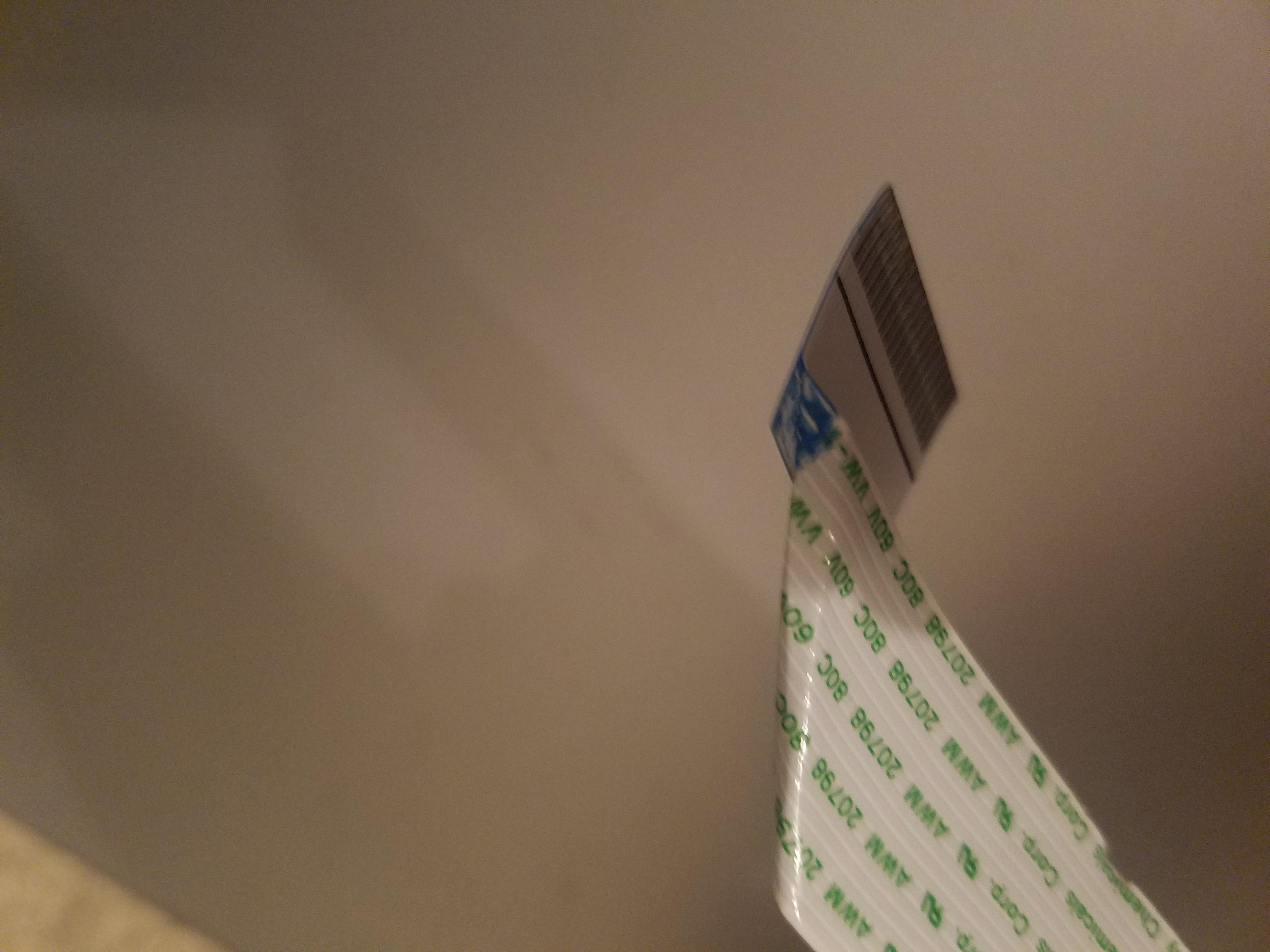

          Download the service manual
          The cable from the display was my first guess since I forgot to unplug it several times when taking off the front and it would yank it. It was pushed up a bit at one end but I pushed it back down. The othes side tore off a bit tho because of the angle in which its bent to connect. The end that connects to the board looks fine.

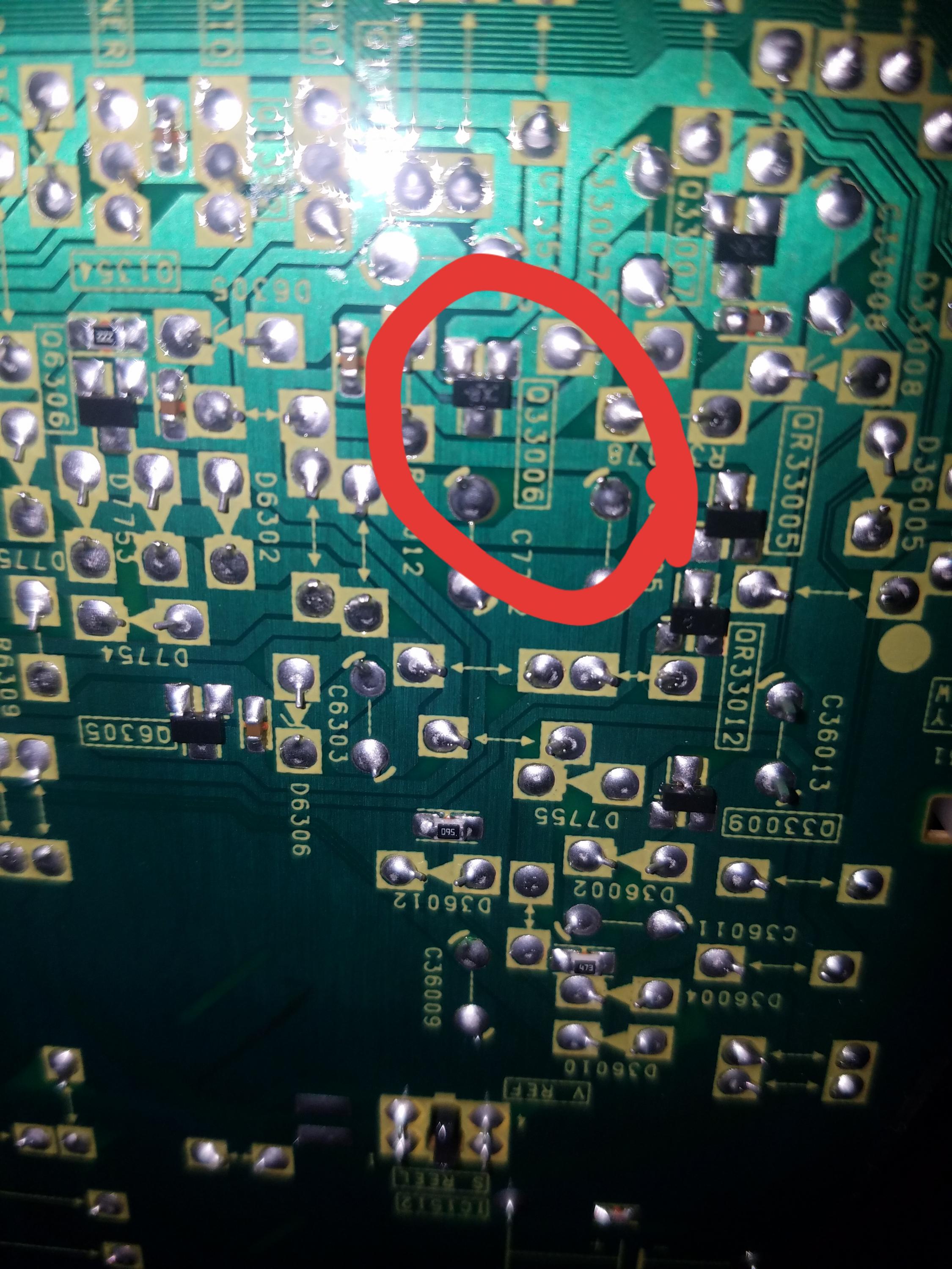

            I found L7200 and not getting a reading. Newb question, is it suppose to be plugged in and connected when checking it?
            Define "it" Yes the VCR needs to be plugged in, and Yes the connector needs to be connected to check for the +5 volts.
            In sch11_14 (Pg3) , you will see Q33006, it is the 5V_vcc regulator, check the voltage on E,B & C.
            sch27 has the power supply, check the voltage on P1102, are all the voltages their?
            The blue stiff plastic being pulled away from the white flat cable is not a problem, the blue piece is to stiffen the cable to make insertion easier. You need to be careful with these cables or you will continue to damage them.
                So apparently it's under the board, or at least the label is. I knew that! What am I checking? Because Im not seeing those letters anywhere.

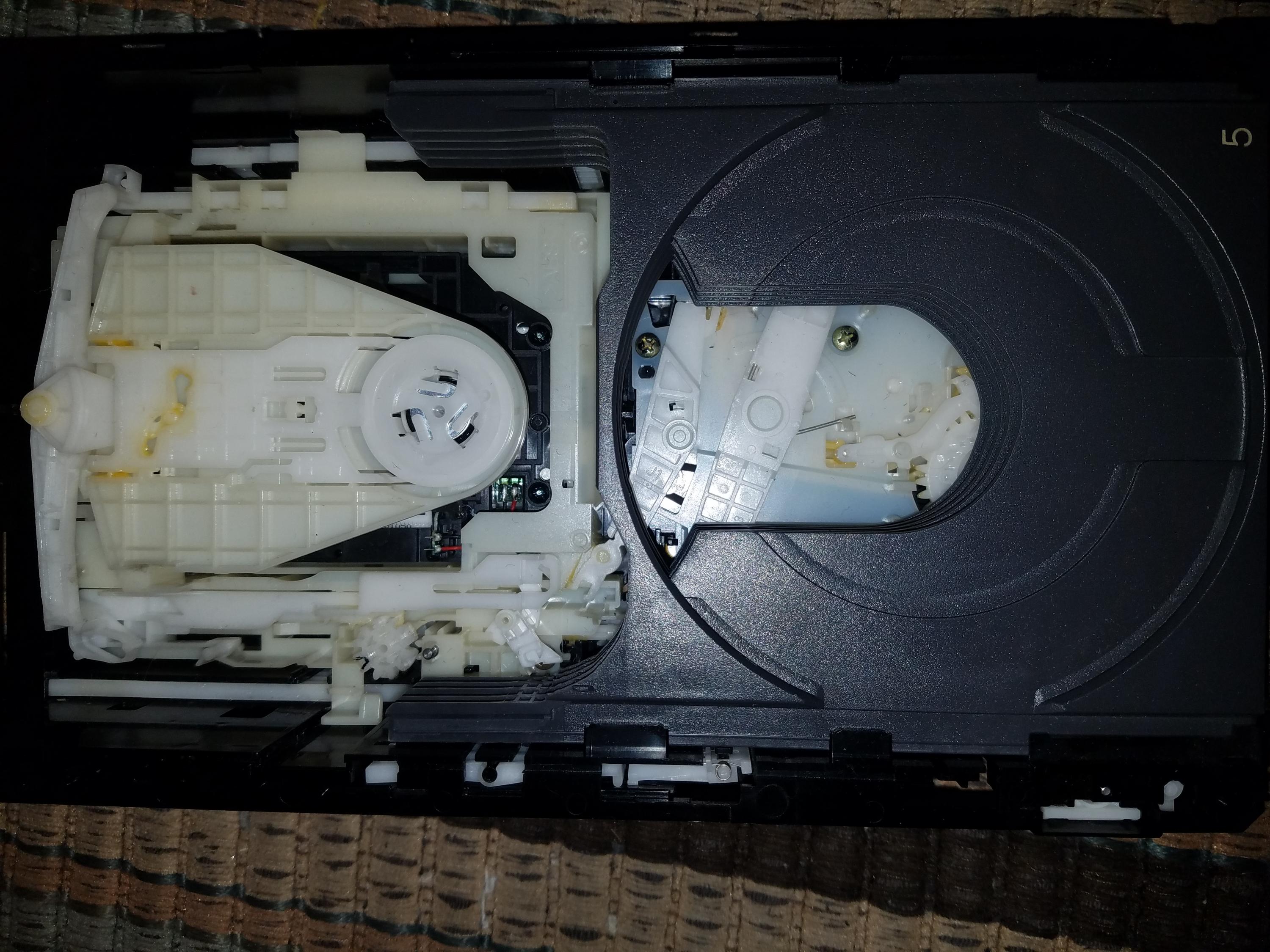

                    My post #5 i wrote its mechanic issue and need to put all at zero point.
                    yours display photo its tell same you have Order JAM ( because the lost of zero point and there are 2 or more micro switch sending order.) though this can damage the main IC. not C or R.
                          I think we set the VCR to zero point but not the DVD. How do you go about doing that?
                          Here's the top and bottom. Do I need to take the trays out?
