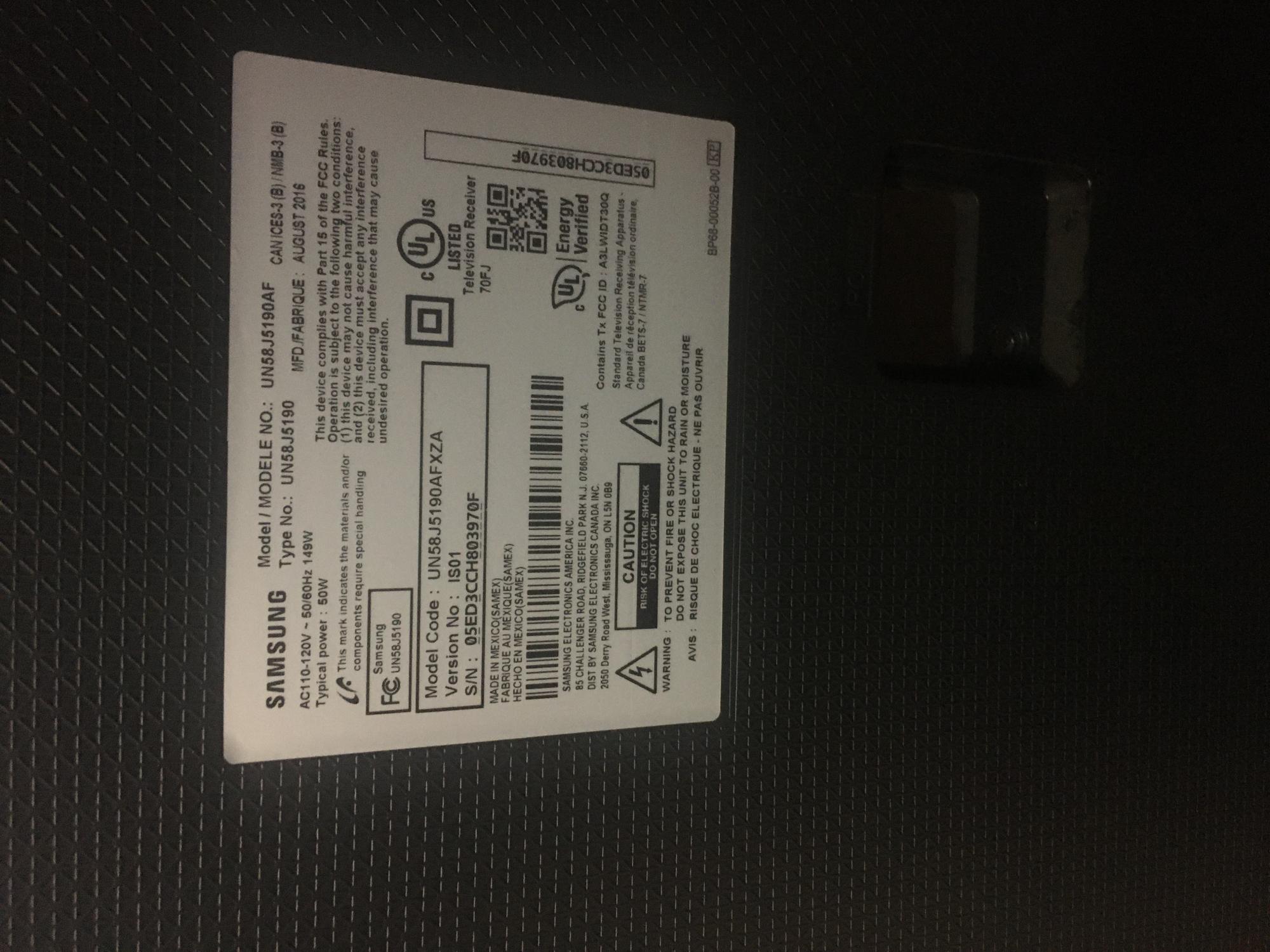

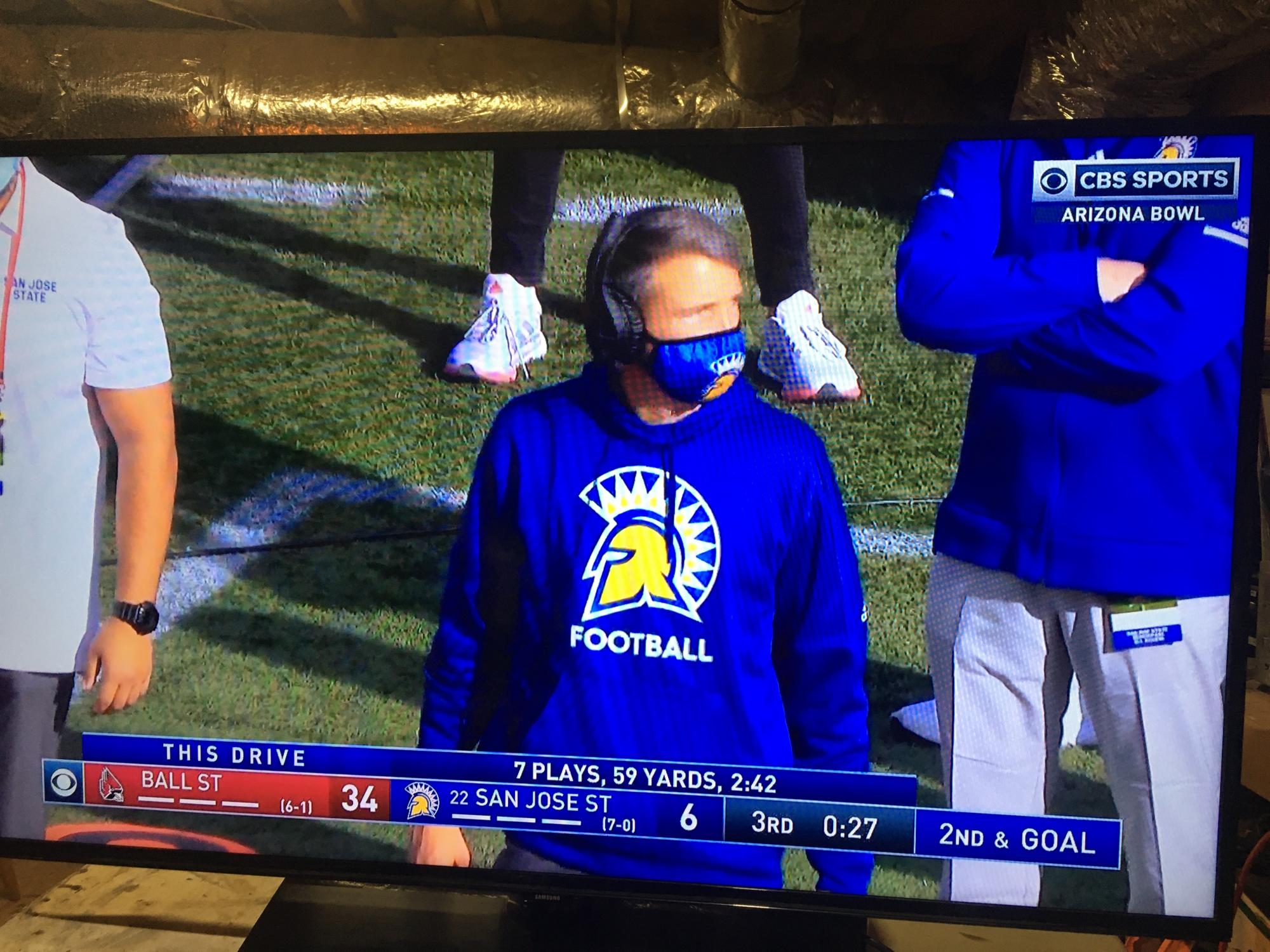

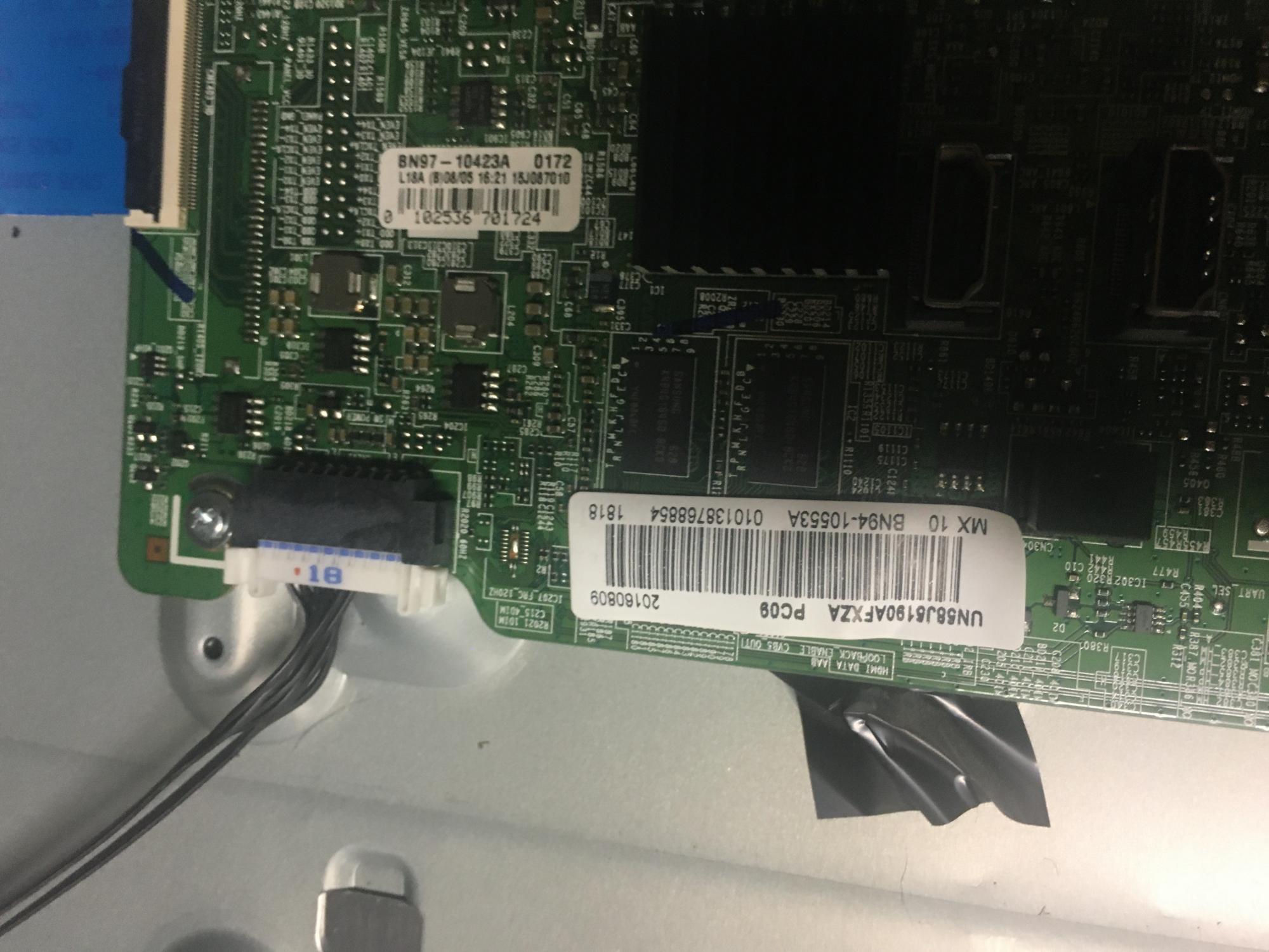

    Just repaired SAMSUNG UN58J5190AFXZA
    58” Samsung had no power. Checked power supply and had voltages except 13volts. When I unplugged power supply to main board Back lights would come on and I had 13volts at the power supply. Main board was bad. Installed new board and fixed problem.
