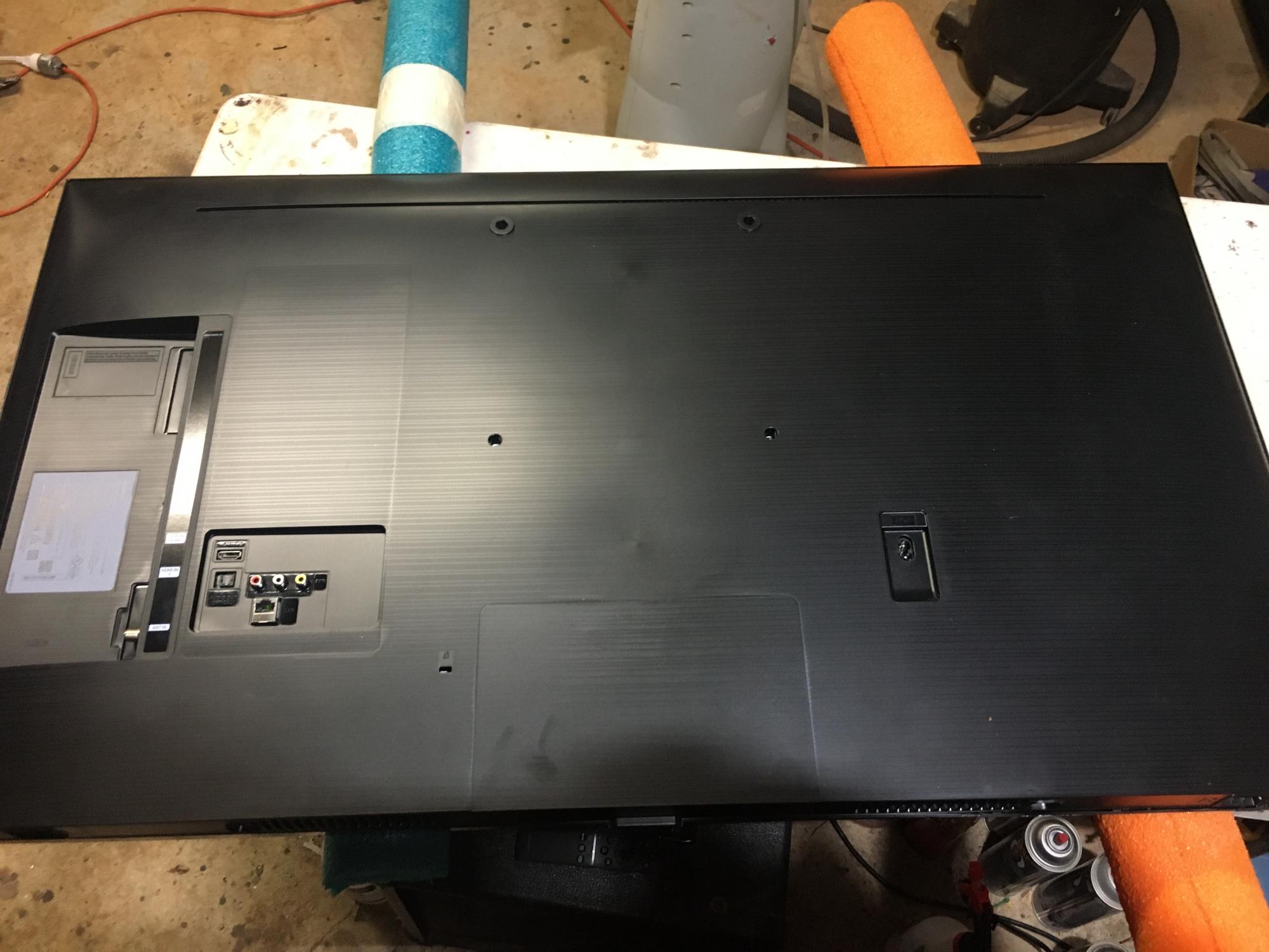

    Samsung UN43tu8000 remove back
    A friend just brought me a brand new Samsung UN43tu8000 to fix that has a blinking light on the bottom that sometimes goes solid but will not power on. I have worked on tv's for years but I cannot figure out how to get the back off of this thing. Not like the normal Samsung flatscreen. I cannot see any screws anywhere to take the back off.. please help.
  • neilc6
    • Nov 2015
    • 1550
    Re: Samsung UN43tu8000 remove back
    Get some disposable chopsticks or a plastic pen and poke it through two starter holes at the bottom of the tv. Drag it along the edge to release the clips. Once it's started, it'll become easier.
    • Taterbug
      • Dec 2013
      • 114
      Thanks ... that worked
