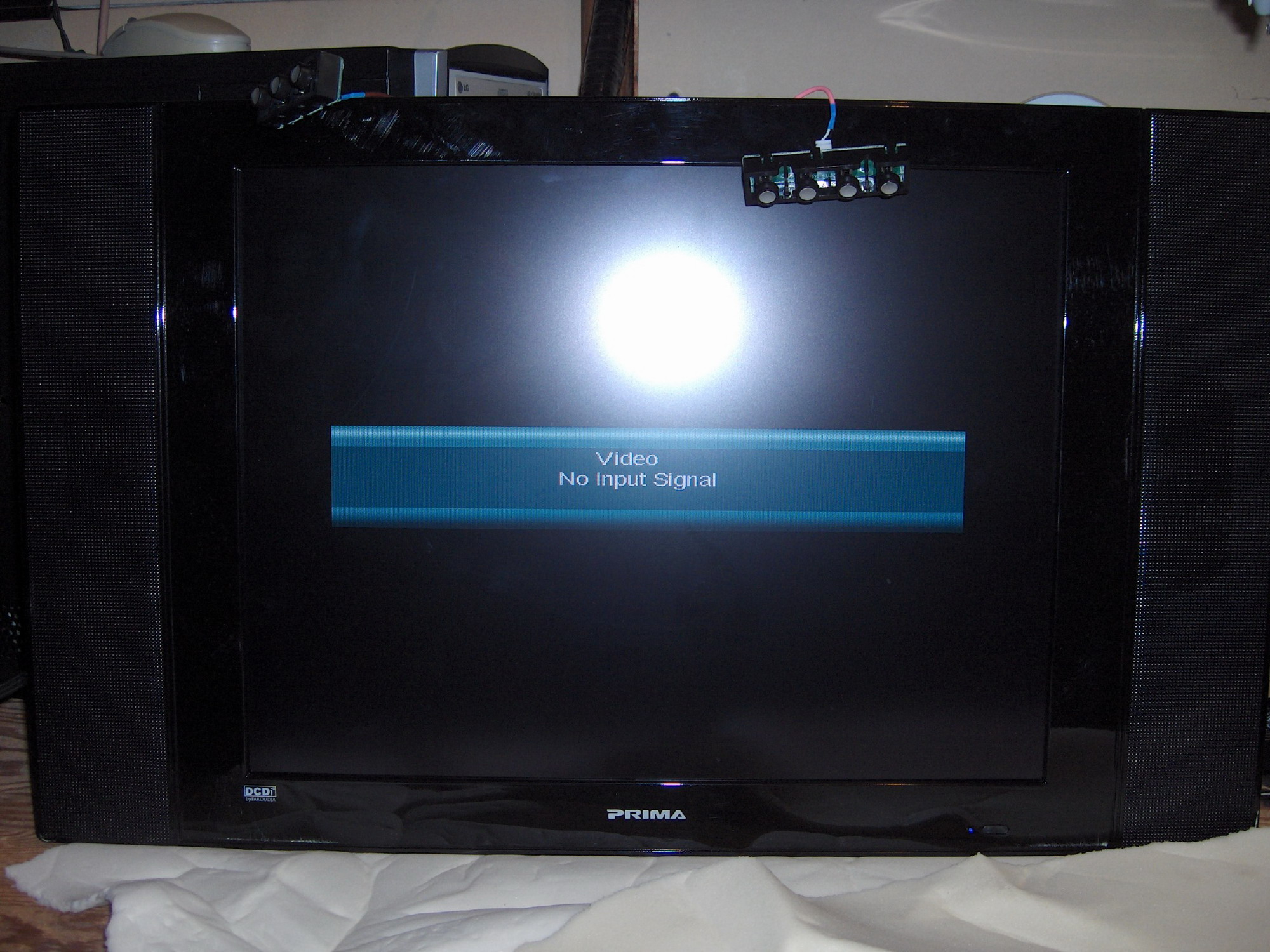

      Re: Prima 21 inch lcd TV powers on then goes dark
      a little update here... Prima 21 inch lcd TV model #LC-20Y15
      hooked it up to dvd player and was able to get a picture with sound for 1 - 3 seconds then goes black. sound stays until i power lcd off. repeats same cycle when i power lcd back on...

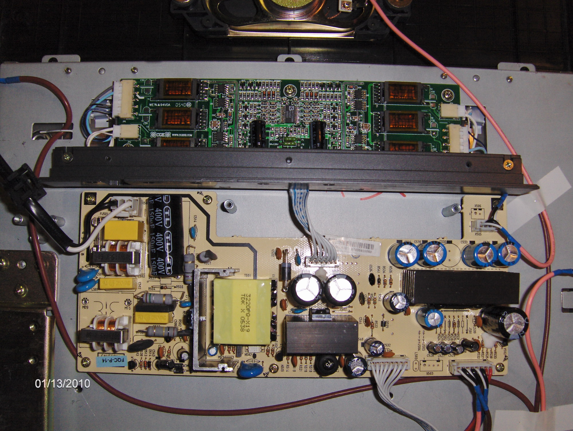

        Re: Prima 21 inch lcd powers on then goes dark
        I misinterpreted some information the first time I read this. This sounds like the classic 'two seconds to black' issue. Possible suspects are inverter, backlights, or wires from inverter to backlights.
        Note the cable from the power supply to the inverter. It appears there is information obscured by the cable. What does it say? Also, on the inverter, what is the part number of the large IC in the center.
        If you look at the left connector on the inverter, you can see there are two connectors, one 5 pin, one two pin From the top down the wires are large gray, large blue, small black, small dark blue, large white, small white. The same arrangement is on the right side, but in reverse order.
        The large wires are the drive lines to the CCFLs, they have a heavier insulation. The smaller wires are the return lines. While the backlights are working measure the AC voltage from each return line to ground. We are looking for one that has a different reading.

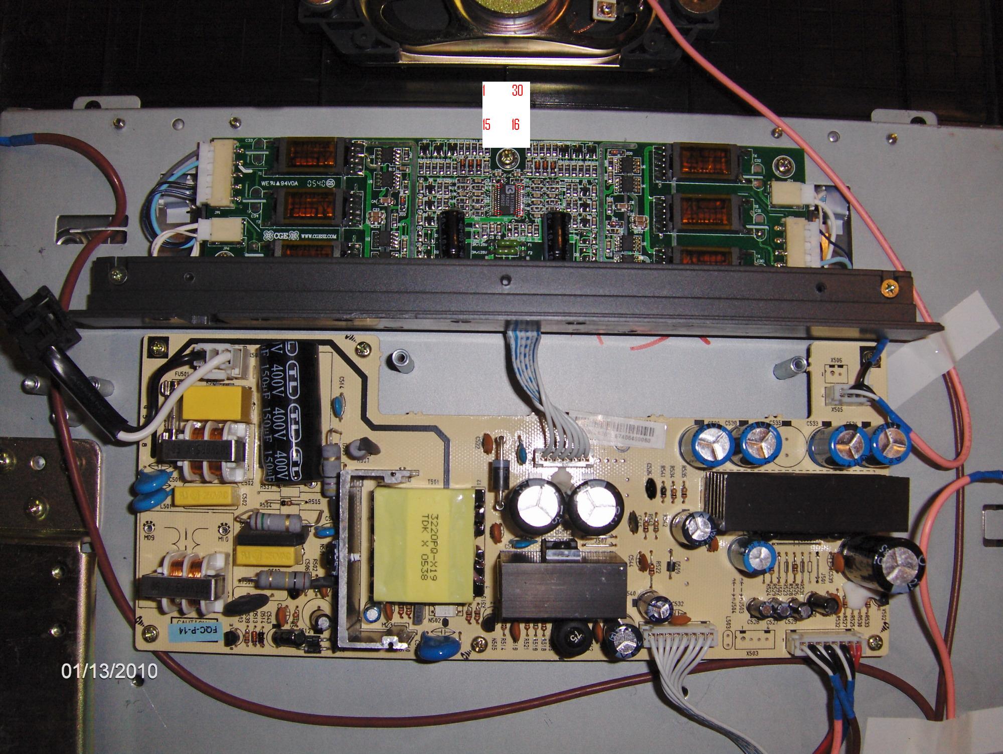

          BI000E9A70 E7466400060
          IC BIT3106A
          FK202
          G0552
          i hope i measured properly, im not advanced in the ac measure department.
          as u asked/requested
          as pictured from left to right power in black and white cord side
          s black .005 s white 2.20
          s blue .005 s blue .005
          s white 2.5 s black 2.35
          please advise. thanks.

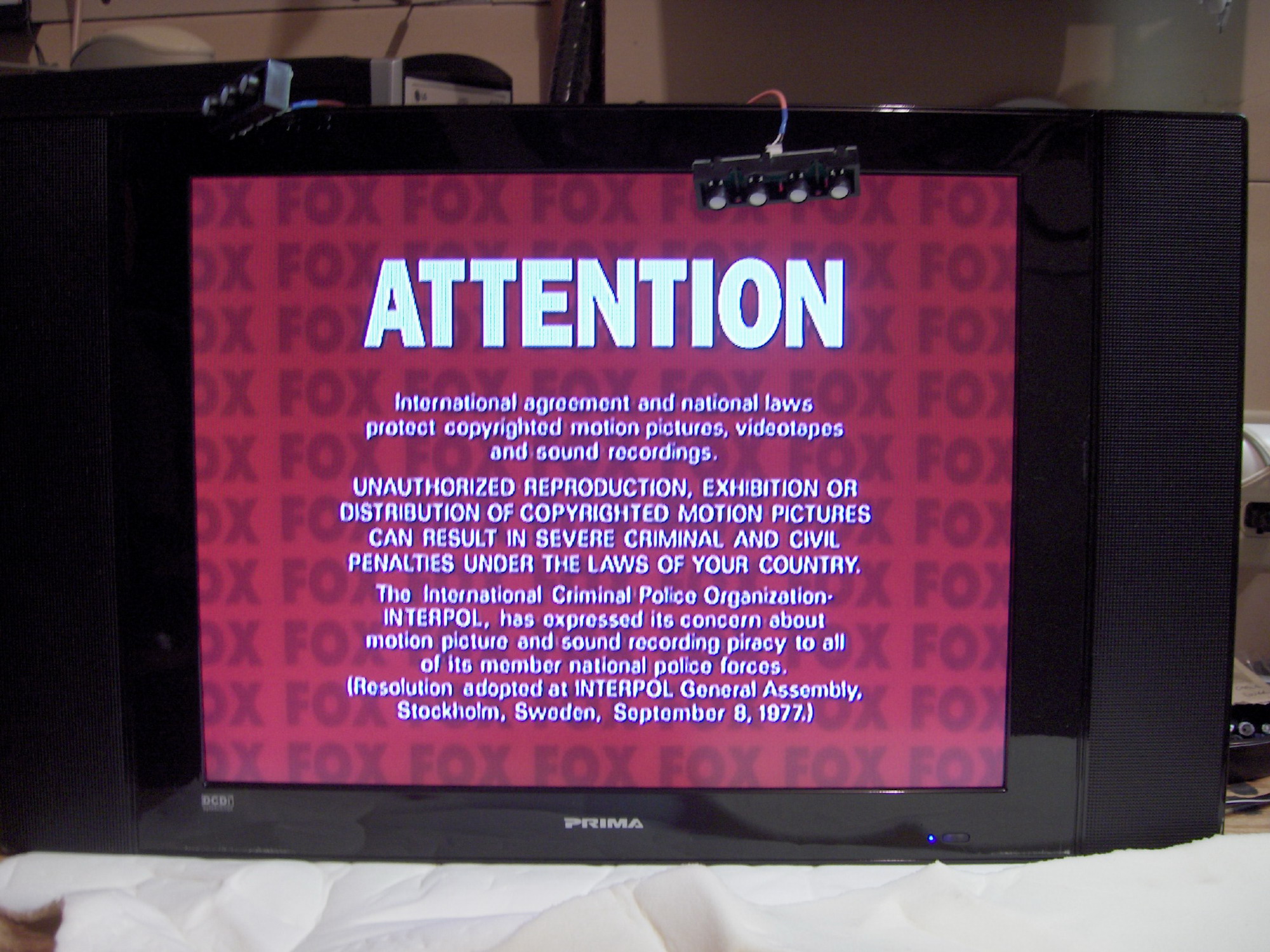

                      • starmaxpc
                        • Oct 2009
                        • 117
                        A lead from the inverter to a CCFL is shifting and either disconnecting from the CCFL or shorting to the panel. When you stood it on end the wire shifted so the problem no longer existed. I thought those leads to the CCFLs would be prone to abrasion. Or it could be any similar problem of a bad solder joint.
                        PlainBill
                        ok this has been working for a good while now and what i found was when i looked real close at the inverter board area was when i did a reflow of the some solder i accidently fused #4 and #5 pin on the IC chip and thats when it started to work and now it is currently working with no problems. is that a good thing or not? you mentioned the ccfl's? are those pins on the IC chip firing the power to those ccfl's or did my solder mistake make things work? i am now into a movie here approx 30 minutes with no problems? please advise....

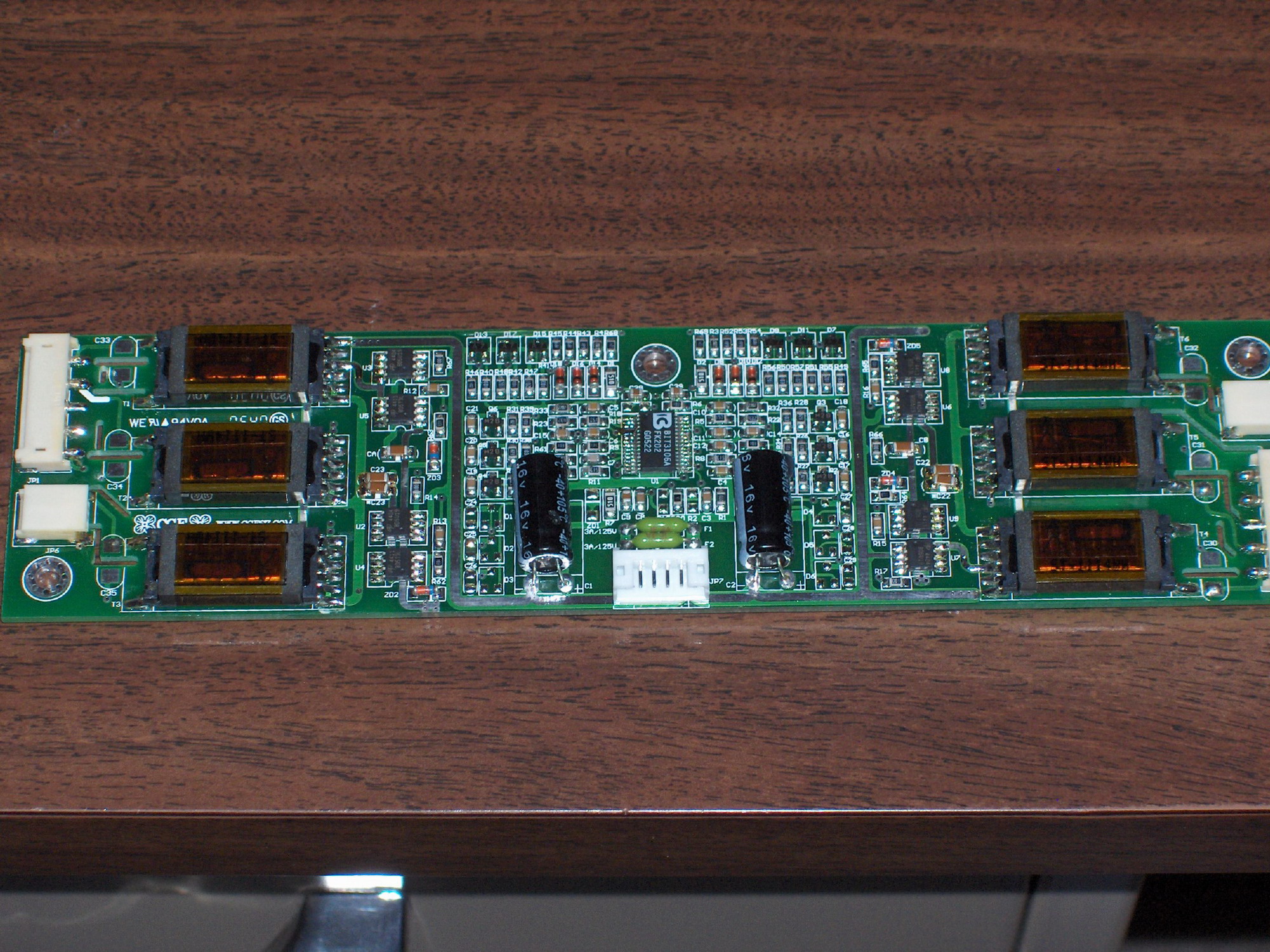

                              thought id post a pic on inverter if it helps any...

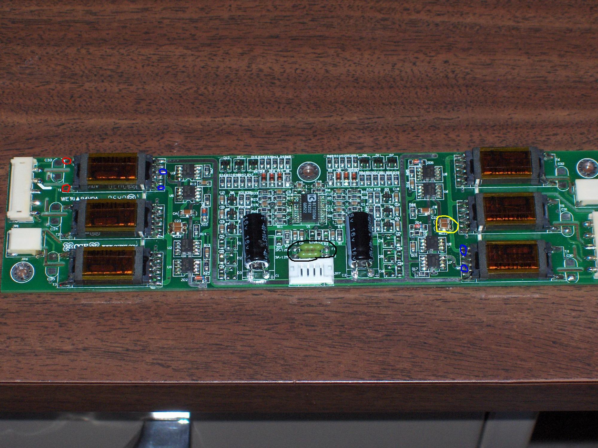

                              • PlainBill
                                • Feb 2009
                                • 7034
                                I've marked up the picture. Red circles are the output of one inverter transformer. Compare the resistance of the outputs of all six transformers.
                                Blue circles are the drive to the transformers. Compare right side to left side.
                                Black circle - pair of fuses. Check if they are good (very low resistance).
                                Yellow circle. Make sure both caps are soldered in place.
                                PlainBill
                                • starmaxpc
                                  • Oct 2009
                                  • 117
                                  Red circles are the output of one inverter transformer. Bad...
                                  Blue circles are the drive to the transformers. Good...
                                  Black circle - pair of fuses. Good...
                                  Yellow circle. Good ...
                                  PlainBill
                                  Hope this helps...
