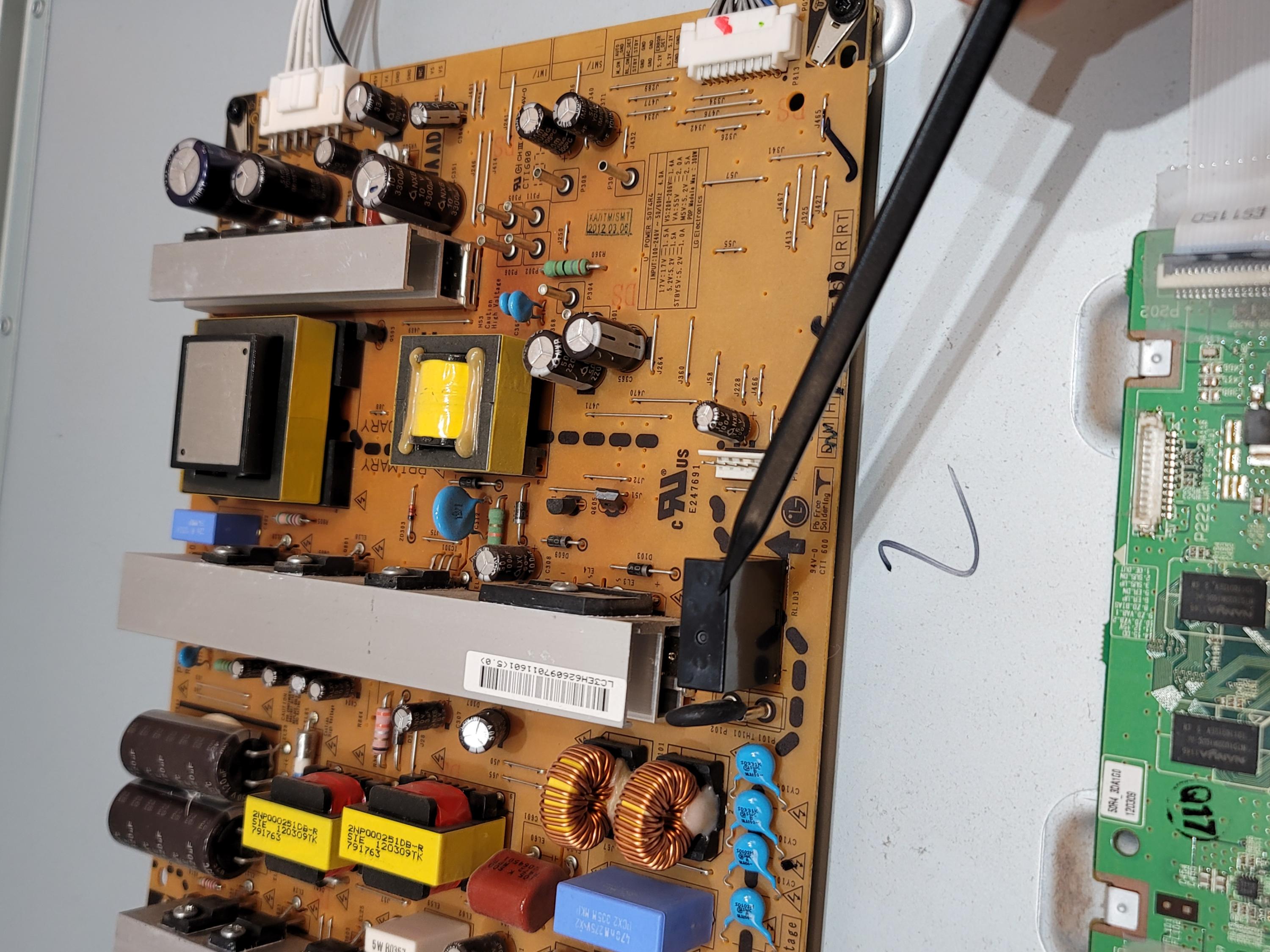

    This is the relay we replaced

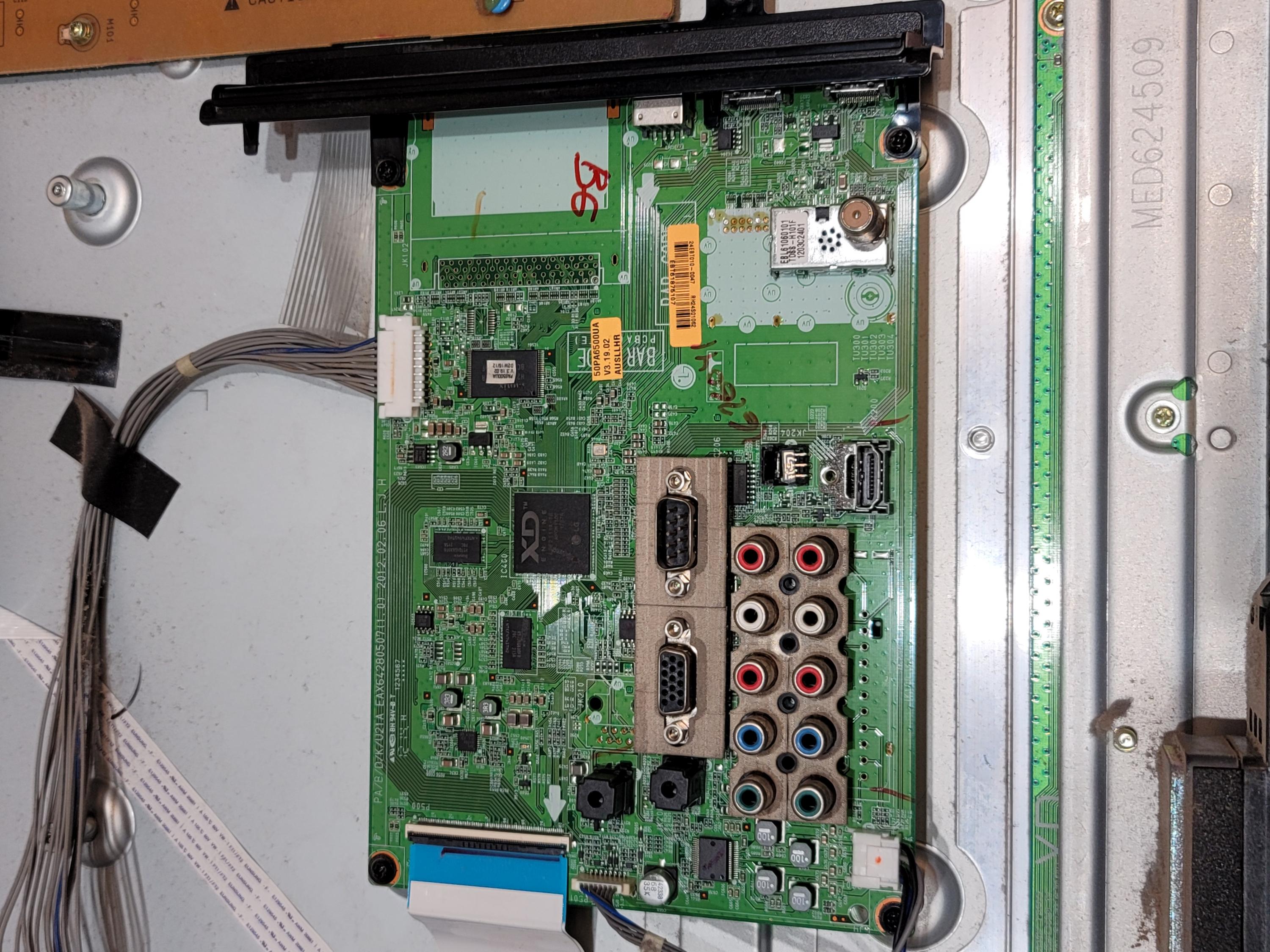

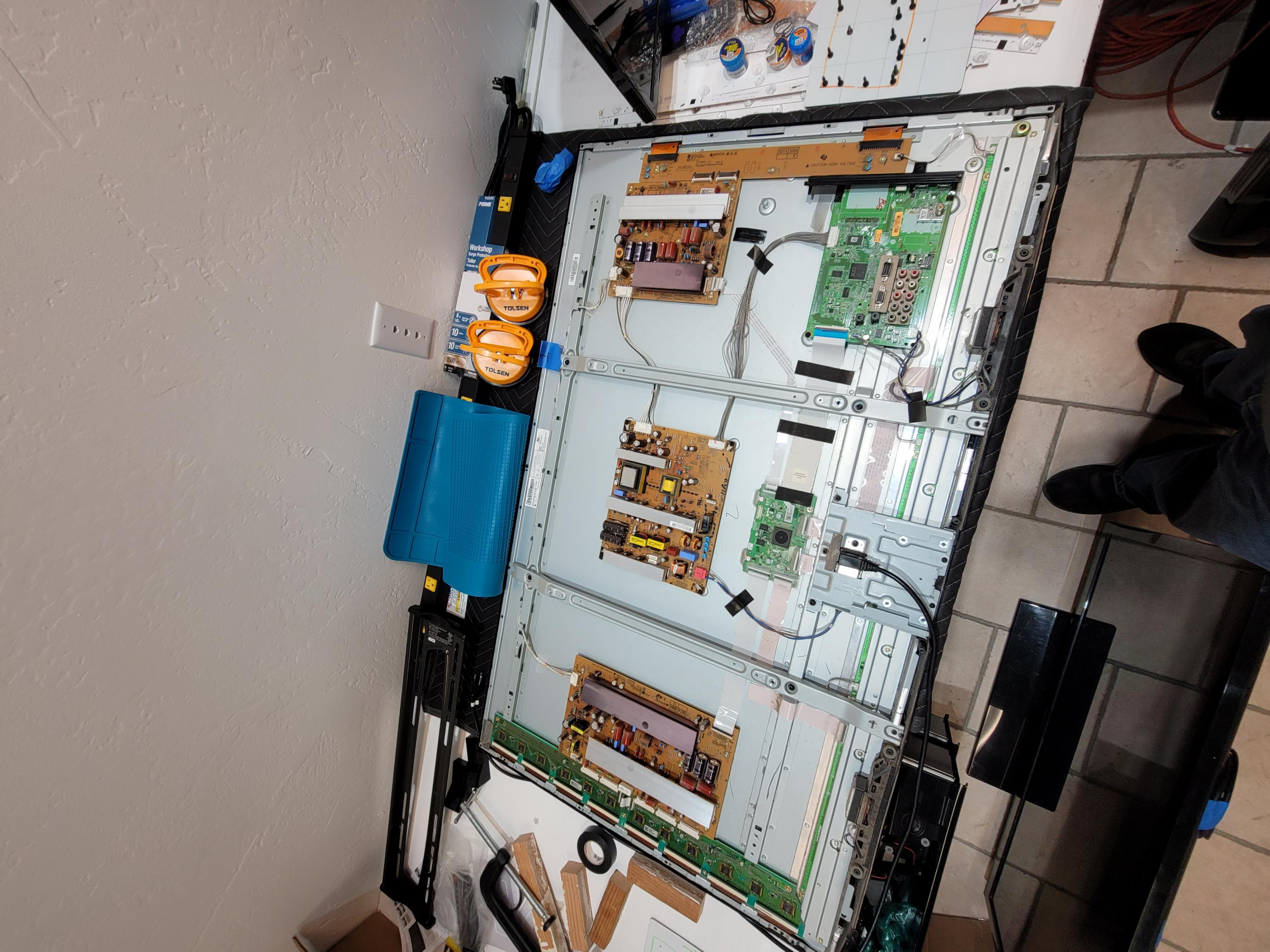

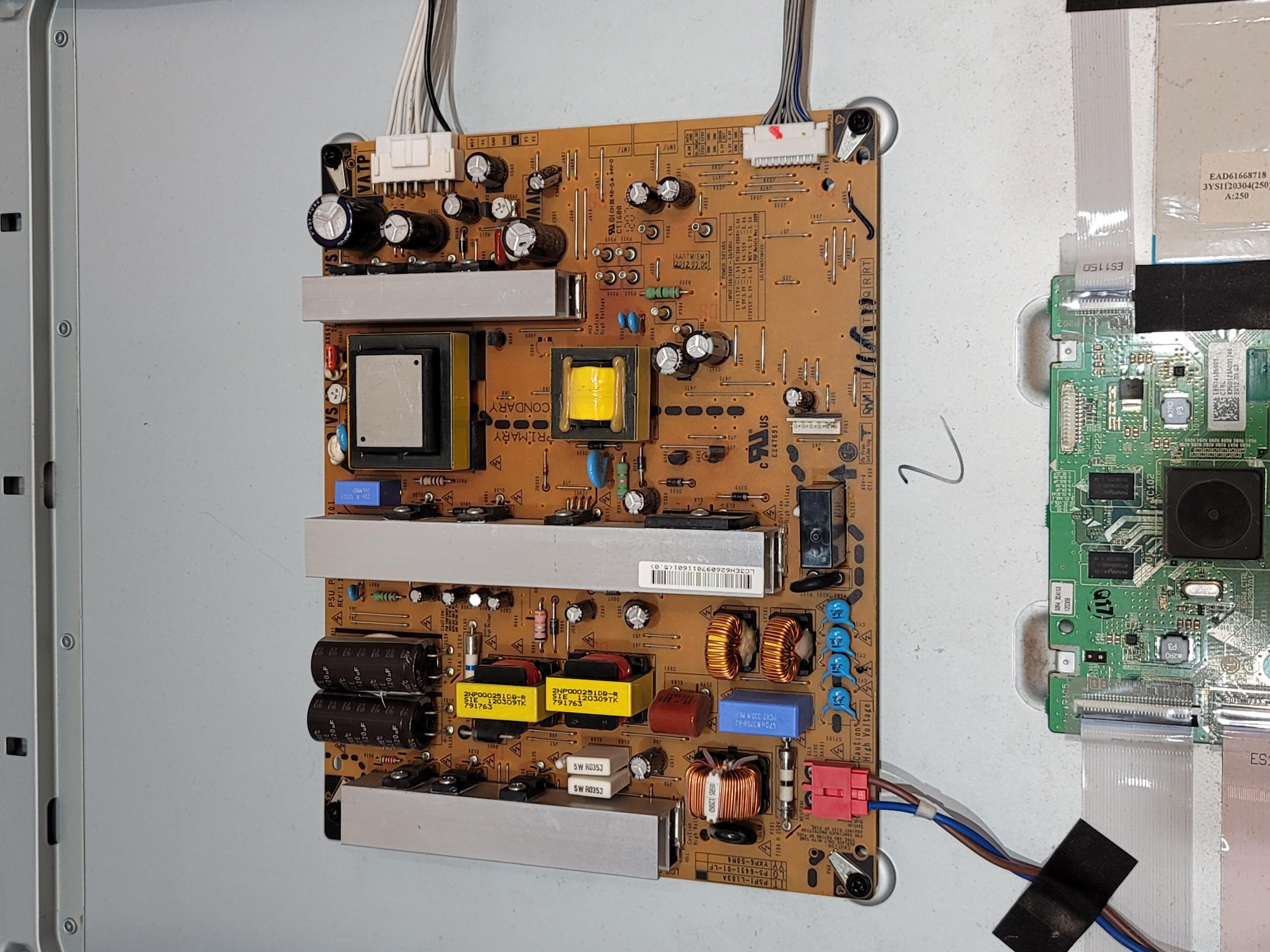

      here's a couple more pictures.

        the relay is doing whats its told . now you have to find why its behaving so . does the relay click once with main board removed ?

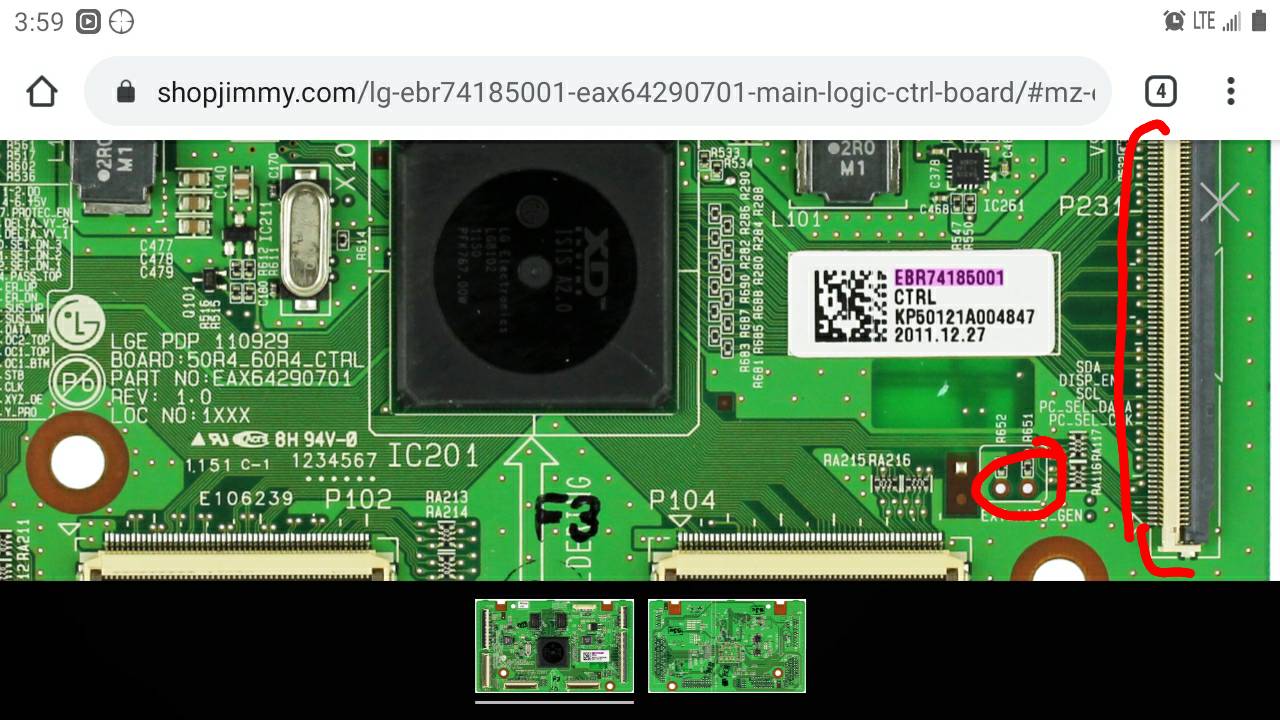

          Unplug the tv. Unplug the ldvs ribbon from the mainboard to the control board and put a piece of wire in the holes marked auto ext on the control board. Plug the tv back in and check if you have test patterns on the screen.

            a long shot replace the blue cap in the middle next to the large transformer
                We did the above test and got nothing. It wasn't until we unplugged the main board from the power supply with the rest of the test parameters that the test patterns started. Is it possible that the main board it telling the power supply to turn on and off repeatedly?
                  Re: Power board relay going insane!
                  If the tv stays on and goes through the test patterns the mainboard is bad (BGA chip).

                        Do post #6. They had a lot of bad blue caps at that location. fixed a few PA series with that problem back in 2015...
                        See https://www.badcaps.net/forum/showth...t=38197&page=3
