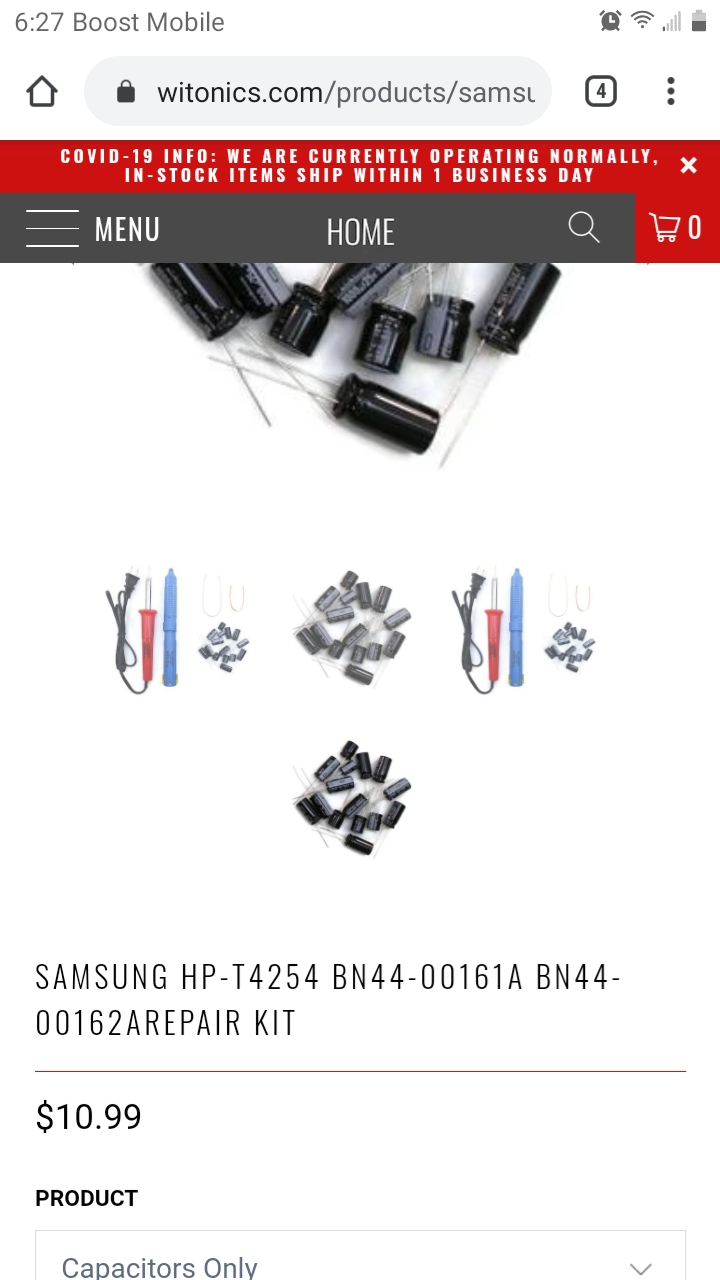

    Samsung HP-T5064 works fine for a few minutes
    Have a Samsung HP-T5064 plasma. Worked great for years. Now when I turn the set on it works fine for several minutes before shutting off and starting the clicking noise. Found one slightly swollen capacitor which I replaced as well as the cap next to it but it made no difference. Did not find any bad solder points. Does the fact that it runs fine for several minutes provide any clues as opposed to a set that won't power on at all? Does this mean some things like fuses could be ruled out? Thanks for any input!

    Re: Samsung HP-T5064 works fine for a few minutes
    There is a kit with several capacitors you need to replace.
      thank you very much for your response. i notice that the witonics site does not seem to have a repair kit for my model number. is the image you posted compatible with my model?
        If your power supply board is a BN44-00162A it is.
          Also, check/re-solder everything mounted to a heatsink. Look closely for other cracked solder joints.
            yes...BN44-00162A....
            thanks again that will keep my busy for a while....
