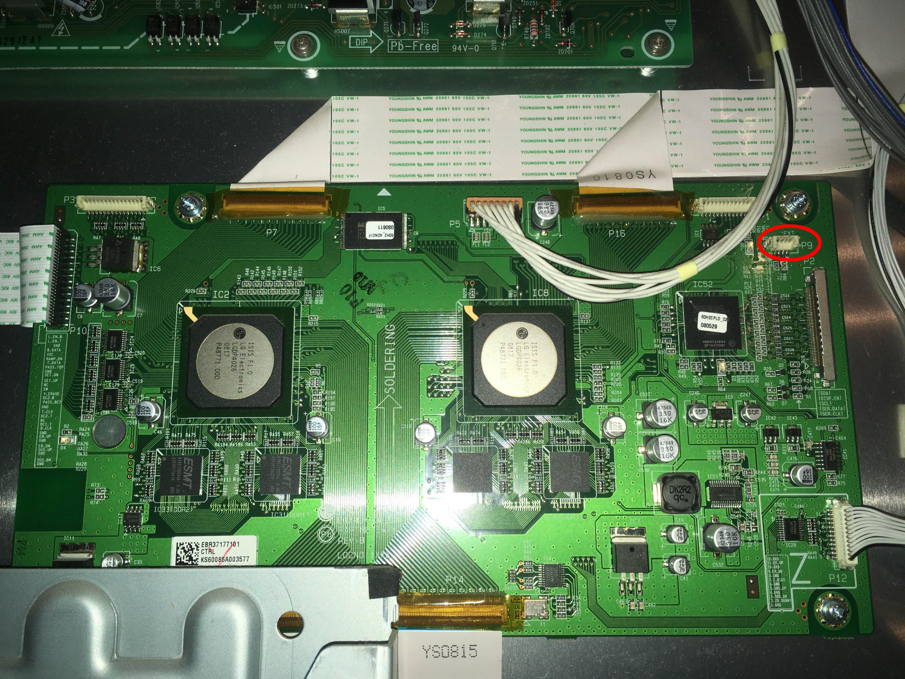

    I have a LG 60PG70FD Plasma TV and suddenly the image became noisy with pink grain. It is an intermittent problem, sometimes it goes back to normal and after a few seconds it becomes noisy again.
    I removed the ZSUS and YSUS boards. I tested for shorts and didn't find any. Removed some caps and tested ESR and capacitance, all OK.
    I resoldered all ZSUS DIP components(including the inductors coils).
    For the YSUS I resoldered all the inductors.
    Vs and Va voltages are correct.
    -Vy voltage is correct.
    Z bias voltage is correct.
    While trying to diagnose it, I found a way to activate the self test of this TV, as I searched everywhere and didn't find it. You just need to short pins 1 and 2 or 3 and 4 of the connector shown in this picture I took.
    In my TV, the self test have the same noisy picture.
    Do you have any tips of how to solve this issue?

    There's a possible page that could help
    https://www.badcaps.net/forum/showpo...3&postcount=58
    • nickba
      • Mar 2014
      • 5
      • australia
      Re: LG Plasma 60PG70FD image noise and Self test
      Thanks for replying. Unfortunatelly the suggested link didn't help. Any other tips?
