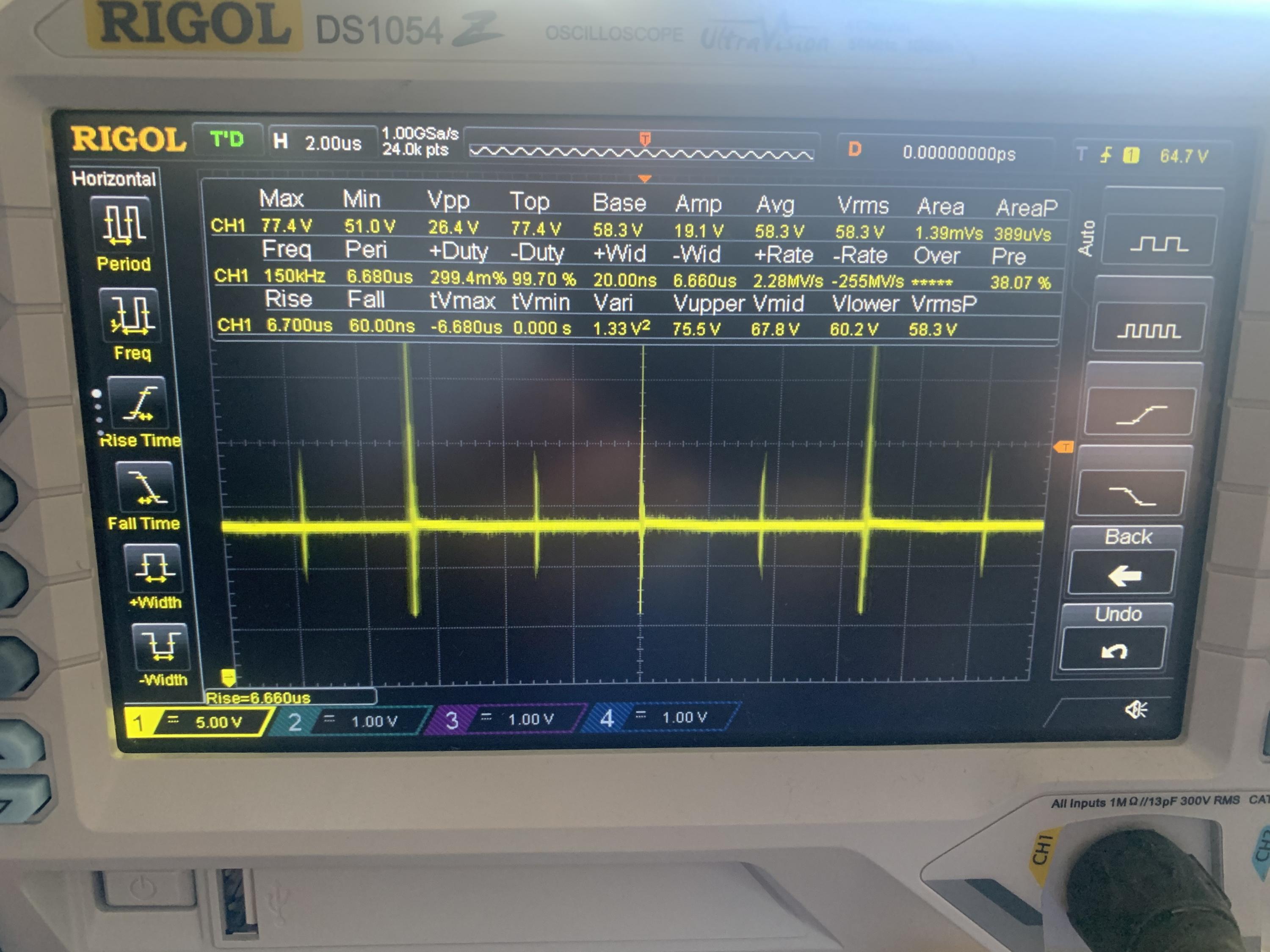

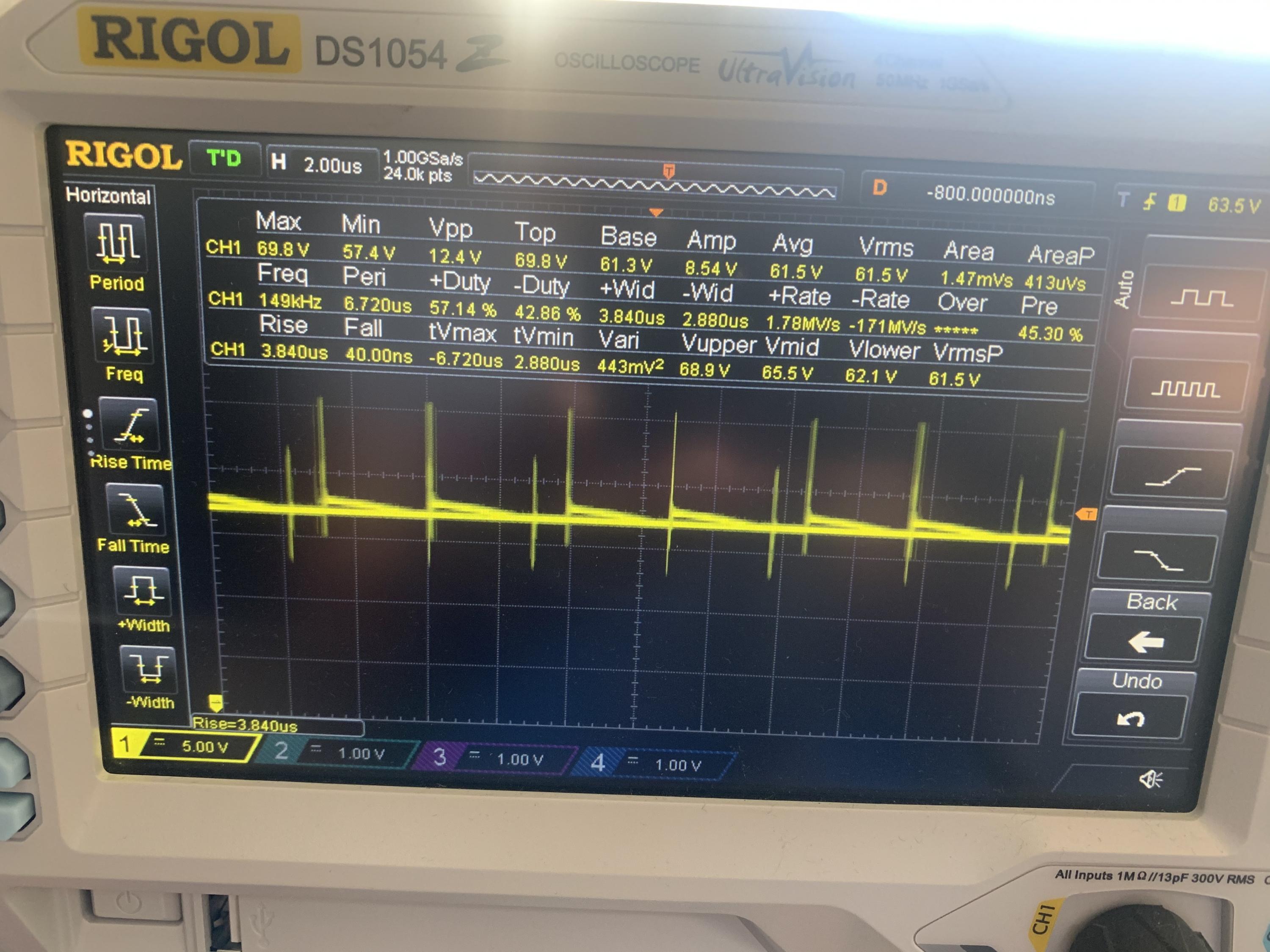

          Just an update.
          Replacement PSU arrived, much quieter.
          Tried swapping both transformers, diode on LED driver, various caps to no avail. I have DSO traces of both to compare, so there's something going on, see attachments. This trace is from the LED driver diode from both good and bad boards.
          Cheers,
          Matt
