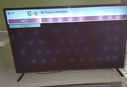

    LG 55UK6090PUA White Dots/Spots
    55UK6090PUA

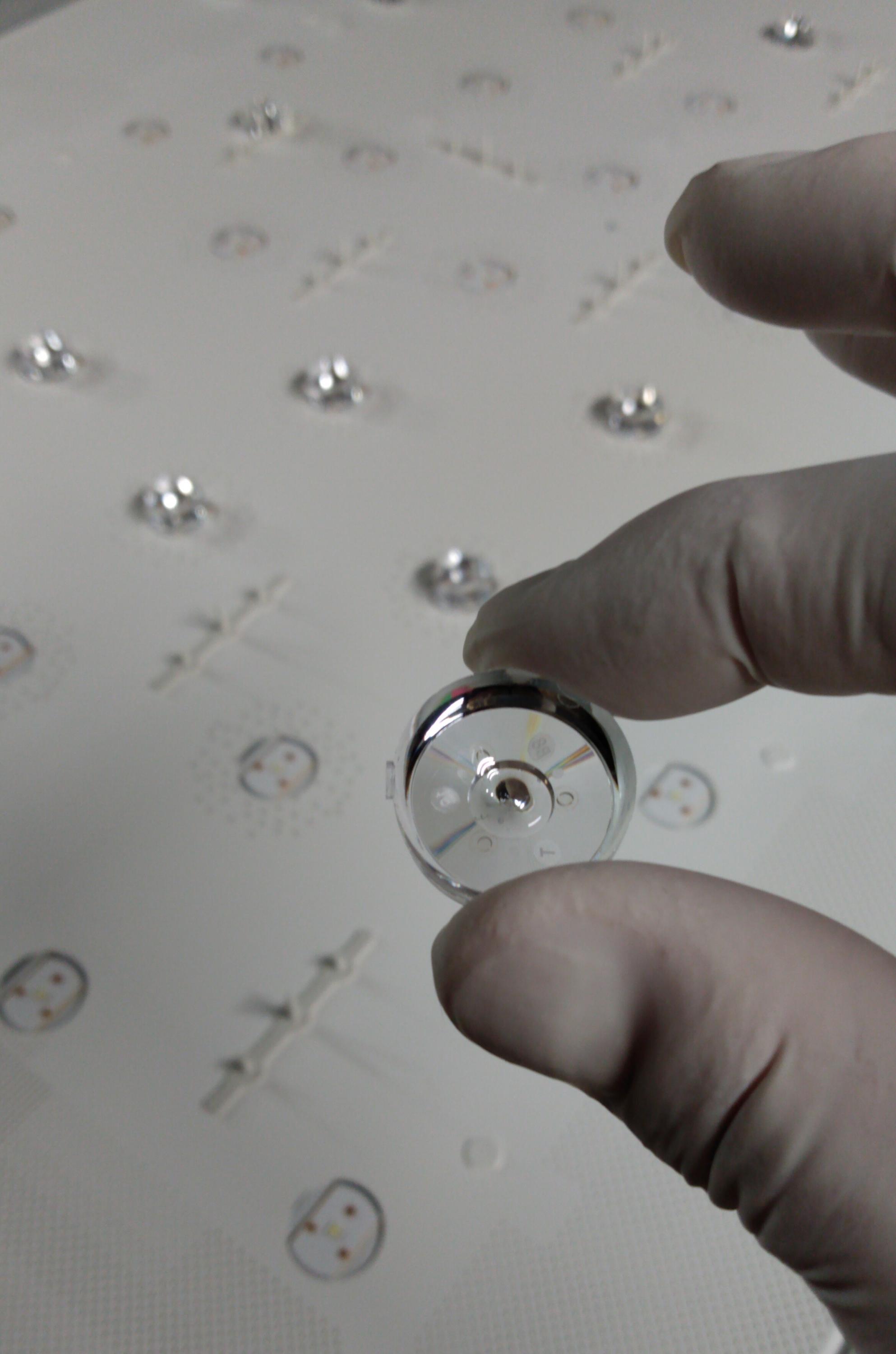

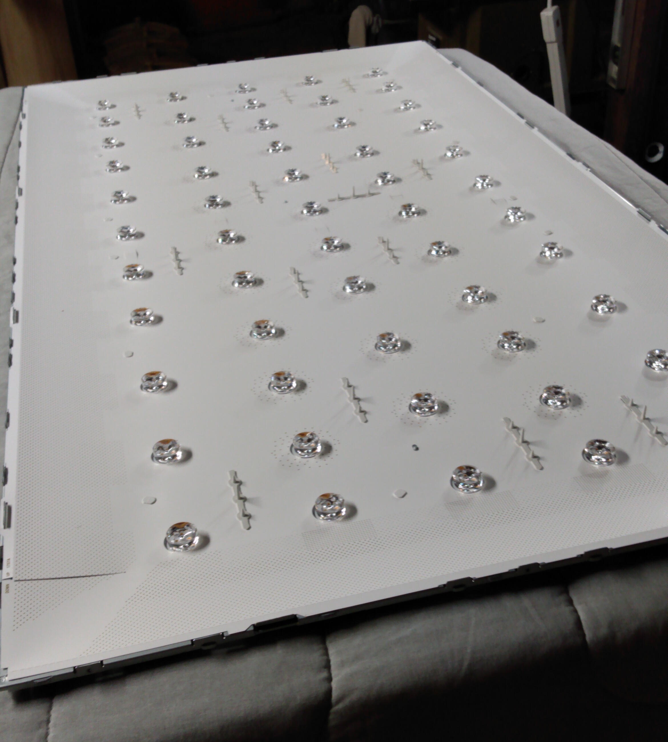

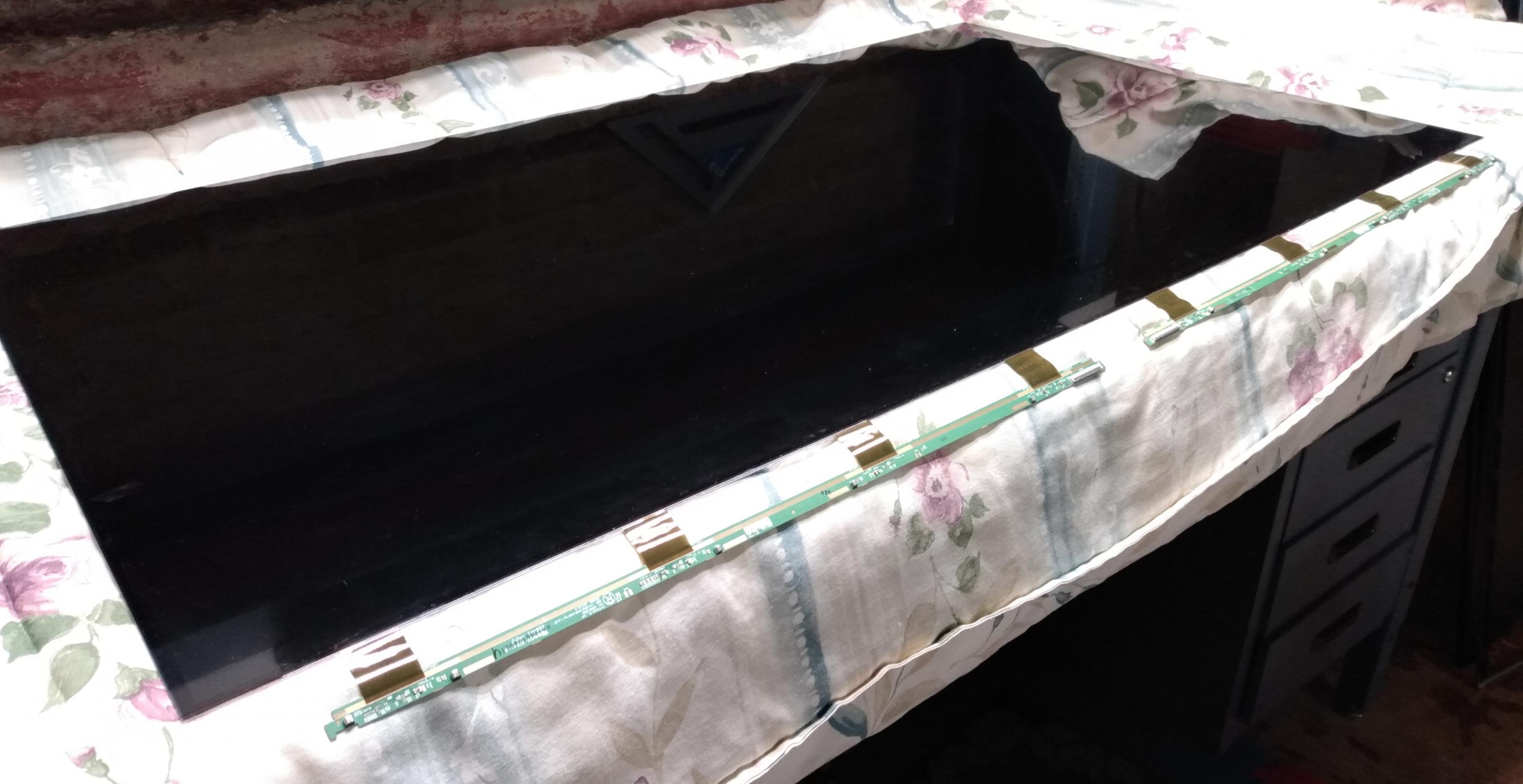

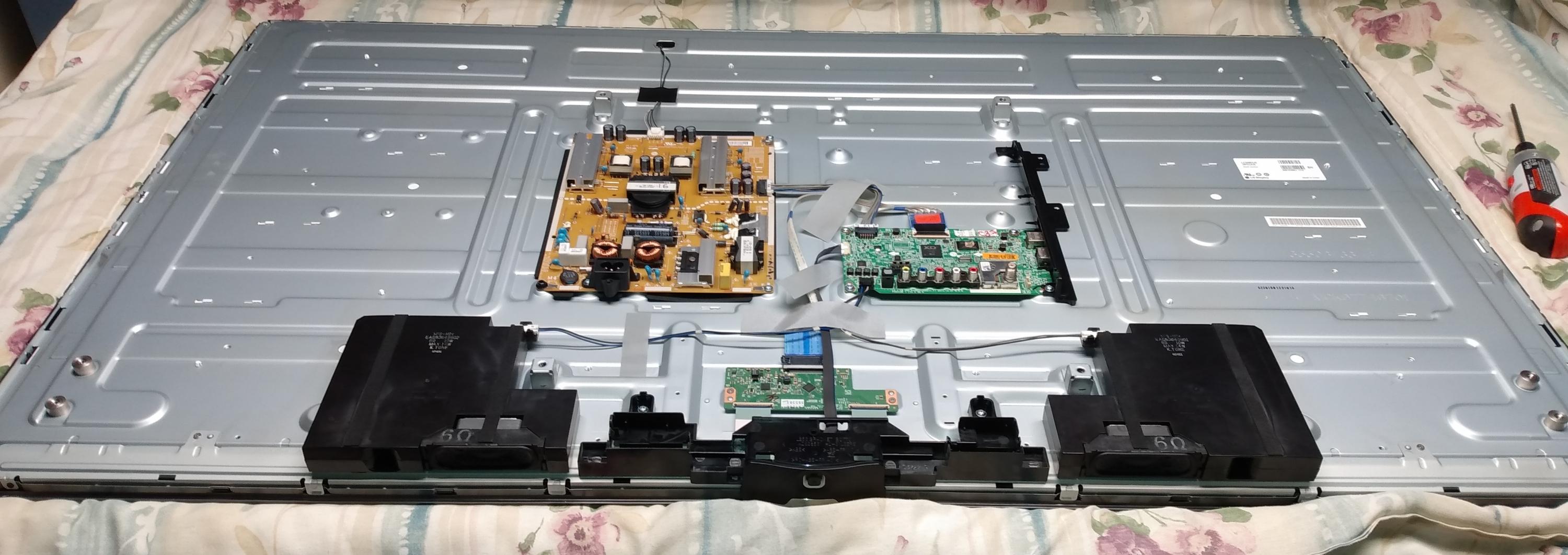

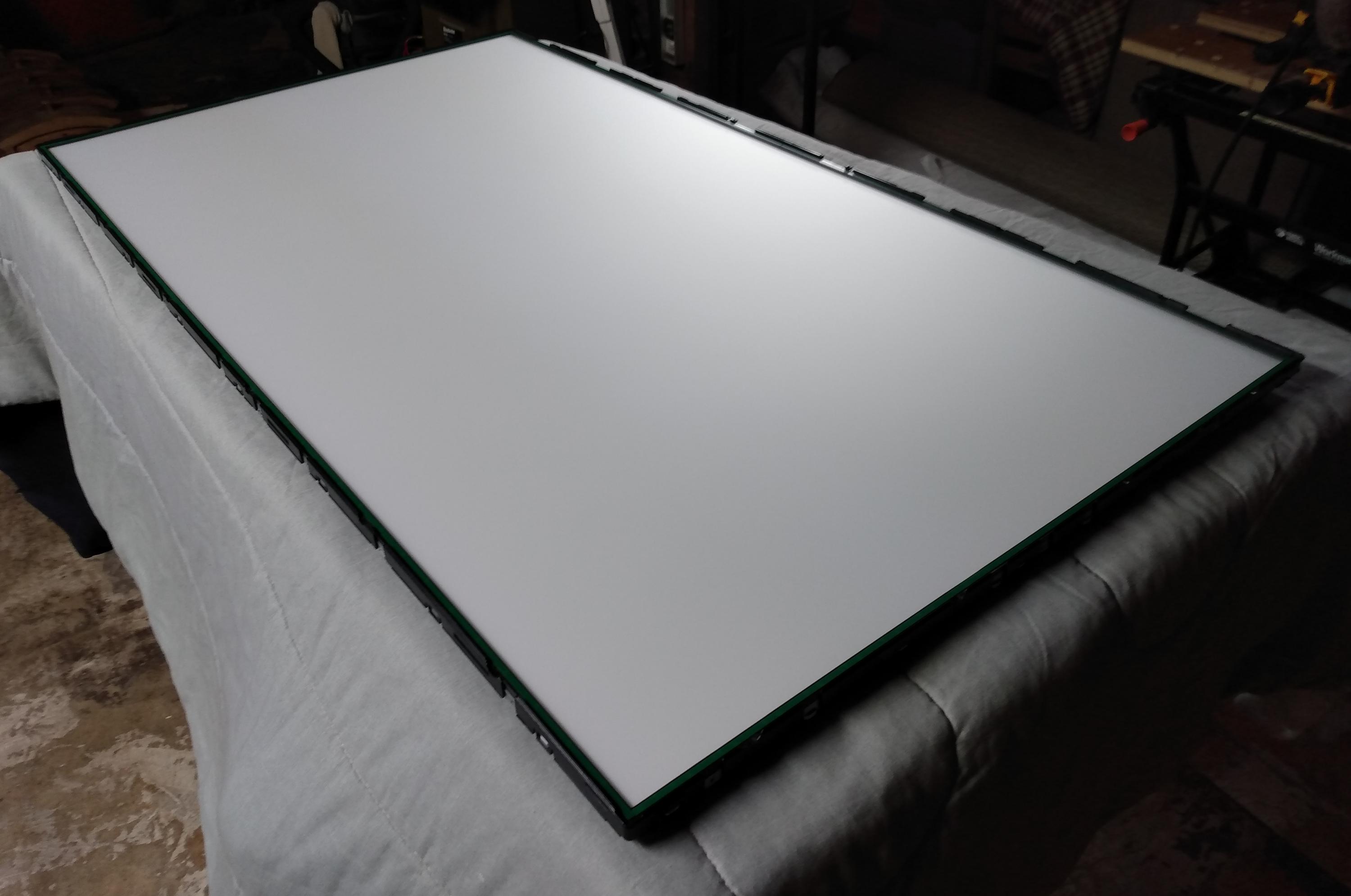

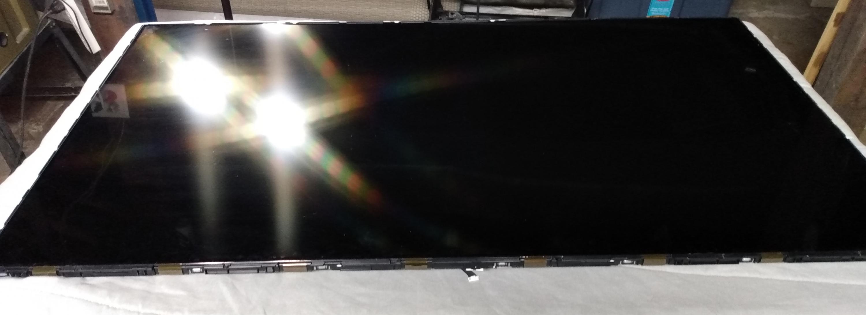

    Symptom: Many white Dots/Spots on screen

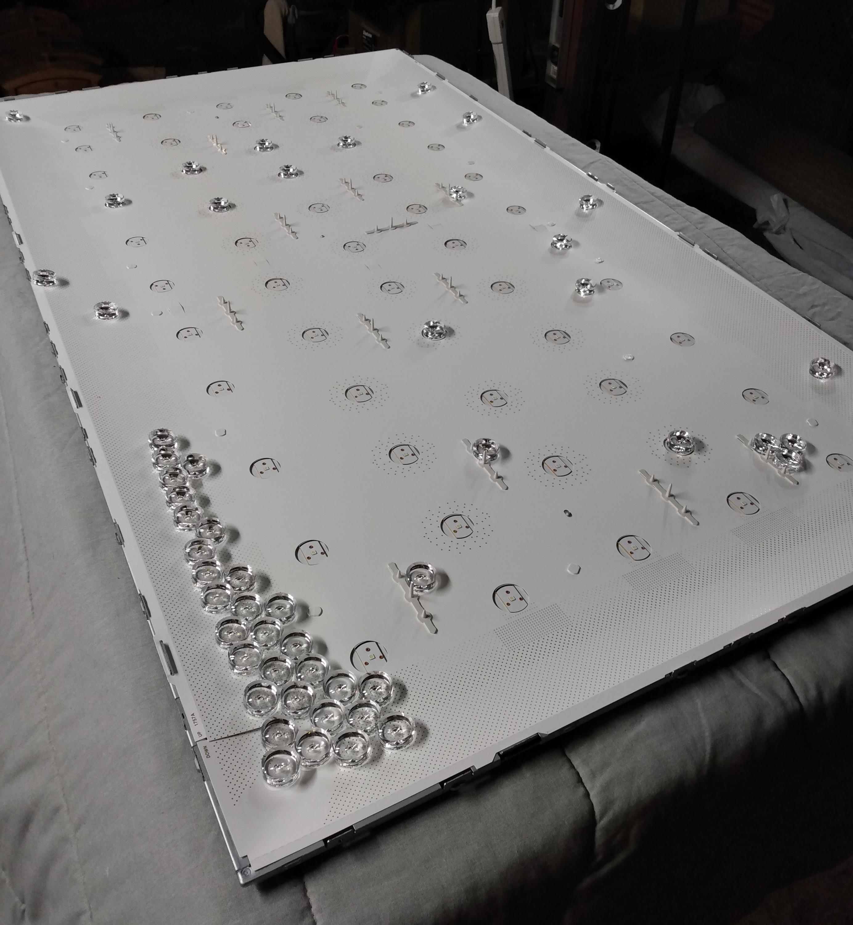

    Repair: re-glue LED strip diffusers.
    There are many videos on this but I thought I share my success story given that I am still upset about the last Samsung I have not been able to fix.
    Fairly common issue with LGs where the LED Strip diffusers pop off and shows up on the screen as a spot. Easy to fix if you are willing to open up the TV which is really not that difficult. Once opened, all the diffusers ( even the ones that were intact ) were glued back on with industrial glue.
    The TV has been Larry approved and going back to a happy home.
    Enjoy the pictures and hopes this helps someone out
