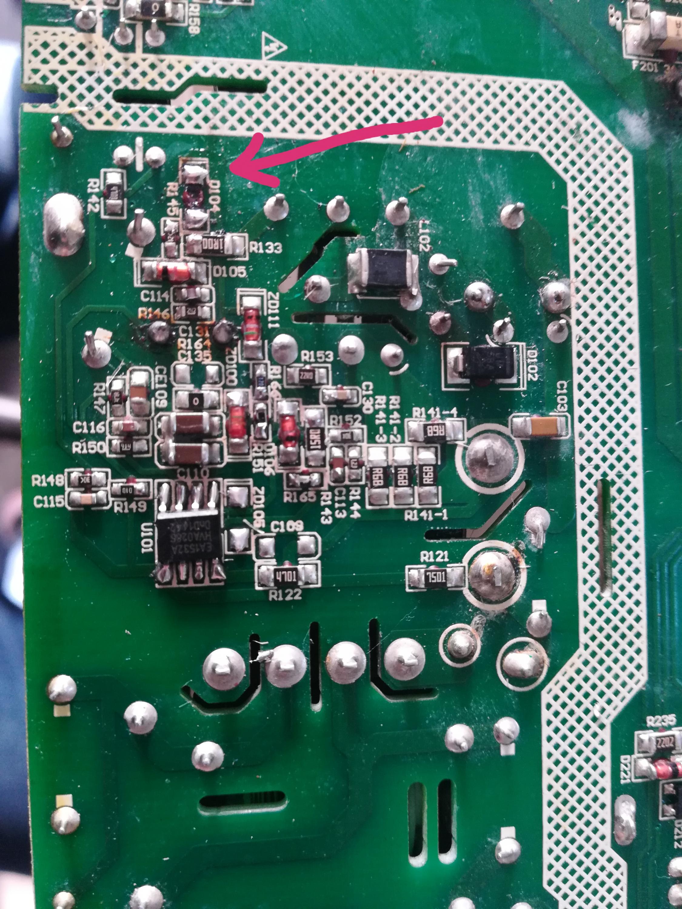

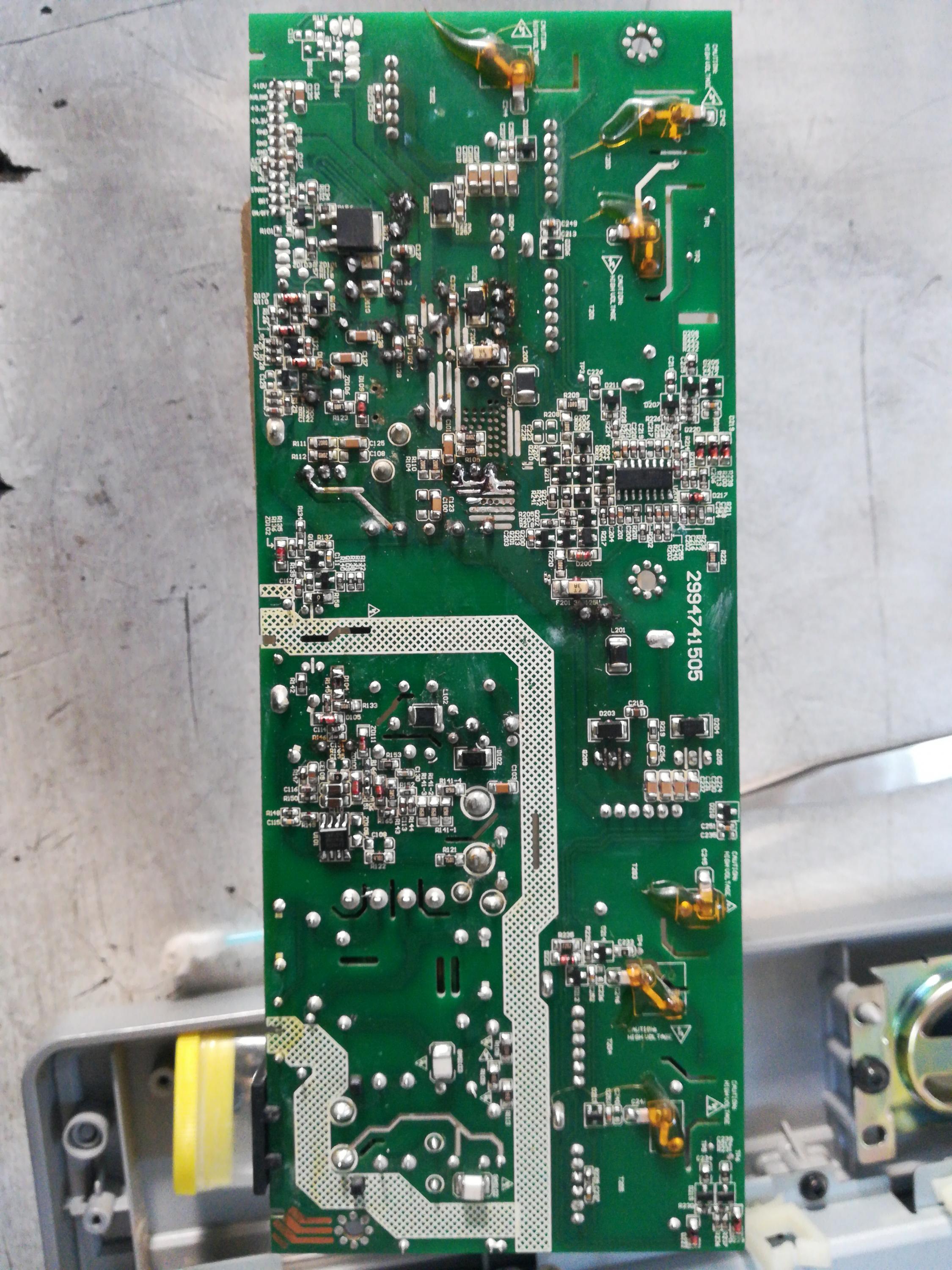

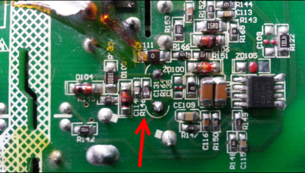

Hello guys and happy new year. I have problem with the dac-12m019. I need to know the component (D104) on the TEA1532A on the Hot side of the psu. I search for schematics and nothing found. Thanks

I looked at a different board and it looks like D104 is the same as D105 & D106
which are likely RLS4148NTE-11
I believe the small feedback winding on the transformer feeds R133 (1Ω) then to D104, that charges C131. So any fast recovery diode should workAttached Filesif you find these attachements useful please consider making a small donation to the site
